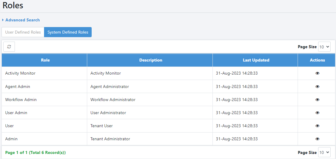

In the menu, navigate to Roles. The Roles page appears.
Click System Defined Roles tab. The list of roles appears.
- Click
. The selected role's permission details page appears. For example, if you select User, the permission page appears as follows:

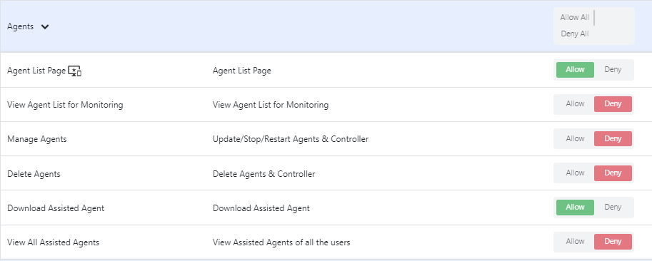

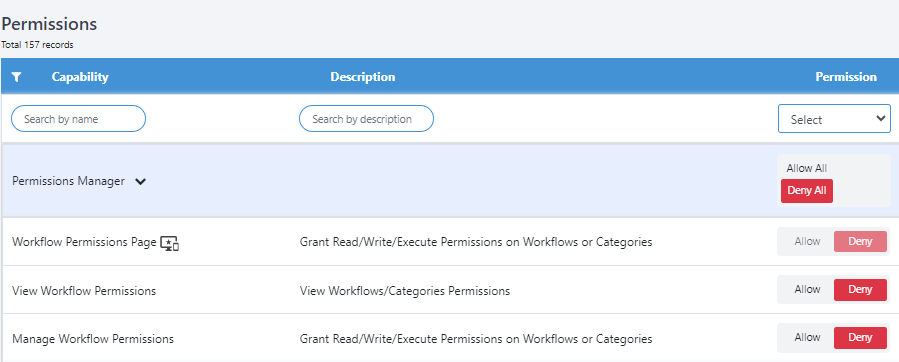

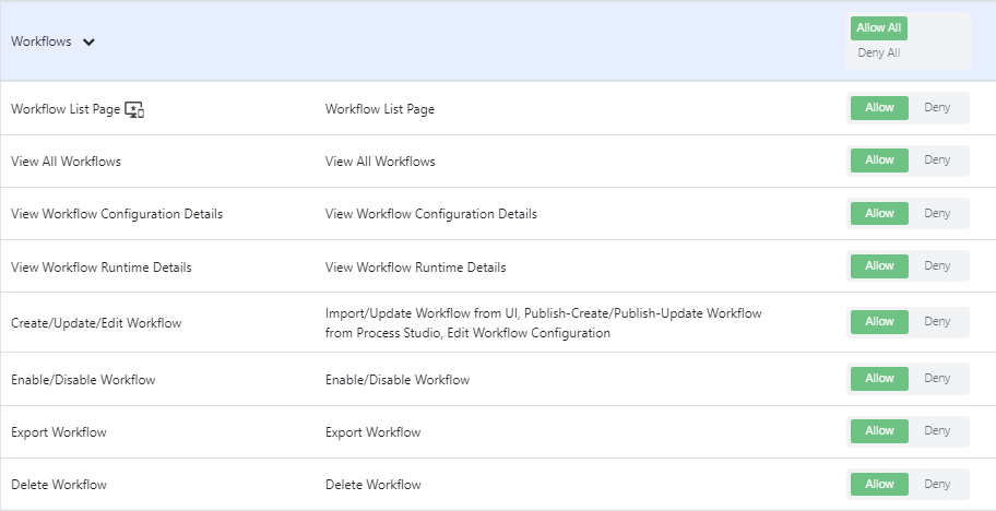

| Permission | Displays the permission granted for a capability or sub-capability assigned to the role. Permission values are: Allow or Deny. Note:To view the permission at capability or sub-capability level, click each capability: - If each sub-capability has either Allow or Deny, then at the Capability level the permission is seen as, Allowed All or Deny All. For example, ![]() - If the permission at sub-capability level is a mix of Allow and Deny, then neither Allow All or Deny All is selected at the Capability level. For example, ![]() |

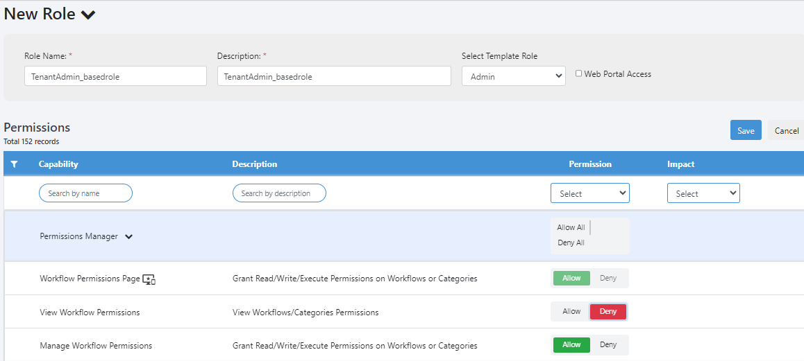

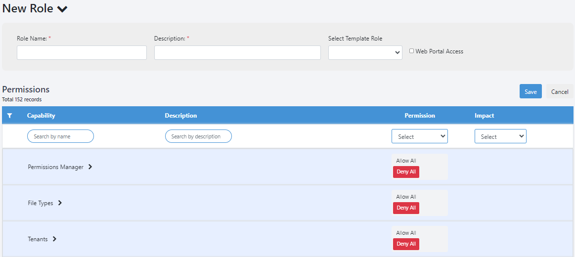

In the User Defined Roles tab, click New Role. The New Role page appears.
- Enter the following field details:
| Field Name | Description |
| Role Name | Enter a name for the role you want to create. |
| Description | Enter a description of the role. |
| Select Template Role | Select the role based on which you want to create the new role. Available options are: |
| - Admin | |
| - Activity Monitor | |
| - Agent Admin | |
| - User Admin | |
| - User | |
| - Workflow Admin | |
| Web Portal Access | Select the checkbox to allow users to sign in to AEUI with both, API and UI access. Note: If the checkbox is clear, then the user will have only API access to allowed modules and will be unable to access the UI pages. For example, see the followin screenshot: ![]() You will be unable to modify the permission of the Workflow Permissions Page, which is accessed through the UI However, you can modify permissions of other sub-capabilities that can be accessed through the API |
| Permissions | Note: If you select the system defined role for creating the new role, then by default all the system defined role's permissions are assigned to the new role. However, you can modify the permission details. |

| Permission | Displays the permission available for each capability. If you want to assign complete permissions to a capability, click Allow All. Else, click on the capability and provide permission at sub-capability level. ![]() Similarly, you can deny permission at the capability or sub-capability level. |
