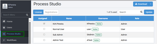

Assign License
Before an AutomationEdge user can register a Process Studio instance, the Admin must assign a Process Studio license to the user. The number of AE users assigned a license is dependent on the number of Process Studios allowed in the license.
The number of Process Studios allowed in the license determines the number of AE users for assigning licenses.
To assign a Process Studio license:
  1. In the menu, click Process Studio. The Process Studio page appears.
  2. In the License tab, click Update. The checkbox in the Assigned column becomes available for selection.
    license assign
  3. Click Save. The license is assigned to the selected users.

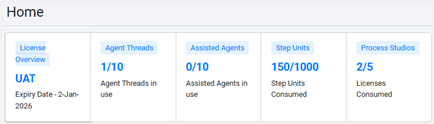

    You can see the number of licenses assigned or consumed on the Home page.

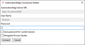

Users can register an instance of Process Studio by connecting to AutomationEdge; it is registered to AutomationEdge with AE username, Machine hostname and Machine username. The details of the registered instance are then visible in the list.
To register the Process Studio: Open the Process Studio instance and provide the AutomationEdge Server URL, Username, and Password. See the following screenshot as an example:

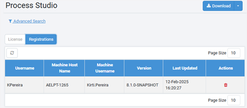

The newly registered Process Studio appears in the AE UI, Process Studio page.
register PS1

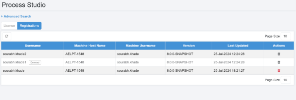

Delete registration from AutomationEdge UI
In the Actions column, click delete to delete a Process Studio registration, and then click Ok in the Confirm delete dialog. The Process Studio registration is deleted and removed from the list.
After deleting a registration from AE UI, the user must log in with the deleted Process Studio to release the license. The deleted license appears disabled on the Process Studio page with Deleted marked next to it.
PS
important
All the licenses for deleted PS registrations are released in the daily nightly job by the Server.
