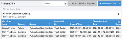

Reports can be created and viewed in a tabular or card or chart view. Choose dates or relative periods like hours, minutes, days, weeks or months, to generate reports. You can also edit dashboards to get the options to edit reports.
Note: Chart view is available in certain reports only. For example, Agent-wise Workflow Average Execution Time.
The reports can help you monitor your automation performance in several aspects.
Following are the steps to create a New Report,
  1. In the menu pane, click Reports. The default dashboard view appears.
  2. Select a dashboard from the dashboard name list. For example, Productivity.

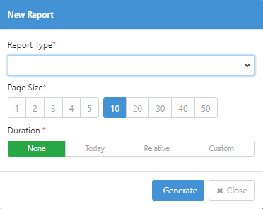

  3. Click the dropdown icon next to New Dashboard, and then click Add Report. The New Report dialog appears.
Note: The Duration field is available only if the Use Dashboard Level Duration for Reports checkbox in the New Dashboard dialog is clear.
FieldsDescription
Report TypeSelect the type of report you want to generate.
See Out of the box reports for a description about the reports.
Generate OnSelect the radio button next to Workflow or Categories.
Note: Depending on the option selected, the Select Workflows or Select Categories field is available.
Select Workflows / CategoriesSelect the workflows or categories for which you want to generate the report.
Select AgentsSelect the agents for which you want to generate the report.
Note: Select the agents only if you want to generate reports, such as Top Agents with error or Success Rate-Agent. Else, the selection will be ignored.
Page SizeClick the page size tab, as required.
Duration*Click any of the following tabs to specify the duration: None or Today or Relative or Custom.
- If the Use Dashboard Level Duration for reports is selected, then the report inherits the duration details from the dashboard.
- Duration type description is same as
provided in the New Dashboard section.

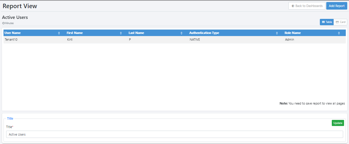

  1. Click Generate. The Report View page appears.
Figure 14.2: Report View
The following tabs are available in the Reports View: Table: Tabular format is the default view. You can sort the report in an ascending or descending order. In the Title field, modify the report name, and then click Update. Card: The report appears as a card displaying details of the first record. Chart: The report appears as chart, such as Bar chart, Pie chart, and so on.
In the Configure Card section, modify the following field details, and then click Update Card:
  • Title: Modify the name of the report.
  • Subtitle: Enter a sub title for the report, if required.
  • Select Value Column: Select the column whose value you want to show in the card.
  • Add Text Before/After Value: Select the checkbox to add text before or after the displayed value.
  1. Click Add Report. The report is added to the dashboard.
    Click Back to Dashboard to discard the report.

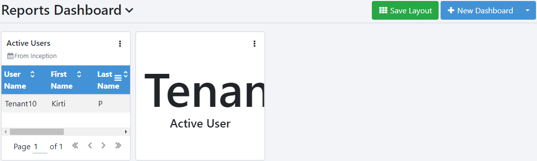

  1. Click Save Layout, to save the look and feel of the dashboard.
You can save the layout each time you resize or reposition the reports on the dashboard.

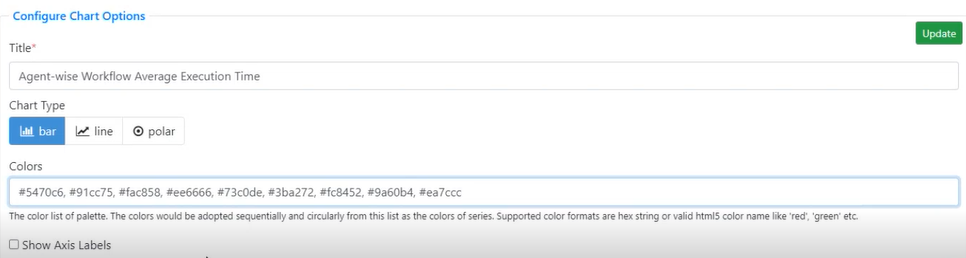

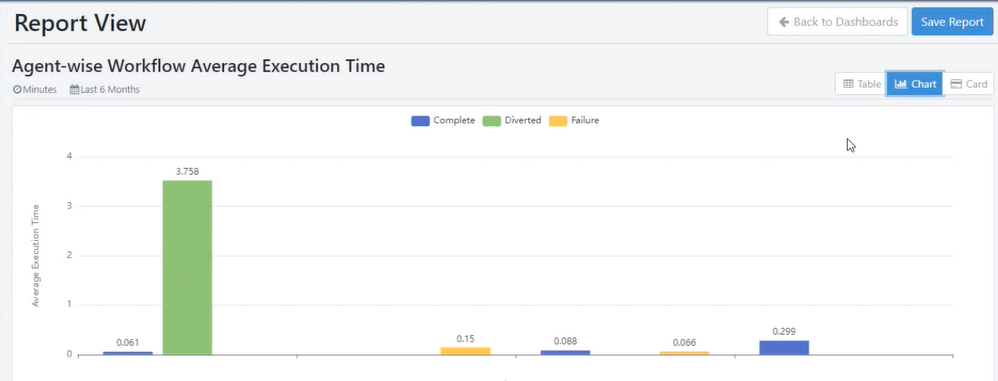

To generate reports with Chart view:
  1. In the Add Report dialog, select the report, which provides the Chart view option.\
  2. Click Chart tab. The chart view appears.\
  1. In the Configure Chart Options section, set the following:\
FieldDescription
Title*Enter the title of the report.
Chart TypeClick respective tab to generate the report
view:
- Bar: Data is represented with bars.
- Doughnut: Data is represented in a circular format with different colors.
- Gauge: Displays the partial progress towards a specific value. The value is
derived from the first row result of the report query.
- Line: Graph uses lines to connect individual data points.
- Pie: Data is represented in a pie format with different colors.
- Polar: The following image represents the polar view.
- Step line: Data is represented in step line chart format.\
Note: The report view is applicable for Agent Utilization Report.
ColorsEnter the color codes with which you want to represent the data in the chart view.
Note: You can enter multiple color codes in the hex string or valid html5 color names.
Show Axis LabelsSelect the checkbox if you want labels to appear on the X-axis.
The following fields are available only if you select Gauge chart type:
Minimum ValueEnter the minimum value from which the calibration will start.
For example, 0
Maximum ValueEnter the maximum value where the calibration will end. For example, 40.
Start AngleEnter the angle at which the minimum value will be viewed.
End AngleEnter the angle at which the maximum value will be viewed.
Use Color CodesSelect the checkbox to use the predefined color codes from the custom report template.
Note: Configure the color codes as type String in the Report column of the custom report template. The color codes must be entered in decimal format in the range 0 to 1.0.
  1. Click Update. The settings are applied to the view.
  2. Click Save Report. The report appears on the dashboard.

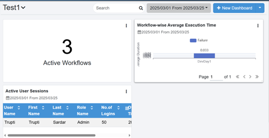

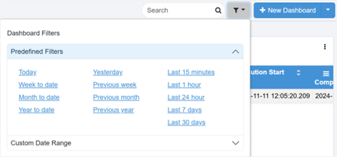

Apply dashboard filter
Fetch data for a specific duration on the dashboard by using the filter option. The Dashboard Filter allows users to apply live filter. The option is available only when a dashboard-level duration is selected. Once a specific time-period is selected at the dashboard level, the filter icon becomes visible, allowing users to access and download the filtered data in PDF or CSV format. If you apply filters on the dashboard, the filters will be applied to all reports displayed within the dashboard. Applying filters at the dashboard level ensures consistency and relevance of the data presented across all reports. This is a temporary filter, if you change tab the filter . You can reset the filter for current session.
alt text
• The selected filters are temporary and cannot be saved to the dashboard. • You can download the generated report.
Predefined Filters
alt text
To apply a specific time frame to your dashboard, select a filter from the available options. For example: • Today: Displays report for the current day. • Yesterday: Displays report for the previous day. • Last 15 Minutes: Displays report for the past 15 minutes and so on.
alt text
Custom date range
Apply custom date range to the dashboard, as required. To apply a custom time to your dashboard:
  1. Click Custom Date Range, the date range fields appear. Select the following field details:
alt text
  • Select Start Date: Select the date from which you want to fetch the data for the report.
  • Select End Date: Select the date up to which you want include the data in the report.
  1. Click Apply. The report for specified date is generated.
alt text

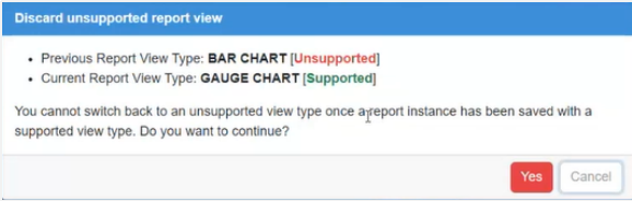

Important: From release version 8.0.0, there are changes in the supported Chart report view type. When you migrate the reports from previous AE version to the current version, then the report will appear as you had generated previously. However, if you update the report view type, then you are asked for confirmation before proceeding with the update. See the following screenshot:

xxx. Workflow Execution Summary--It is a report of all execution details of the workflows.

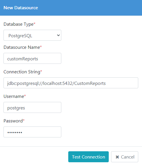

AutomationEdge needs to connect to an external database to fetch data for Custom Reports. The Datasources sub-menu provides options to Add, Update or Delete Datasources.
New Datasource
To create a new data source,
  1. Navigate to the Reports menu and the Datasources sub-menu.
  2. Click the New Datasource button
Figure 14.5: Create New Datasource
  1. Provide details as shown in the image below and described in the table underneath the Datasource Type. Click Create. Test Connection successful message is displayed.
Figure 14.6: Create New Datasource
The following table describes the fields for Datasource creation.
Table 14.2: Datasource fields
FieldDescription
NameProvide a name for the Datasource
Connection StringProvide a jdbc connection string to the database (e.g. jdbc:postgresql://localhost:5432/CustomReports, assuming you have the database on the same machine as the AutomationEdge server, else replace with the ip address).
UsernameProvide database username
PasswordProvide password
Datasource TypeSelect a Datasource Type from the dropdown list.

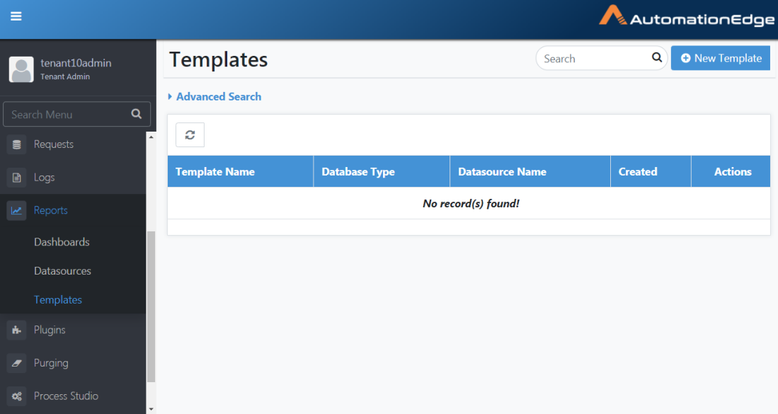

  1. Click on the Reports menu and Template sub-menu. Click New Template.
Figure 14.10: Template Menu

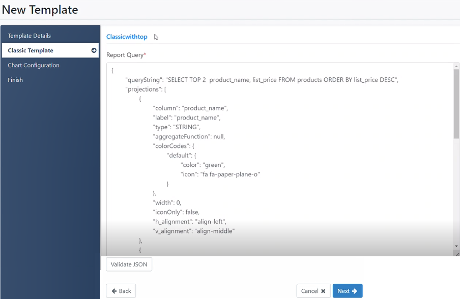

  1. After filling the details, click JSON Based (Classic) under Select Approach to Create Template. In the Classic Template page, the report placeholder template query is generated.
Note: As the generated template query is a placeholder and not a working JSON query, you must modify the query to achieve the required result.
Figure 14.12: JSON Based (Classic) report query
  1. Click Validate JSON. The validation is successful message appears.
  2. Click Next. The Chart Configuration page appears.

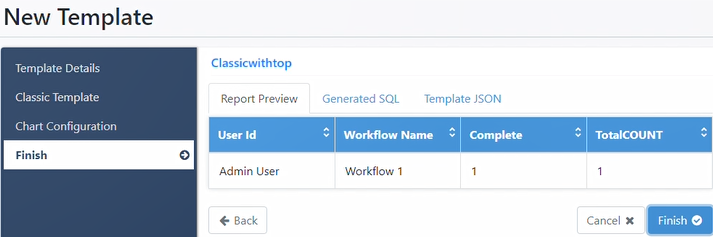

  1. On the Finish page, click each of the following tabs:
  • Report Preview: Displays the preview of the report based on the columns called in the SQL query.
  • Generate SQL: Displays the generated SQL query for a template.
  • Template JSON: Displays the complete report template JSON preview.
  1. Click Finish. The template appears in the Template page.

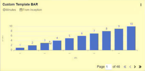

The template appears in the Dashboard, which you can use to generate reports.
Figure 14.16: Report on the Dashboard

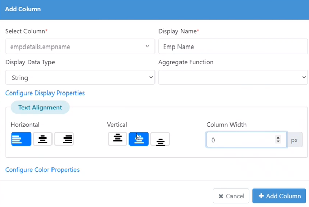

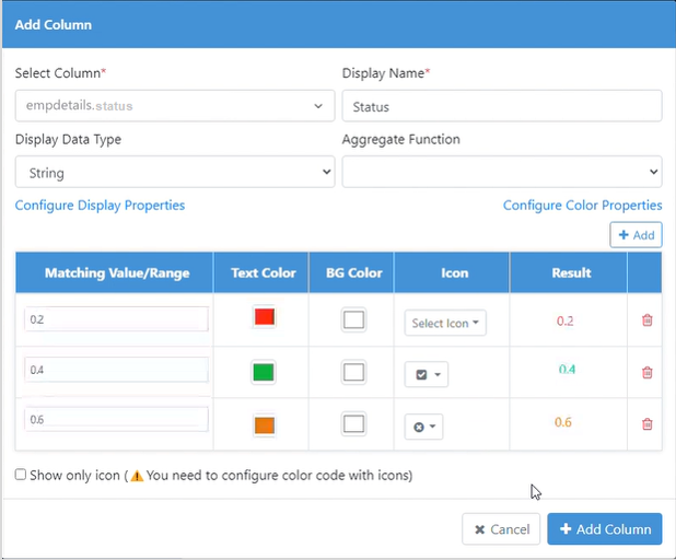

If the SQL Query's select statement contains '*', that is, all columns, then you need to add the projection columns manually using Add New in the Report Columns page.
Figure 14.20: Add Column dialog
  • Enter the following details:
    • Select Column: Select the name of the column, as called out in the SQL query.
    • Display Name: Enter the column name, as you want it to appear in the report.
    • Display Data Type: Select the data type of the selected column.
    • Aggregate Function: Select the aggregate function used for the selected column. For example, COUNT, AVERAGE, and so on.
  • Click Configure Display Properties, to set the horizontal and vertical text alignment and the width of the columns, as you want to appear in the report.
Figure 14.21: Add Column dialog: Configure Display Properties
  • Click Configure Color Properties, to set the colors for values of columns, as required.
Figure 14.22: Add Column dialog: Configure Color Properties
  • Click Add. A new row appears.
    • Matching Value/Range: Enter the name of the value or range that when matched will change the color of the text in the report.
    • Text Color: Select the text color of your choice.
    • BG Color: Select the background color, if required.
    • Icon: Select the icon that you want to assign with the text.
    • Result: Displays the text and the icon associated with the text.
  • Click Add Column. The column appears in the Report Columns page.

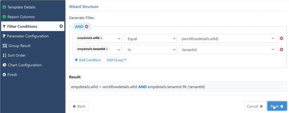

Wizard Based Structured Query template
  2. The New Template wizard appears. Enter the details in the Template Details page.
Figure 14.24: Template Details page

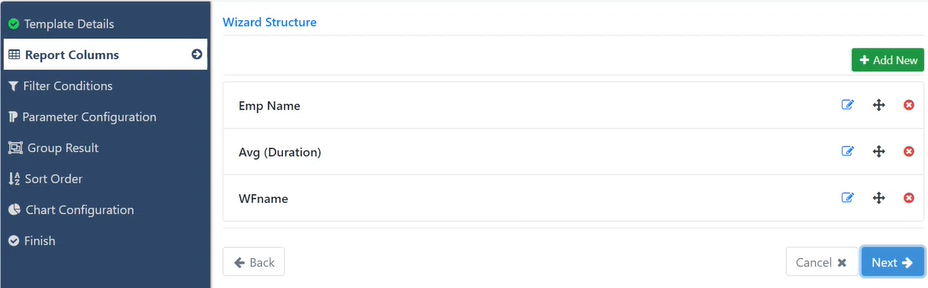

  1. In the Report Columns page, you can perform the following tasks, if required:
    a. Click Add New, to add new columns.
    b. Click Edit, to modify the column details.
    c. Click Move, to sort the columns on the page.
    d. Click Remove, to delete the column.
NOTE: For details about the tasks, see Flat Query template using SQL Based approach.
  1. Click Next. The Filter Conditions page appears.
Figure 14.26: Filter Conditions page
  1. In the Filter Conditions page:
    a. Click Add Group. From the list, select the grouping option, AND or OR.
    b. Click Add Condition, and select the filter condition, the comparator, and the mapped column. The filter conditions are captured in the Result field.

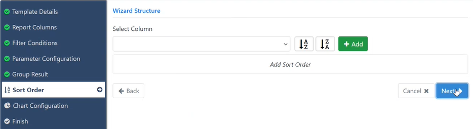

  1. Click Next. The Sort Order page appears.
Figure 14.29: Sort Order page
  1. Select a column by which you want to sort the data, and then click either, A-Z or Z-A for ascending or descending sorting order, respectively.
  2. Click Add to add the selected column to the sort order list.

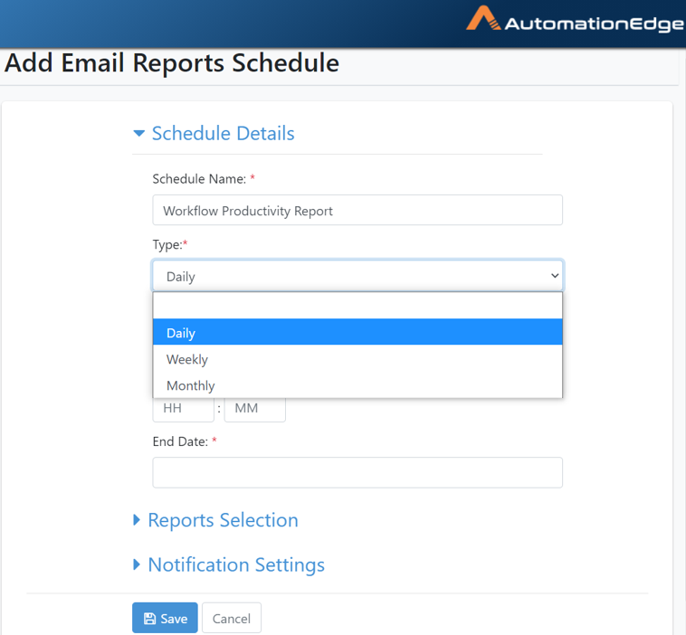

  1. Provide a Schedule name and choose a Schedule Type from the drop-down list.
Figure 14.32: Schedule Type

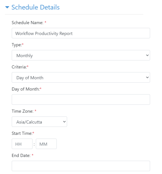

  1. If the Type chosen is Monthly for sending the reports by email, specify the Criteria, a Start time (HH:MM format) and an End Date.
Figure 14.35:Monthly Schedule Configuration

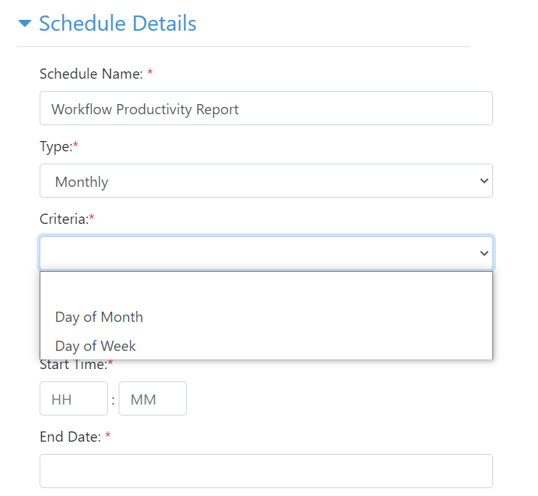

  1. Choose a Criteria from the below -- Day of Month or Day of Week.
Figure 14.36: Select Monthly Schedule Criteria
  1. For Day of Month, provide a Day of Month by scrolling the scroll bar in the field to increment or decrement the values.
Figure 14.37: Select Day of the Month

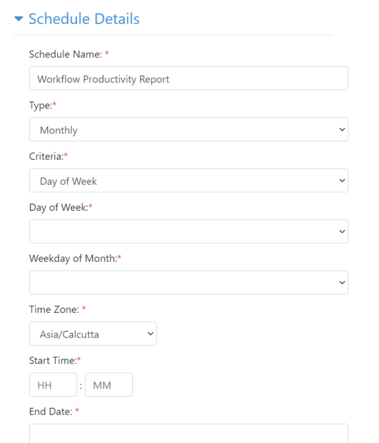

  1. If Day of Week is chosen in criteria, provide Day of Week and Weekday of Month. Day of the week can be Sunday-Saturday, and Weekday of Month can be First, Second, Third, Fourth or Last. (e.g.
  • Every last Friday of the Month at 7 PM, or
  • every First Monday at 8 AM, or
  • on every 4^th^ day of the Month at 7 AM or
  • last day of the Month at 9 PM)
Figure 14.38:Select Day of the Week

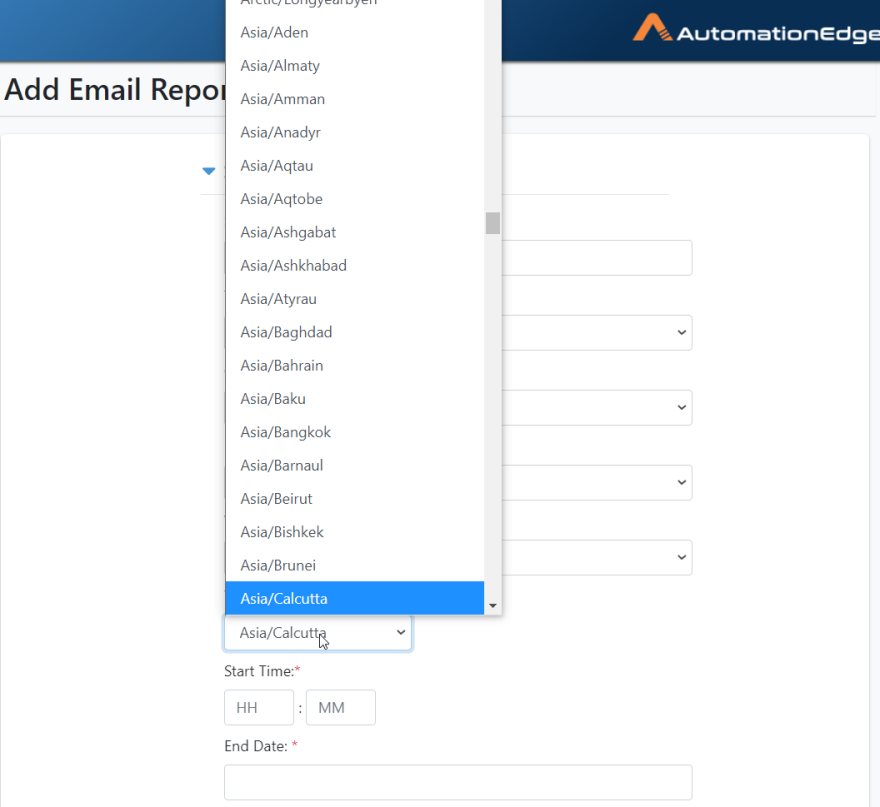

  1. The user's (browser) time zone populates by default. Users can change the time zone if needed.
  2. Select a Time Zone from the list. AutomationEdge server will generate and email the report at the local time according to the time zone specified.
Figure 14.39: Select Time Zone

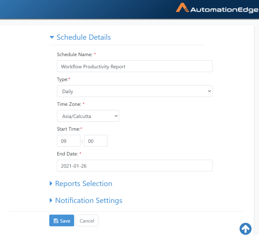

  1. Create a Daily Email Reports Schedule with Schedule details as below.
Figure 14.40: A Daily Schedule

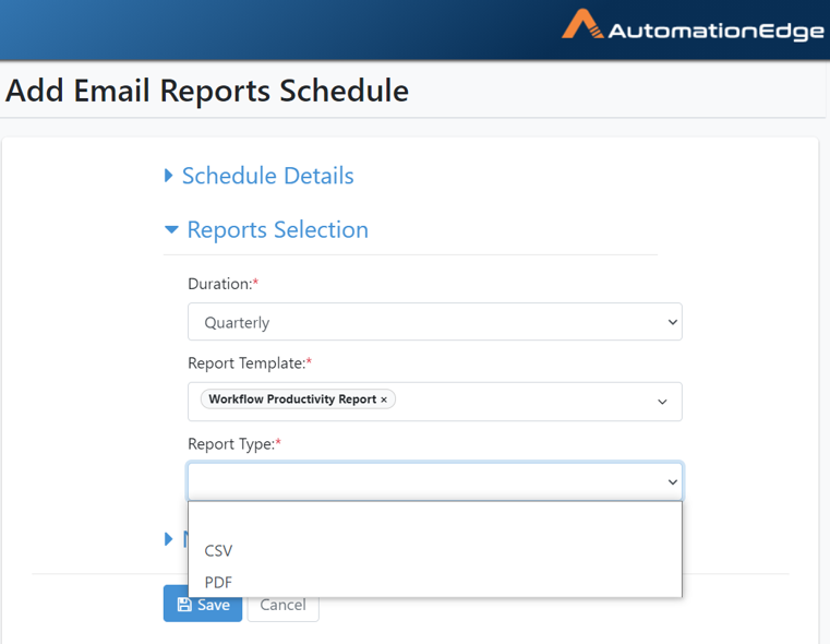

  1. Select a Report Type from the list. Choose from CSV/PDF.
Figure 14.44: Selected Report Template
  1. In this case, select CSV.
Figure 14.45: Selected Report Type
