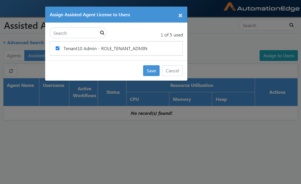

Agents and Assisted Agents tabs are accessible on the Agents menu by default. The Controller Agent tab is visible if you enable Controller in the properties file (refer to Tab: Controller Agents).

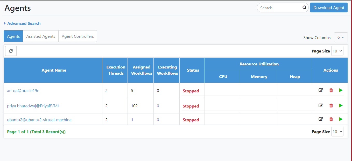

View Agents

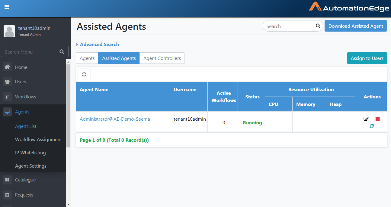

Under the Agents menu, go to the Agents tab. There are two tabs: 'Agents' and 'Assisted Agents' present. 'Agents' tab is selected by default. Set up Controller for the current Tenant to see the third tab for 'Controller'; go to the tab to see and manage Controller Agents.
Use this page for Agent monitoring and view and edit Agent details, as seen in the below snapshot; and described in the table below.
Figure 7.1: View Agents

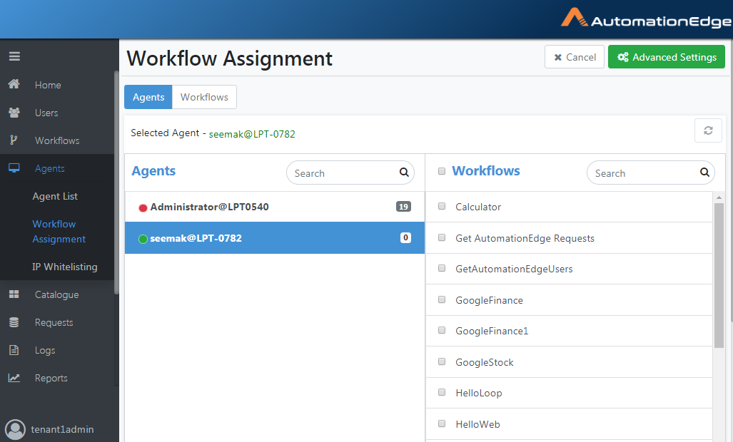

| Assigned Workflows | Displays the number of Workflows assigned to the Agent; Assisted Workflows are not part of number as there is no option for Assisted Workflows assignment to Agents. | |

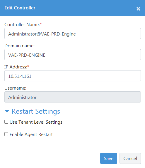

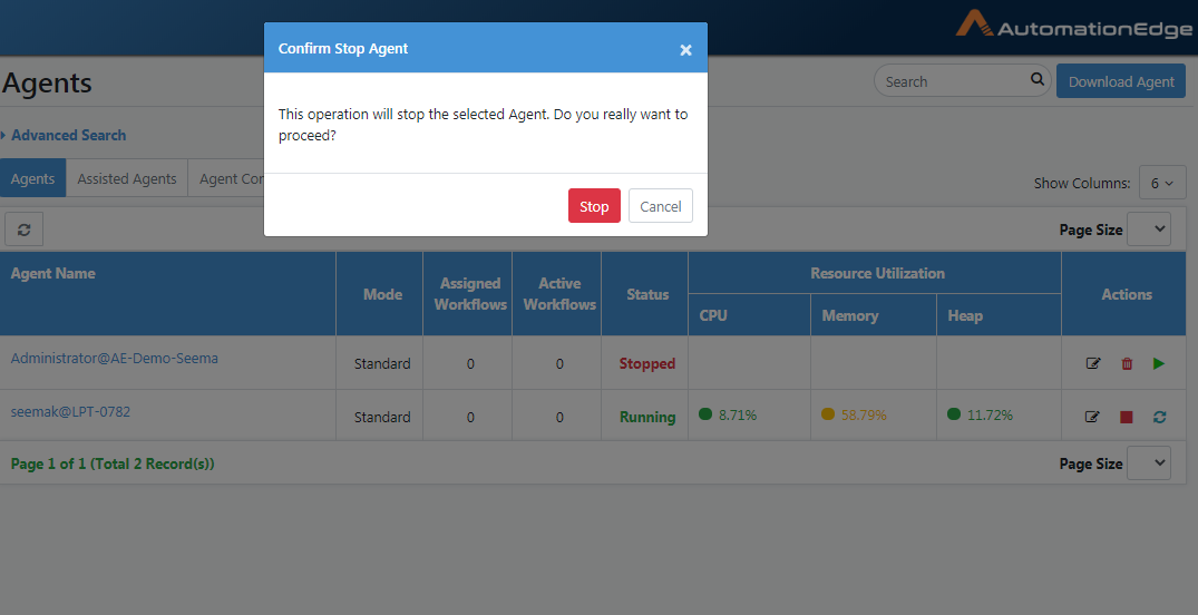

| Actions: | ||

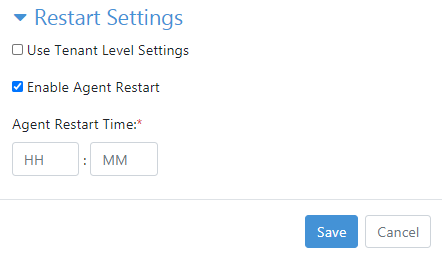

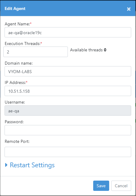

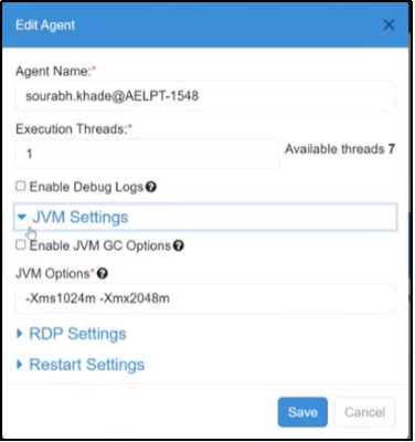

| Edit ( | - Click the pencil icon to edit the Agent Name, Execution Threads,Enable Debug logs and JVM Settings.- Click JVM Settings to expand the option. - Select/ Clear the checkbox to enable JVM GC Options.- JVM Options will allow you to specify JVM arguments with which agent is launched.- Eg: most commonly used are heap size -Xms1024m -Xmx2048m ![]() | |
| Expand restart Settings. By default, the 'Use Tenant Level Settings' checkbox is selected for Agent Restart set in the menu option Agents->Agent Settings->Agent Restart Time. Else, you may uncheck the 'Use Tenant Level Settings' and 'Enable Agent Restart' checkbox is displayed. Enable the 'Enable Agent Restart' checkbox to see the Agent Restart Time option. Provide desired restart time. Note: Agent restart features in not supported on Linux based OS | ||

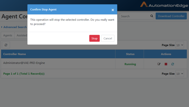

| Stop ( | Stop icon is visible if the Agent status is Running or Unknown. | |
| Click to stop and end all activities of a Running Agent and change its status to Stopped. Or click to mark an Agent in Unknown status as Stopped. | ||

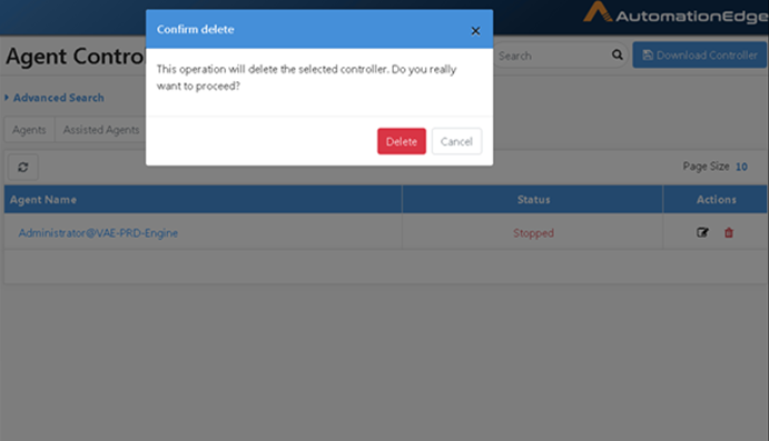

| Delete( | When an agent status is Stopped, then the delete icon is visible. You can delete an agent only when it is in the 'Stopped' status. Deleting an Agent removes its record from the server database. Hence, you cannot start the deleted agent. Restart( | |
| Start( | If an Agent is down, a Start option is visible, and the Start icon is disabled; Assign Agent to one or one controller to enable it. For details, please refer to the section: Agents**:** Controller Assignment. The Start option starts the Agent on the Controller Agent machine. The icon colour is grey when it is disabled and green when enabled. |
In the Edit Agent dialog, you can select the following checkboxes, if required:
- Enable JVM GC Options: Selecting the checkbox will ensure that the heap memory used by the Agent for processing a heavy workload is freed post the executions. If the setting is changed, then the Agent is restarted.
- Enable Debug Logs: Selecting the checkbox will start debug log download, which will contain detailed information about workflow executions Both, Enable JVM GC Options and Enable Debug Logs options, are also available for Assisted Agents. For more details, see Agent Settings.
When you change the values using the edit option and save them, the agent will restart automatically. After restarting, the agent will use the new values you have saved.

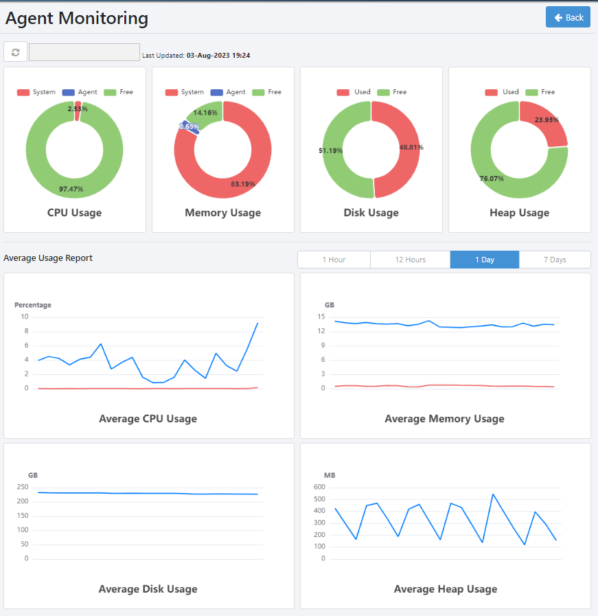

Agent Monitoring
Agent Monitoring page displays Resource Utilization by the Agents graphically.
Following are the features of Agent Monitoring.
Agent captures Resource Utilization information periodically (every minute) and sends it to the server every 15 minutes; it retains it for thirty days.
The following Resource Utilization parameters are captured and displayed on AutomationEdge UI: CPU, Memory, Disk Space and JVM Parameter (Heap size).
The Agent Monitoring screen depicts Resource Utilization as pie charts and line charts.
The page has radio button options to display Agent Monitoring for different time intervals.
Following are the steps to display the Agent Monitoring page.
- Navigate to the Agent menu. Click on an Agent Name link to navigate to the Agent Monitoring page for that Agent.
Figure 7.2: Agent Name is clickable
The Agent Monitoring dashboard for Agent Name Administrator@VAE-PRD-Engine appears as below.
This dashboard below displays Agent Monitoring for seven days by choosing the '7 Days' radio button.
Figure 7.3: Agent Monitoring

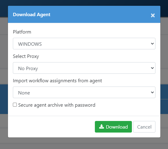

To download an agent:
Navigate to the Agents menu.
Click the Download Agent button on the top right corner.
(Note: Admins and Agent Administrators can download Agents if the System Administrator has set the 'Server URL' in the Settings menu.)

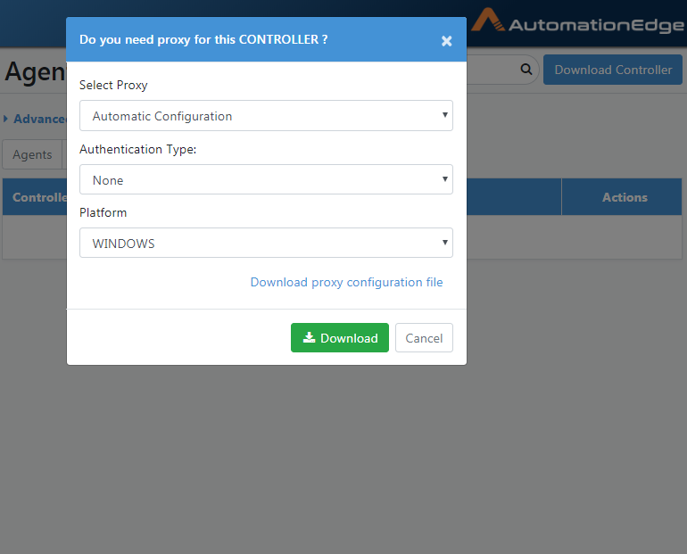

- The Download Agent dialog appears.
Figure 7.4: Downloading Agent

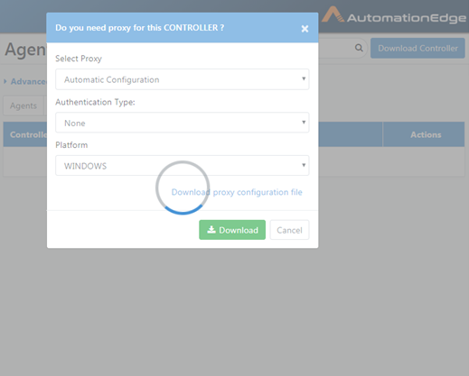

- Select Proxy and Authentication Type fields from the corresponding drop-down lists. The table below explains the list values.
Table 7.3: Agent level Proxy configurations
| Field Name | Description |
| Select Proxy | During Agent download, you can use Automatic Configuration or set Static Proxy by providing Proxy protocol (http/https), host, port or set Dynamic Proxy (base on PAC file from URL). During Agent download, the Agent inherits the Tenant level proxy settings. You may overwrite it. The proxy settings at the Agent level will take precedence over that set at the Tenant level. The following options are available in the drop-down list for Select Proxy. You may overwrite the Proxy set at the Tenant level or set proxy afresh during Agent Download from the drop-down list. |
| 1. No Proxy Select No Proxy if a proxy is set at the system level, and you do not want to use that. | |
| 2. Automatic Configuration Select Automatic Configuration if you wish to auto-detect the proxy configuration from "Internet Options" settings, if any, and use it. | |
| 3. Proxy Server Select the Proxy server to set a Static Proxy. You can now provide static Proxy details, Protocol (http, https), Host (e.g. 10.51.5.30 and Port (e.g. 3128)). | |
| If you have set a static proxy at the Tenant level, a Proxy details popup window appears with static proxy details pre-configured. | |
| You can add exceptions to bypass the proxy details, if required. | |
| When adding exceptions, you must ensure the following: | |
| - Port numbers are not added along with the host name. | |
| - Only semicolon (;) is used as separator and spaces are not allowed in exception entry. | |
| - Only domain names are used and are not prefixed with www or http:/https:. For example, automation.com. | |
| Note: Non-proxy host list now supports regular expression. For example, *.automationedge.com will bypass proxy for demo.auomationedge.com and onedemand.automationedge.com. | |
| 4. PAC Choose this option to set a Dynamic Proxy and provide the PAC file URL (e.g. https://10.51.5.30/proxy.pac) to set the Dynamic Proxy. | |
| If you have set a dynamic proxy at Tenant level, the Proxy details popup window appears with dynamic proxy details PAC file from URL pre-configured. | |
| 5. For Automatic Configuration and both Static Proxy and Dynamic (PAC file URL), Proxy details are stamped into a file proxy-config.properties and packaged into agent zip on click of Download button. | |
| Authentication Type | For Automatic Configuration, Proxy Server and PAC Proxy options, the following three Authentication Types are available. |
| - None | |
| - Simple or | |
| - Domain | |
| 1. None Leave Authentication type to none when Proxy settings do not need authentication. | |
| 2. Simple If proxy settings in "Internet Options" need authentication, select Authentication type- Simple from the dropdown list and provide a username and password. | |
| For Simple Authentication Type, you need to provide a Username (e.g. scott.tiger etc.) and password. | |
| 3. Domain If the Authentication type is a domain, you need to provide Domain (e.g.xxxx.com) in addition to username and password. | |
| Platform | The two platforms allowed in the drop-down list are WINDOWS or LINUX |
| Download proxy configuration file | A proxy configuration in the Agent Downloa UI stamps the values into a file proxy-config.properties. |
| You may download the file by clicking the 'Download proxy configuration file' link; if you click the Download button, the proxy-config properties file is packaged into agent zip and placed under <AGENT-HOME>/conf directory. | |
| Download the file and manually copy it to the Agent machine when there are changes in proxy details. | |
| In the case of the Server upgrade with a new Proxy configuration, there are two scenarios. If the agent is running, Proxy details are updated, and manually copy the proxy-config.properties file, but if the Agent is in the stopped state, then the new proxy details are updated in the Agent | |
| - | During upgrades, Agents acquires Tenant level Proxy settings, if any. Following are the corrective actions for the two scenarios, |
| Upgrades | - Agents may be without any Proxy Settings, but Agent gets Tenant level proxy settings during the upgrade. Users need to delete the proxy configuration file from the Agent file system. |
| - The Agent may be using custom Proxy Settings(different from Tenant level settings); but, in case of an upgrade, Agent gets Tenant level Proxy Settings, User's need to download custom proxy settings again and copy to the Agent file system. | |

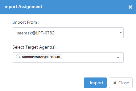

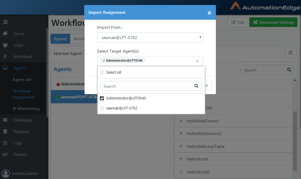

| Import workflow assignments from agent | Select the agent from which you want to import the workflow assignments. |
| Include workflow and plugin files in the downloaded zip | Select the checkbox if you want to include the following artefacts in the agent zip: |

Selecting to download the existing agent's workflow assignments and the corresponding artefacts allows the new agent to be readily available for executing the workflows. Changes made to one agent at an individual level does not impact the another agent, even if they have same workflows assigned to them. For example, if both, Agent1 and Agent2 are assigned Workflow1, and the user assigns another workflow, Workflow2 to Agent1, then there is no change in Agent2.
Provide Proxy Server details if required, as explained in the table above and click Download.

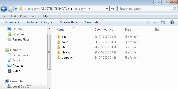

Unzip the downloaded file and extract an agent.
Copy the downloaded zip to one or more machines where you want to run the agent; and unzip it there.
It creates an unzipped ae-agent directory.
Double-click on aeagent.exe. The agent is registered with the server and becomes available for assigning workflows.

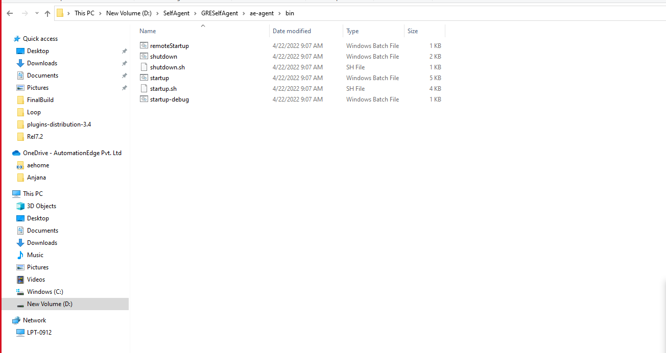

- Run ae-agent/bin/startup.sh file (for Linux) from the command prompt as shown below. The Agent will register itself with the server and be available for assigning workflows as described in the next section.
Figure 7.7: Agent bin directory
Type cmd in the Windows explorer address bar and press keyboard enter.
In the Command Prompt, type startup.bat. Press Keyboard Enter. Starting Agent from command prompt is the recommended way rather than double-clicking on startup.bat.
Once Start-up is complete, view Agents in UI. You can see the Agent status as Running for the first registered Agent in the list.
By default, Agent always registers with one execution thread. Once registered, you can edit the Agent execution thread count, provided your license has provision for these modes.
- To stop an Agent Run ae-agent/bin/shutdown.bat or ae-agent/bin/shutdown.sh file (for Windows and Linux respectively) preferably from the command prompt.
If you run the startup.bat file, the command prompt will not be visible and the Agents will run in the background. To view the command prompt, run ae-agent/bin/startup-debug.bat file.

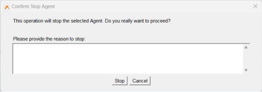

| Restart Agent | Click to restart the agent, if required. |
| Stop Agent | Enter the reason for stopping the Agent. Click to stop the agent, if required. ![]() |

Agents: Memory Settings
Additional JVM Params in Agent Startup
Following are the java Memory settings for Agents in startup.bat by default.
| Heap Settings | -Xms1024m -Xmx2048m |
| MaxMetaspace Setting | -XX:MaxMetaspaceSize=128m |
| Memory per thread | -Xss=1MB |
If workflows require more or less memory, change the settings in startup.bat or startup.sh. Once you restart the Agent with the new Memory settings that suffice workflow requirements, it should complete successfully.

Navigate to the Agents 🡪Agents menu.
There are three on the Agents page for Agent Monitoring for the Admins and the Agent Administrators. Two tabs: 'Agents' and 'Assisted Agents', are visible by default. Set up Controller for the current Tenant to view the third 'Controller' tab; click the tab to see and manage Controller Agents.
Select the 'Assisted Agents' button. This page is for Assisted Agent monitoring. View Assisted Agent details as seen in the figure and described in the table below.
Figure 7.8: Assisted Agent Monitoring
The table below explains the fields in the Agents view,

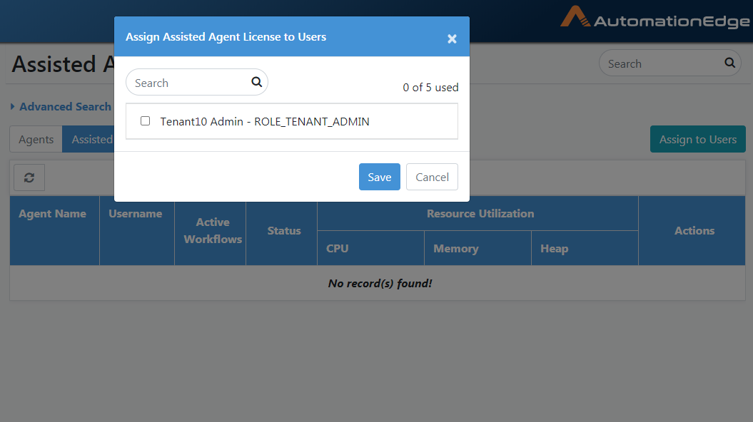

- Click the Assign to Users button as shown in the screenshot below to give permissions to users for using Assisted Agents. The Admin can see the users available.
The Administrator(Tenant3 Admin) is selected by default and the number of Assisted. Hence, in the screenshot below, we see one of five(1/5) Assisted Agents is used. Note: Five is the provision for the number of Assisted Agents in the license.
Figure 7.10: Assisted Agents License to Users
- Enable checkbox for the users to whom permission is to be given. Click Save.
Note: 3 of 5 used seen on the top right corner in the screenshot below shows that three Assisted Agents have been assigned to users out of a total of five Assisted Agents available or attached to the current Tenant. Click Save.
Figure 7.11: Assign Assisted Agent License to Users
We can see the Assisted Agent Assignment updated successfully message.

After the assignment, you can see the Download Assisted Agent button on the top right corner. Click on the button.
Figure 7.12: Download Assisted Agent
- The Proxy Configuration window appears. Configure Proxy if required. For details, see Vault Connections.

- Unzip the downloaded Agent zip file and extract the Assisted Agent on the machine where to run. It contains an ae-agent directory. Copy the downloaded zip file to one or more machines to run an Assisted Agent.
Figure 7.13: Assisted Agent Directory

Assigning Workflow to an Assisted Agent
There is no need to assign Assisted workflows to an Assisted Agent. However, Assisted Agent can execute Assisted workflows for which Assisted Agent Owner User has execution permissions. Please note that Assisted workflows are always sequential workflows.

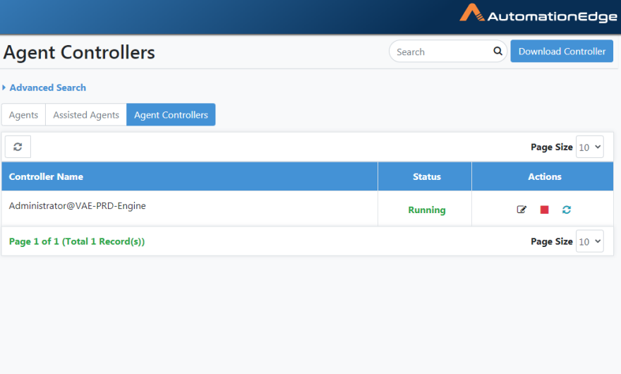

Agent Controller: Designate at least one Agent as Agent Controller by marking one or more agents as 'Controller' from AE Portal. The Agent Controller does not run any workflow**.** Agent controllers receive instructions from the server to start Agents on user demand. The Controller who takes control first starts the Agent.
An Agent controller cannot start automatically; always start it manually. To view controller from UI, need to set enableController=True in TOMCAT_HOME\webapps\aeui\aeui-config.properties property file.
Agent controller can run on Windows machines only, and it can control Agents on Windows machines only.
Controlled Agents: Except for controller agents, all Agents are controlled Agents. Start controlled Agents from the AE Portal. As we need to start the Windows session using RDP, provide the Windows login password of the corresponding windows user. The Agent captures other details like hostname, IP address, username where it is running. Provide the password in the AE Portal.
The option to download controller and view controllers is available to Admin and Agent Administrator.

Click the Download Controller button on the top right corner.
A pop-up window appears for setting Proxy server details if required. Click Download.
Figure 7.15: Proxy Window

Start Agent controller from ae_agent/bin directory by running startup.bat
You can now see the Agent Controller is running
Figure 7.17: Controller Agent Running
Agent Controller: Stop
- You can now see Edit and Stop icons in the Actions column. You may click the stop icon to see the Stopping Agent message as below.
Figure 7.18: Stopping Agent Controller

Agent Controller: Delete
- Click the Delete icon. It gives a pop-up to configure delete.
Figure 7.20: Delete Controller Agent

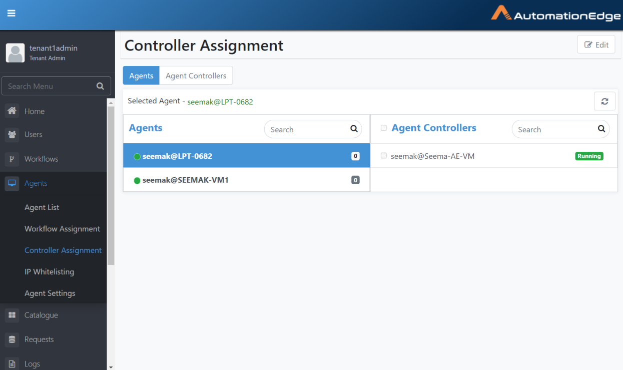

Mark at least one agent as Agent Controller.
For all the other Agents, enter the windows password using the Agent Edit dialog.

- Right Click on the remoteStartup.bat shortcut and click Properties.
Figure 7.23: remoteStartup executable on Agent machine

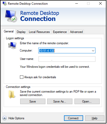

A. On Controller Machine:
- On the Remote Desktop Connection Window, uncheck Always ask for credentials, as seen below.
Figure 7.26: On Controller, machine uncheck 'Always ask for credentials'

Start AutomationEdge Agents from the respective Controller Agents to which they are assigned. Please refer to section 7.7 Agents: Controller Assignment for steps to assign Agents to Controllers. Following are the steps for AutomationEdge Agents Start/Stop,
- Go to the Agents 🡪 Agent List menu.
Figure 7.27: Agents View
Click the Download button on the top right corner to download the Agent.
You may start the Agent on your machine/VM.
You see the Agent in the Agent List Column is in running state.
For taking RDP and starting the Agent on the Controller machine, you need to edit the Agent and provide Agent machine credentials. Click Edit in the Action column.
Provide Remote Machine Password for the User and Click Save. Successful Changes saved to Agent message displays.
Figure 7.28: Edit Agent to set Remote Desktop password

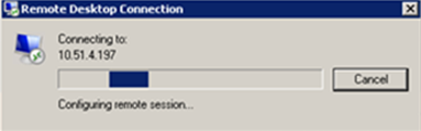

- Controller Agent tries to establish Remote Desktop Connection.
Figure 7.30: Controller starting remote machine and agent on the remote machine
RDP starts the remote machine. Controlled Agent also starts on the machine.
The start icon is no longer visible next to the first Agent and Agent in the Running state.
In the Actions column, click Stop. The Confirm Stop Agent dialog appears.
Enter the reason for stopping the Agent, if required.
To allow users to understand why an Agent was stopped, we recommend providing the reason for stopping an Agent. To view the reason why an Agent was stopped, on the Agents page hover the mouse over the status of the selected Agent.
Figure 7.31: Stop Remote Agent
When a running Agent is stopped, the RDP session also logs out.
- In this case, it displays a Stopping Agent is in Progress, message. When a running Agent is stopped, the RDP session also logs out.

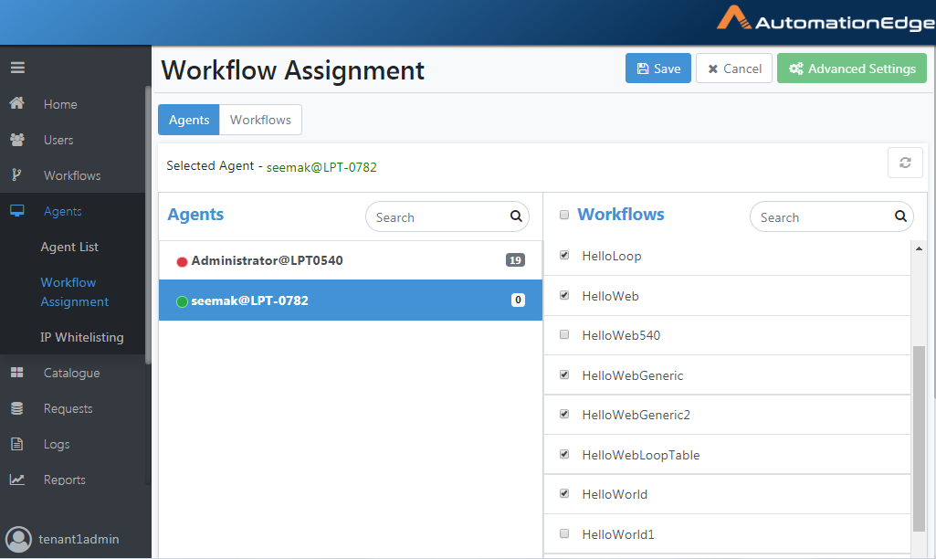

Agents: Workflow Assignment

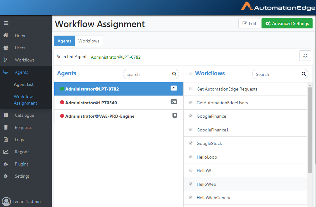

Using the Workflow Assignment menu, you can assign and edit workflows assignments to agents.
You can assign up to 500 workflows (minimum workflow 0 -- maximum workflows 500) to an Agent.
To assign a workflow to an agent using Workflow Assignment:
Navigate to the Agents🡪 Workflow Assignment menu.
By default, the Agents tab is active.
Figure 7.32: Assigning Workflows to Agent
Scroll or Search for Workflows on the right-hand side column of the page. Enable or disable the checkbox for workflows to assign to the Agent.
Enable checkbox next to two workflows -- HelloWebGeneric2 and HelloWorld, as seen below.
Figure 7.33: Selecting Workflow to assign to an Agent
Click Save to save the assigned workflow to an agent. Assignment saved successfully message appears.
Figure 7.34: Workflow Assignment Confirmation Box
- Similarly, you can go to the Workflows tab next to the Agents Tab. Select the Agents on the right-hand column for the workflow selected on the left-hand column.
To run an assisted Workflow, the User needs the execute permissions on that Workflow. It is not required to assign such Workflow to any Agent. The assigned workflows or agents appear at the top in the Workflow Assignment tab.
Import Agent Assignments
Assign all the workflows of one agent to another agent, with this option.
To assign a workflow to an agent:
Navigate to the Agents🡪Workflow Assignment menu.
Click Advanced Settings button on the top right corner.
Figure 7.35: Advanced Settings
- An Import Assignment screen appears.
Figure 7.36: Source and Target Agents
Click Import from the drop-down list and select an Agent to import.
Select agent from the drop-down of Select Target Agent(s).
Figure 7.37: Select Agent
- The Import Assignment is seen below.
Figure 7.38: Import Assignment
- Click Import. Notice the message 'Operation successfully completed'.
Following is a table to describe the fields for Select Target Agent(s).
Table 7.5: Agent Configuration Field Description
| Select Agent(s) | To select an agent from the drop-down list. |
| Select all | To select all the agents in the drop-down list. |
| Deselect all | To deselect all the selected agents in the drop-down list. |
| Import From | To select the location from the drop-down list for importing agents. |
| Save Button | To save agent configuration. |
| Reset Button | To clear the selected details of the agent. |
The Actions column on the Agents page has an icon to Start Agents, disabled by default. Assign Agents to one or more Controllers to enable the Start icon. Controllers can start Agents assigned to them.
For Agents assigned to more than one Controller, any idle Controller can start the Agent. Deleting an Agent Controller deletes all its Agent assignments.
A well planned Agent assignment to Controllers acts as a load balancer to balance the load on Controllers. Agent Controller assignment also provides tighter control over Agents and serves security purposes by restricting Agent access to the designated Controllers.
From the Controller Assignment menu, assign and edit,
Agents to a Controller or
Controllers to an Agent
Navigate to the Agents🡪 Controller Assignment menu.
By default, the Agents tab is active. Select an Agent from the list.
Click the Edit button on the top right corner.
Figure 7.39: Assigning Workflows to Agent
- Select one or more Agent Controllers by enabling the checkboxes in the Agent Controllers column on the right.
Figure 7.40: Selecting Controllers to be assigned to an Agent
- Click Save to save the assigned Controllers to an Agent. Assignment saved successfully message appears.
Figure 7.41: Workflow Assignment Confirmation Box
Similarly, go to the Agent Controllers tab next to the Agents tab, select a Controller and assign Agents to it by selecting them from the right column.
The process of Agent(/s) assignment to Controller(/s) is complete.

| Enable Agent Restart | Set using a toggle switch. Click to enable Agent Restart. |
| Note: Agent restart features is not supported on Linux based OS. | |
| The Agent Restart Time field is available if you enable the field. | |
| Agent Restart Time | Schedule an Agent Restart Time if Agent Restart is enabled. Configure the restart time at the Tenant level in this menu or on individual agents by editing Agent in the Agent List menu. |
