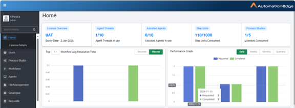

To view the Home page:
  1. In the menu, click Home. The Home page appears.
    home
  2. On the page, you can see the following:
    • License Overview: Displays the type of license and expiry date of the license. Click in the License Overview tab and you are taken to the License Details page. For details about updating license, see License Details.
    • Agent Threads: Displays the number of agent threads in use.
    • Assisted Agents: Displays the number of assisted agents in use.
    • Step Units: Displays the step units consumed.
    • Process Studio: Displays the number of Process Studio licenses used.

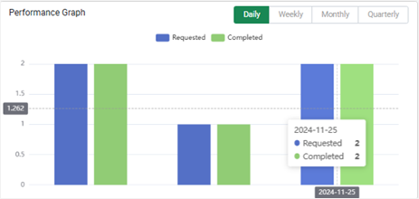

In the following section, you can view various charts and graphs that display the current AE engine status. You can hover over each view to see the details.

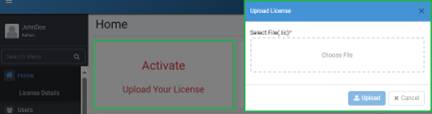

  1. On the Home page, click Activate - Upload Your License tab. The Upload License dialog appears.
    license
  2. In the Select File(.lic)/*, click Choose File. The File Explorer opens.
  3. In the File Explorer, select the license, and then click Open. The file appears in the field.
  4. Click Upload. The license is uploaded and activated.

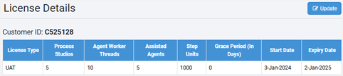

You can view the license details on the License Details page.
To view the license details:
  1. In the menu, click Home → License Details. The License Details page appears.
  2. The following field details appear:
    Customer IDDisplays the unique customer ID.
    License TypeDisplays the type of license you are using.
    - Trial
    - Production
    - UAT
    - Development
    Process StudiosDisplays the maximum number of Process Studios that can be assigned to users and registered.
    Agent Worker ThreadsDisplays the maximum number of agent threads available in the license.
    Assisted AgentsDisplays the number of subscribed Assisted Agents.
    Assisted Agents are personal Agents or Attended Bots and run on the users’ machine. Assisted Agents can execute one workflow at a time.
    For more details, see Assisted Agents.
    Step UnitsDisplays the associated step units consumed for each step instance.
    Steps in a plugin have associated step units. Each step instance consumes associated step units when these steps are used in an active workflow in AutomationEdge.
    The total number of Consumed Step Units of all the active workflows deployed on AutomationEdge at any time should not exceed the number of overall Step Units specified in the license.
    Grace Period (In Days)Displays the Grace period of the license over the expiry date.
    Start DateDisplays the license start date.
    Expiry DateDisplays the date when the license will expire.
