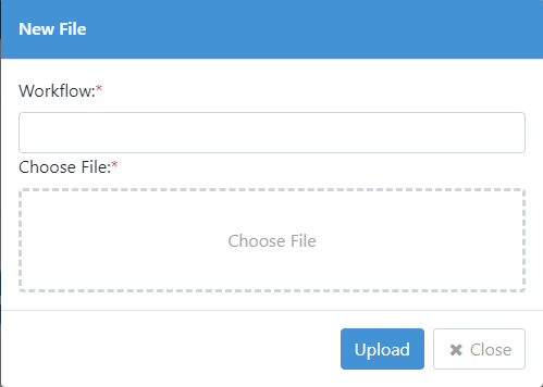

To upload supporting files for a workflow,
  1. Navigate to the File Management → Workflow Files menu. The Workflow Files page appears.
  1. Click Upload. The New File dialog appears.
  1. Click in the Workflow field. The list of workflows appears.
    Note: To select multiple workflows, select the respective workflow checkbox.
  2. Select the workflow and then click Choose File. Select the file you want to upload.
  3. Click Upload. The selected workflow is uploaded and appears in the list on the Workflow Files page.

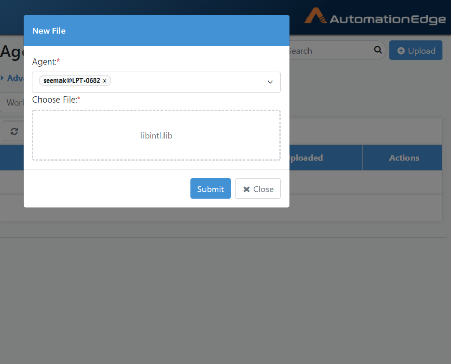

Upload supporting File for an Agent
To upload supporting files for an Agent,
  1. On the File Management menu on the Agents tab, click the Upload button.
Figure 20.1: File Management for Agents
  1. The New File popup appears. Click the drop-down arrow on the Agent field to see the list of Agents. Select an Agent to upload supporting files by enabling the check box next to the Agent, or type a search string to filter Agent names and enable the checkbox.
  2. Click on Choose File box and browse for the file upload. Click Submit.
Figure 20.2: Choose File
  1. A 'File Uploaded Successfully' message appears, and the uploaded file is visible in the Agent Files list.

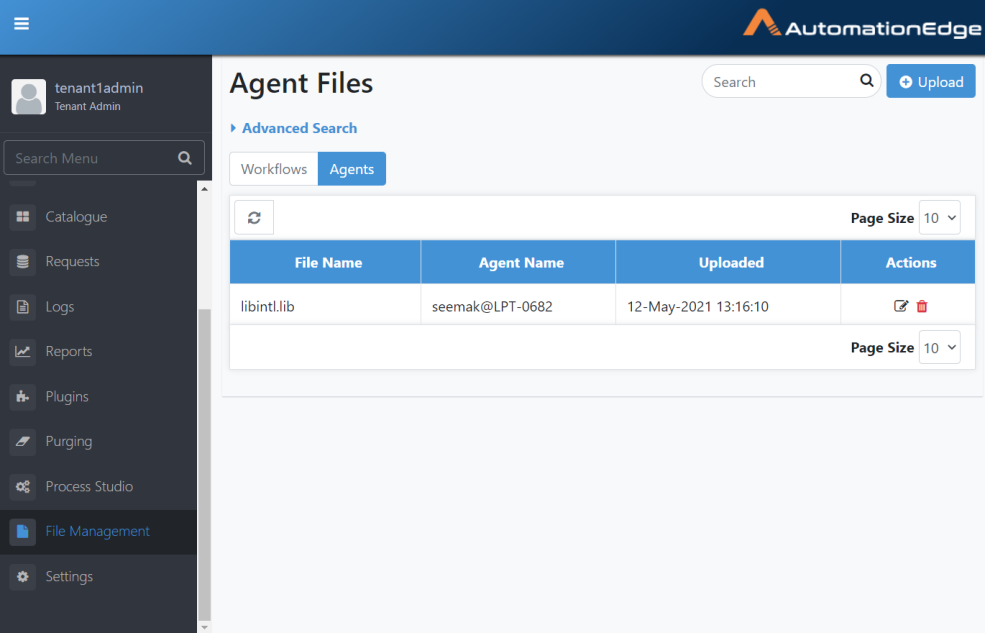

View and Actions on supporting Files for an Agent

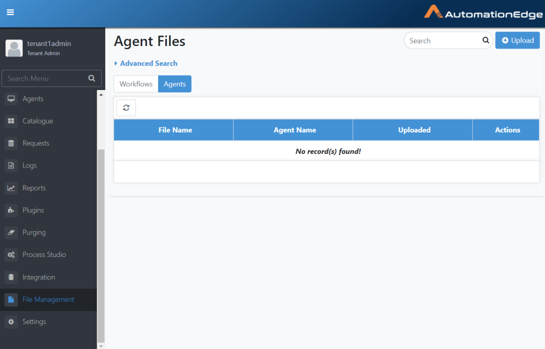

In the File Management menu, the Agents tab lists all the uploaded supporting files for Agents.
  1. The File Management menu on the Agents tab shows the list of supporting files uploaded for Agents.
Figure 20.3: Search and Advance Search for Agents File Management
The table below describes the page components.
Table 20.2: Agent Files View
ColumnDescription
SearchEnter the Search string to filter the list.
Advanced SearchExpand to enter the advanced search criteria
File NameThe name of the file uploaded
Agent NameThe Agent name for which the file is uploaded
UploadedThe timestamp for the file upload
Actionsi. Click the Edit icon () to edit the file uploaded. Click on the Choose File box to browse for an updated version of the same filename. The Agent field is not editable and cannot be changed.
ii. Click the Delete icon ( ) to delete the file from the AutomationEdge server.

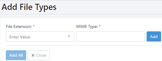

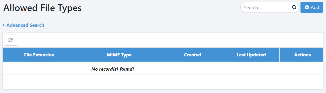

Following are the steps to add the file types:
  1. Navigate to the File Management → Allowed File Types menu. The Allowed File Types page appears.
  1. Click Add. The Add File Types page appears.
File Extension *Enter the file type you want to add to the list.
Note: You select a file extension You can select multiple file types.
MIME Type *Enter the type of MIME you want for the file extension.
*: indicates the fields are mandatory.
  1. Click Add. The extension list is created.
  2. Click Add All. The extensions appear in the list on Allowed File Types page.
