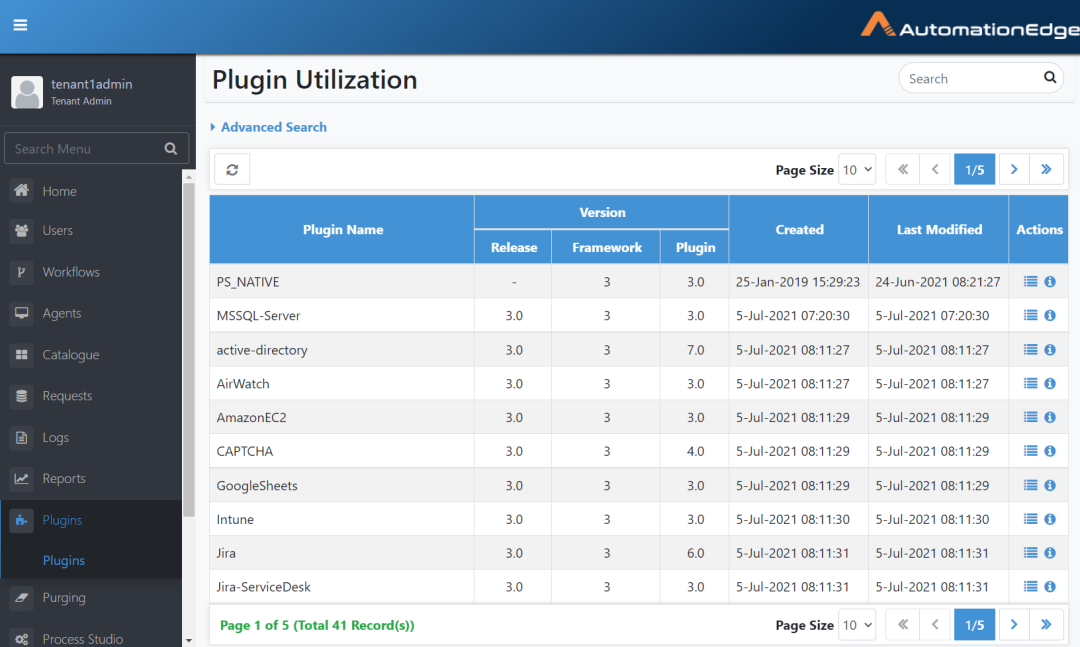

The following screenshot shows the list of plugins current available in the system.
Figure 15.1: Plugins View

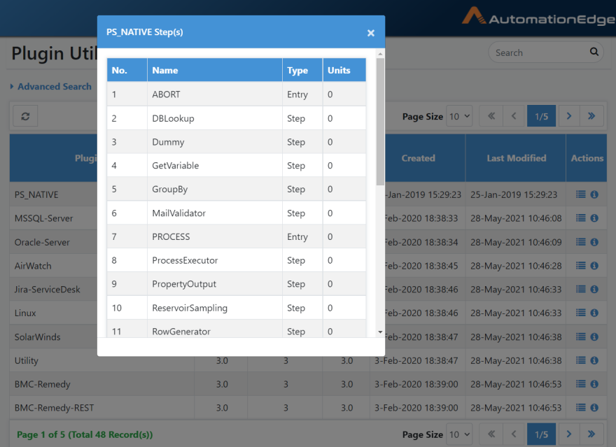

Plugin Steps
Click on any Plugin Steps icon
( ) in the Actions column to see its steps.
Figure 15.2: Plugins Steps

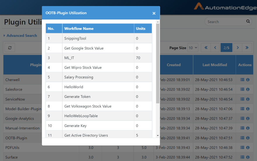

Plugin Utilization
Click the Plugin Utilization icon
( ) in the Actions column next to the OOTB plugin. It
shows the OOTB Plugin Step Units utilization in workflows. In the
screenshot below plugin, utilization is seen in two workflows as marked
below.
Note: These step units add up as consumption of License Step Units.
Figure 15.3: OOTB-plugin utilization in workflows

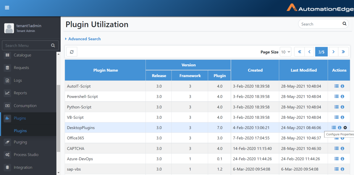

Plugin Properties Configuration
Some plugins have the Configure Properties option
( ). Following are the steps to configure plugin
properties.

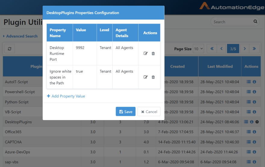

- Notice the plugin DesktopPlugins in the following snapshot. Next to the Actions icon, there is a gear icon to Configure properties.
Figure 15.4: Configure plugin properties gear icon

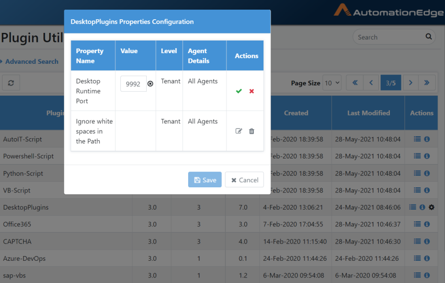

Click the gear icon to configure properties. The DesktopPlugins Properties Configuration pop-up appears. As you can see, there is one property Desktop Runtime Port, configurable at the Tenant Level. This property configuration will be applicable for all Agents of that Tenant.
Click Edit to set a Property Value at Tenant Level. Set Desktop Runtime Port value at Tenant level as shown below. Confirm the value by clicking the tick mark under Actions.
Figure 15.5: Configure plugin properties with the gear icon

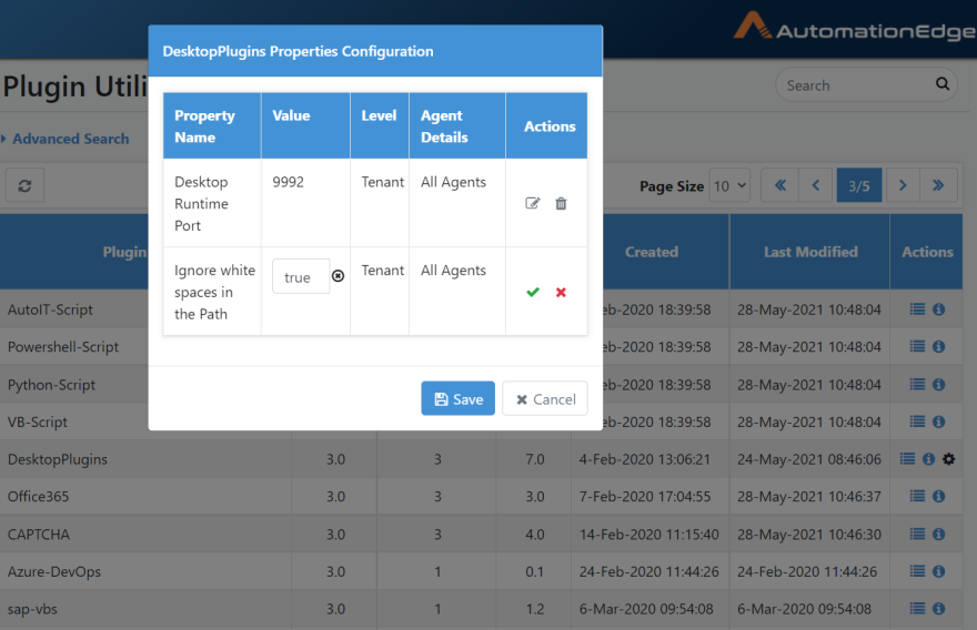

Set Ignore White Spaces in the Path value at Tenant level as shown below. The possible values are true/false. Confirm the value by clicking the tick mark under Actions.
Figure 15.6: Desktop Runtime port at Tenant Level
Click Save to make the Desktop Runtime Port and Ignore White Spaces in Path at Tenant Level Permanent. Property Values updated for selected Plugin success message appears.

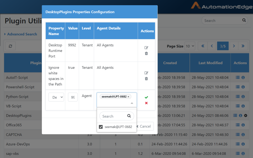

Click Add Property Value to Add the Desktop Runtime Port/Ignore White Spaces in Path at the Agent level.
Figure 15.7: Add Plugin Property

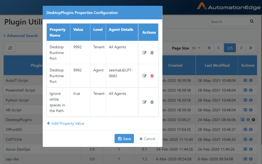

- For different values set at Tenant level and Agent level, the value at Agent level takes effect. For the newly added Desktop Runtime Port, select an Agent from the drop-down list. Confirm Desktop Runtime Property by clicking the tick mark.
Figure 15.8: Select Agent to configure property at Agent level

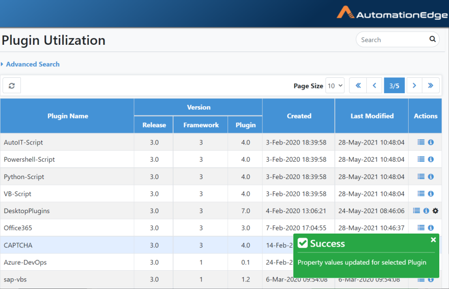

Click Save to save the properties; else, Cancel to discard them.
Figure 15.9: Save plugin property
- Upon Save, Property Values updated for selected Plugin message appears.
Figure 15.10: Plugin property values updated success message
