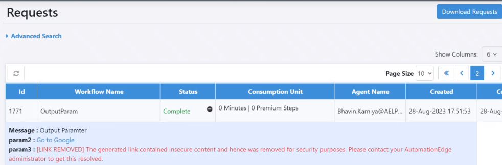

If there is an output parameter type hyperlink in the workflow, then you will see a link if the validations are fulfilled, else you will see a message, respectively. See the following screenshot:
Example 1:
param2: if the validation is fulfilled, you will see the link to the external site. Click the link and you will get redirected to the site, which will open in a new tab.
param3: if the validation is not fulfilled, the link is removed and you will see the message informing why the link was removed.
If there is an output parameter type AE-AppLink in the workflow, then you will see a button or message, respectively. See the following screenshot:
Example 2:
Param1: if the validation is fulfilled, you will see the app button. Click the button and you will get redirected to the AE app, which will open in a new tab.
However, if the validations are not fulfilled, you will see a message informing you that the app does not exist.

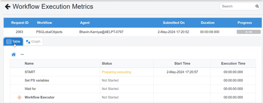

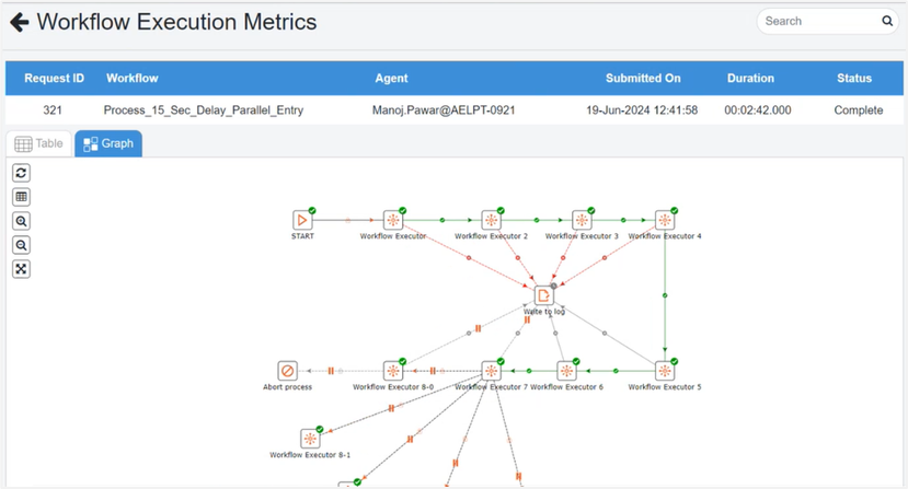

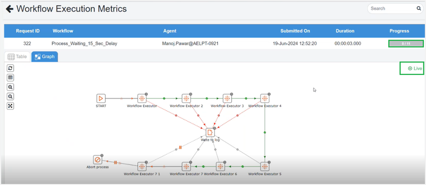

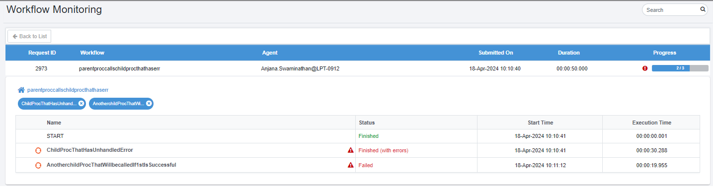

You can also view the workflow execution metrics, if required. For more information, see Workflow Monitoring.
In the Requests page, click ID link of the request for which the Workflow Monitoring feature is enabled. The link is available only if the Enable Workflow Monitoring checkbox in the Update Workflow page is selected.
