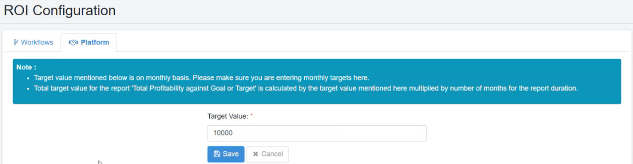

To configure ROI:
  1. Click WorkflowsROI ConfigurationPlatform. The ROI Configuration page appears, with the tenant's target value.
  2. Enter the Target Value, and then click Save. The details are saved\
  • After saving the ROI configuration, assign the workflow and run on the Agent.
  • Go to Dashboard to generate reports based on ROI configuration.
