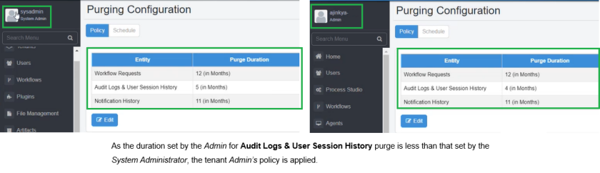

There are two scenarios for the application of the purge policy: Scenario 1: If the flag ae.global.purge.enabled=false, in the ae.properties file, then:
  1. You can apply purging only for those tenants who have specified a purge policy.
  2. The Purge Duration set by the System Administrator and Admin are considered, and the policy which has lesser purge duration is applied to the tenant. For example, see the following screenshot:
Scenario 2: If the flag ae.global.purge.enabled=true, in the ae.properties file, then: 3. You can apply the purging policy globally to all tenants irrespective of whether the tenant has defined a purge policy or not. If the tenants do not have a purge policy, then the System Administrator’s policy is applied to all tenants. 4. If tenants have purged policy, then Purge Duration set by the System Administrator and Admin are considered, and the policy which has lesser purge duration is applied to all tenants.

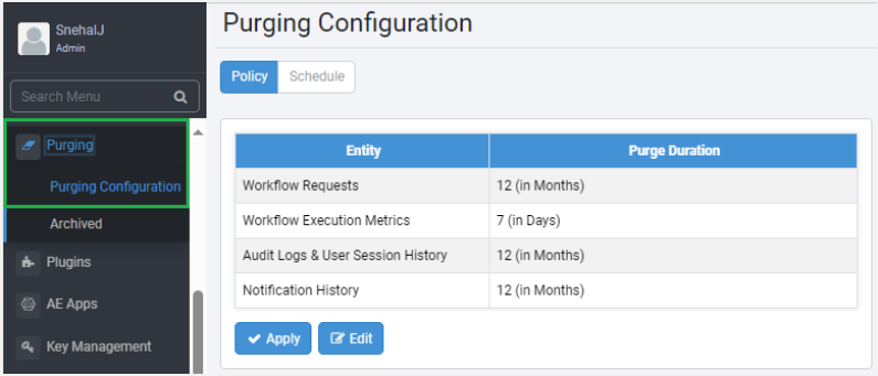

Following are the steps to create a Purge policy, including Purge Duration and Notification Details,
  1. Navigate to the Purging🡪Purging Policy menu.
  2. An Admin can apply or edit the policy.To apply the purge policy, click Apply. Application of the tenant policy is a one-time activity.
Note: Apply is unavailable, if ae.global.purge.enabled=true, in the ae.properties file. Or To edit the tenant policy, click Edit.

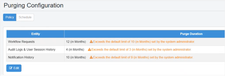

You can set the purge duration of the policy equal to or less than the duration set by the System Administrator. Else, you’ll see the following:
The purge policy is applied depending on the purge duration set by the System Administrator or Admin. If you set the purge duration less than that set by the System Administrator, then the Admin’s purge policy is applied to the tenant.

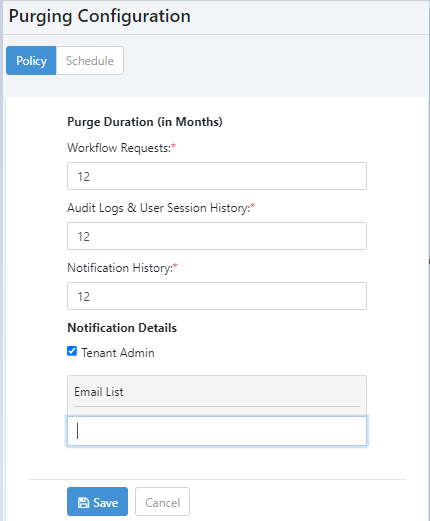

  1. Change Purge Duration by providing new Configuration details. Also, provide Notification Details.
  2. Click Save.The purge details are saved.
Figure 17.1: Update Policy Configuration

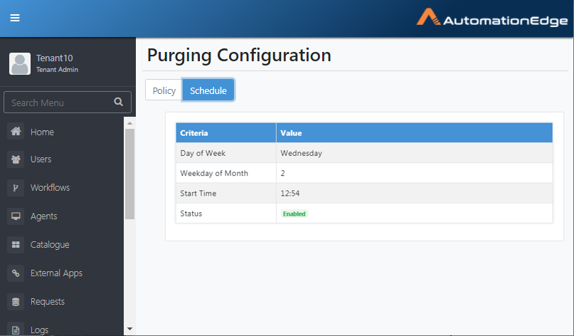

Following are the steps to view a Purge Schedule,
  1. Navigate to the Purging🡪Purge Schedule menu.
  2. Purge Schedule set by the System Administrator. Admin can only view the Purge Schedule, as seen below.
Figure 17.2: View Purge Schedule

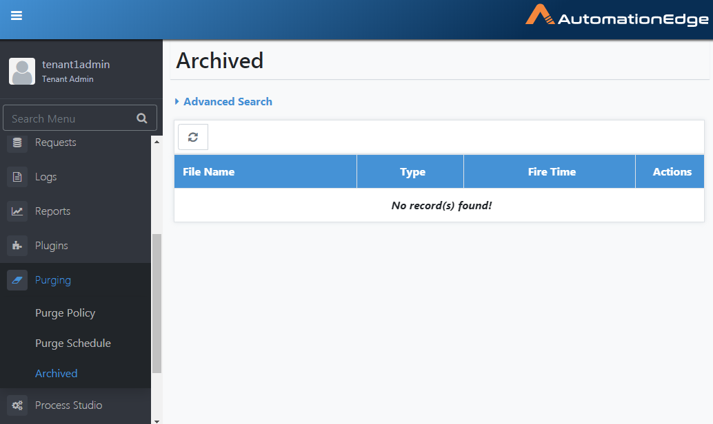

Following are the steps to view and download Archives from AE UI,
  1. Navigate to the Purging🡪Archives menu.
  2. Archives are available once at least one Purge Schedule execution is complete. In the beginning, there are no Archives.
Figure 17.3: View Archives
  1. The Fire Time column shows the Purge Schedule execution time.
  2. Download Archives by clicking on any File Name link as seen below.
  3. Delete Archives by clicking the delete icon ( ) in the Actions column.
