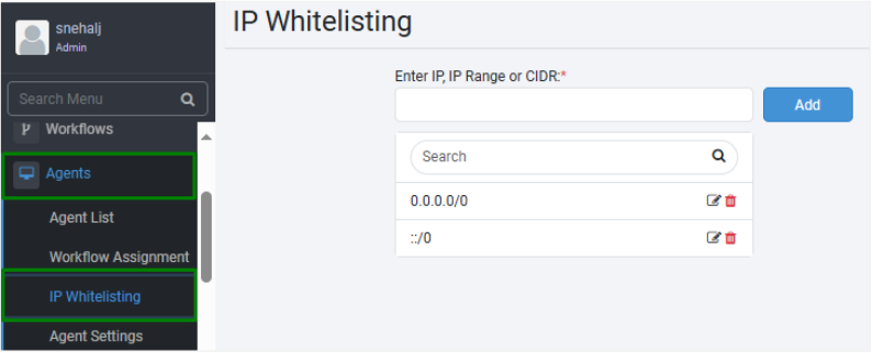

  1. In the menu, click Agents → IP Whitelisting. The IP Whitelisting page appears.
    Dialog

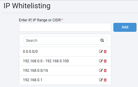

  2. On the page, enter whitelisting values, as IP, IP Range, or CIDR Notation, as required:
    • IP: Enter the IP address that you want to whitelist. For example, 192.168.0.0.
    • IP Range: Enter the range of IP addresses separated by hyphen that you want to whitelist. For example, 192.168.0.0 - 192.168.0.100.
    • CIDR Notation: Enter the CIDR Notation. For example, 192.168.0.1/24 or 192.168.0.0/16.
    You can add multiple IPs using one or more options to add the the IP whitelisting details.
  3. Click Add. The value appears in the list.
    Dialog
