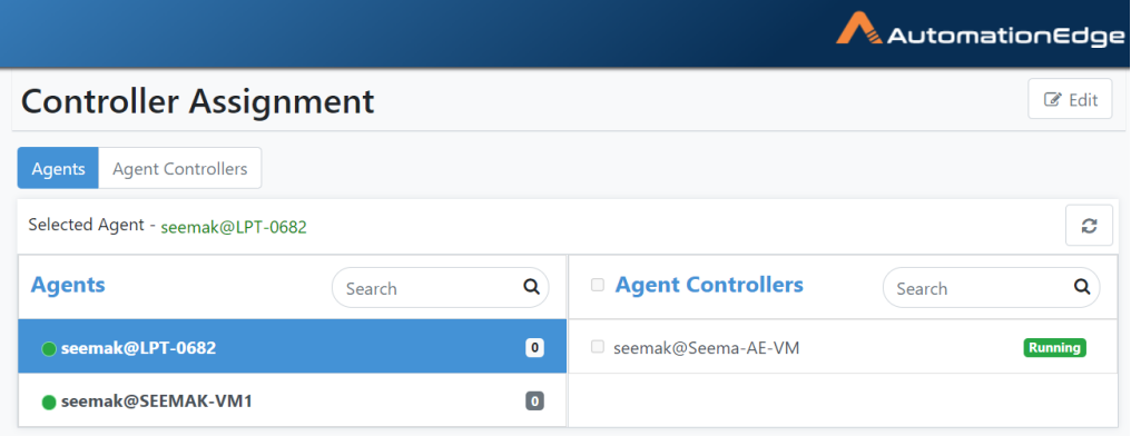

  1. In the menu, click Agents → Controller Assignment. The Controller Assignment page appears.
  2. By default, the Agents tab is active. Select an Agent from the list.
  3. Click the Edit button on the top right corner.

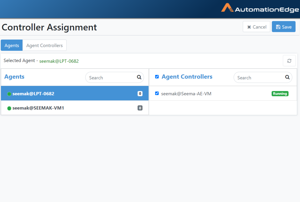

  4. Select one or more Agent Controllers by enabling the checkboxes in the Agent Controllers column on the right.

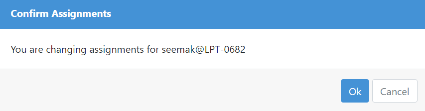

    Dialog
  5. Click Save to save the assigned Controllers to an Agent. Assignment saved successfully message appears.
