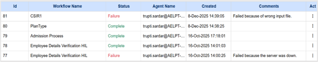

For Failed requests, the following options are available:
  • Restart Request: When you click Restart, the request is re-executed using the same request ID. To manually restart a request, see the Manual restart of requests or workflows section.
  • Resubmit Request: Click Resubmit Request to re-execute a failed request. For more information, see the Resubmitted section. When you click Resubmit, a new request with a new ID is created, helping maintain a clear history of actions.
  • Add Comment: The option is available only for failed workflows. Click Add Comment to log remarks or notes. A maximum of 512 characters is allowed. The comment can be entered only once and cannot be edited after saving. Only Admin and Workflow Admin users can add comments to a failed workflow. The comments appear in a separate column on the Requests page and are also included in the CSV file downloaded from the same page. The field is displayed only when a comment has been added. Display of add comment field feature is available from version 8.2.1 onward.

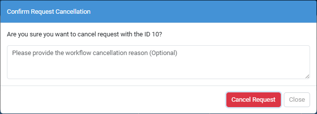

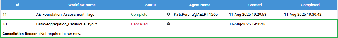

Cancel a new request
You can cancel a new request only before you log out of the instance.
To cancel a new request:
  1. Submit a new workflow execution request through Catalogue. The request appears in the Reqeusts page with status New.
    Execution Log
  2. Click Cancel. The Confirm Request Cancellation dialog appears.
    Cancel dialog
  3. Enter the reason for canceling the new request, and then click Cancel Request. The reason for canceling the request is saved.
