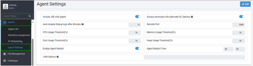

To configure the agent settings:
  1. In the menu, click Agents → Agent Settings. The Agent Settings page appears.
    Dialog
  2. Edit the setting details:
    Include JRE with AgentToggle the switch to include JRE with the agent during download.
    Always download with alternate GC OptionsToggle the switch and enable to download with alternate GC options.
    - If the user toggles the setting to enabled before downloading or registering the agent, then the new agent will have the GC options enabled by default.
    - The tenant level setting is only used while downloading a new agent from UI. Agents that are already downloaded or registered before changing the setting will not be impacted.
    Auto disable Debug logs after MinutesModify the time in minutes or hours after which the debug log download will stop automatically.
    - The Tenant level setting will override the selection in the Edit Agent dialog defined at the Agent level.
    - Default value for the setting is 30 minutes. Minimum value allowed is 15 minutes and maximum value allowed is 1440 minutes, that is, 24 Hours.
    - It is recommended that debug log be set for the shortest duration possible, as the logging can generate huge amount of information that will occupy a lot of disk space.
    Important: You can also set the logging level of your choice at the Agent level after making necessary additions or changes to the aeagent.properties file. For more details, see Set PS logging level in the Agent property file.
    CPU Usage Threshold(%)Configure the threshold for CPU usage. Notifications are sent if usage exceeds this value. The default is 60%.
    Memory Usage Threshold(%)Configure the threshold for memory usage. Notifications are sent if usage exceeds this value. The default is 60%.
    Disk Usage Threshold(%)Configure the threshold for disk usage. Notifications are sent if usage exceeds this value. The default is 60%.
    Heap Usage Threshold(%)Configure the threshold for heap usage. Notifications are sent if usage exceeds this value. The default is 60%.
    Enable Agent RestartSet using a toggle switch. Click to enable Agent Restart.
    Note: - Agent restart features are not supported on Linux based OS.
    - The Agent Restart Time field is available if you enable the field.
    Agent Restart TimeSchedule an agent restart time. This can be configured at the tenant level in this menu or on individual agents by editing the agent in the Agent List menu.
    JVM OptionsSettings that control the behavior and performance of the JVM when running the application.
  3. Click Save. Agent settings updated successfully message appears.
