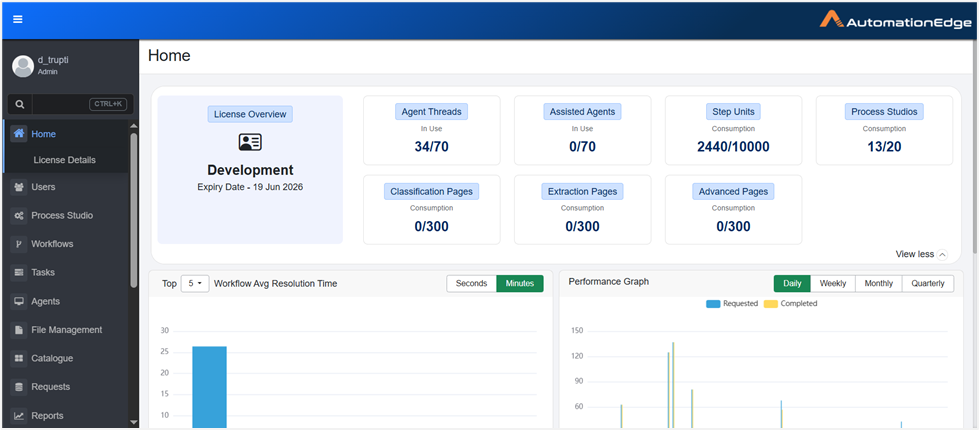

To view the Home page:
  1. In the menu, click Home. The Home page appears.
    home
    Figure: The Home page view
  2. On the page, you can see the following:
    • License Overview: Displays the type of license and expiry date of the license. Click in the License Overview tab and you are taken to the License Details page. For details about updating license, see Upload or update the license section.
    • Agent Threads: Displays the number of agent threads in use.
    • Assisted Agents: Displays the number of assisted agents in use.
    • Step Units: Displays the step units consumed.
    • Process Studio: Displays the number of Process Studio licenses used.
    • Classification Page: Displays the number of pages classified. When a document is classified with DocEdge, the Classification Page Count balance decreases by the number of pages classified.
    • Extraction Page: Displays the number of extracted pages. When data is extracted from a document with DocEdge, the Extraction Page Count balance decreases by the number of pages extracted.
    • Advanced Page: Displays classification and extraction of documents using generative AI.
The Classification Page Count represents the number of pages traversed to classify a document. Traversal for classification is considered page consumption. For example, to classify a document as an Aadhaar card, the system must read or traverse the document. The number of pages traversed during classification is deducted from the Classification Page Count balance. In the AE UI, you can view the balances for all three page counts. The number of pages consumed or deducted from the license balance is determined by the DocEdge plugin step. For more information, see the DocEdge Plugin Guide.

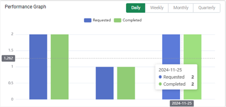

In the following section, you can view various charts and graphs that display the current AE engine status. You can hover over each view to see the details.
home1
Figure: Example: The detailed view after hovering the mouse over a chart

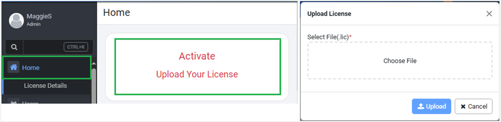

To upload the license:
  1. On the Home page, click Activate - Upload Your License tab. The Upload License dialog appears. home
    Figure: Home page -> Activate – Upload Your License tab -> Upload License dialog
  2. In the Select File(.lic)/*, click Choose File. The File Explorer opens.
  3. In the File Explorer, select the license, and then click Open. The file appears in the field.
  4. Click Upload. The license is uploaded and activated.

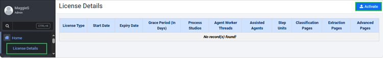

You can also upload the license through Home → License Details page → Activate.
home
Figure: Home -> License Details page -> Activate

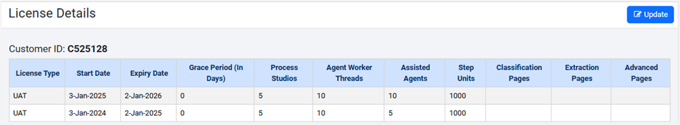

  1. On the Home page, click License Overview tab. The License Details page appears.
    home
    Figure: License Details page
  2. Click Update. The Upload License dialog appears.
  3. In the Select File(.lic)/*, click Choose File, and select the license from the File Explorer. The file appears in the field.
  4. Click Update. The license is updated and activated.

  1. In the menu, click Home → License Details. The License Details page appears.
  2. The following field details appear:
