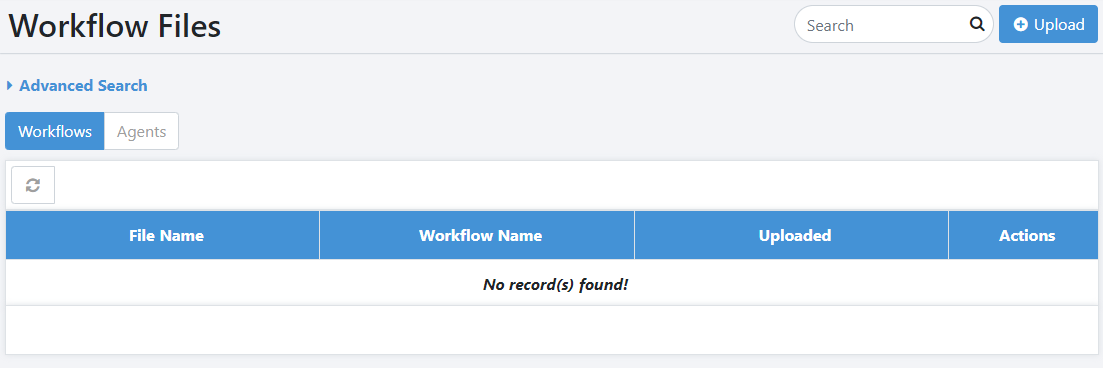

  1. In the menu, click File Management → Workflow Files. The Workflow Files page appears.
    FM page

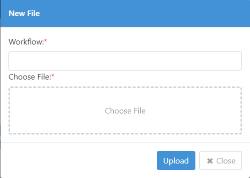

  2. In the Workflows tab, click Upload. The New File dialog appears.
    FM page
  3. Click in the Workflow* field. Select the workflow from the workflow list that appears.
    To select multiple workflows, select the respective workflow checkbox.
  4. Click Choose File. Select the file you want to upload.
  5. Click Upload. The selected workflow is uploaded and appears in the list on the Workflow Files page.

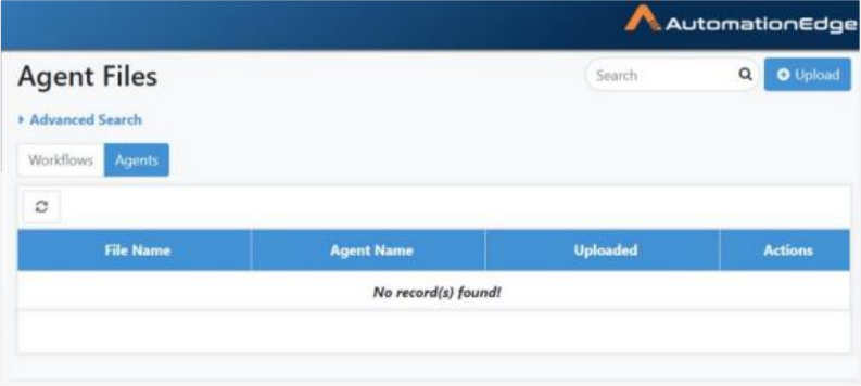

  1. In the menu, click File Management → Workflow Files. Click the Agents tab, the Agent Files page appears.
    FM page

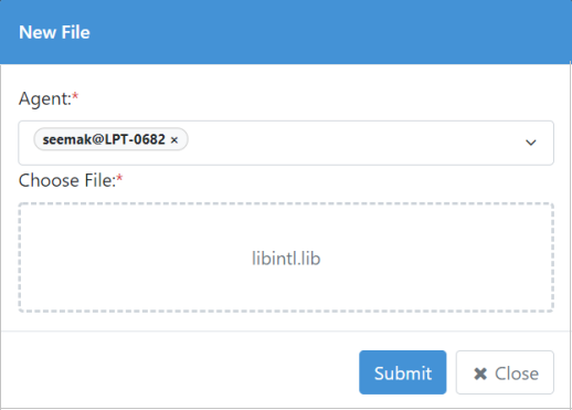

  2. In the Agents tab, click Upload. The New File dialog appears.
    FM page
  3. In the Agent field, select the agent from the list. The name of the selected agent appears in the box.
  4. Click in Choose File and browse for the file you want to upload. Click Submit. The uploaded file appears in the Agent Files list.

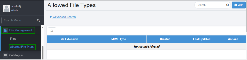

  1. In the menu, click File Management → Allowed File Types. The Allowed File Types page appears.
    FM page

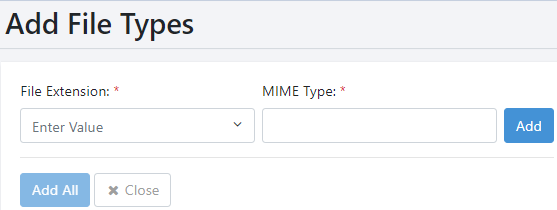

  2. Click Add. The Add File Types page appears.
    FM page
    File Extension*Enter the file type you want to add to the list.
    - You select a file extension.
    - You can select multiple file types.
    MIME Type*Enter the type of MIME you want for the file extension.
    For example: for extension .bmp the MIME Type is image/bmp.
    *Indicates mandatory field.
  4. Click Add. The extension list is created.
