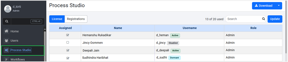

To download the Process Studio
  1. In the menu, click Process Studio. The Process Studio page appears.
    Process Studio
  2. On the page, click Download. The Process Studio for Windows is downloaded. For example, Process-Studio-AE_ORG.zip.

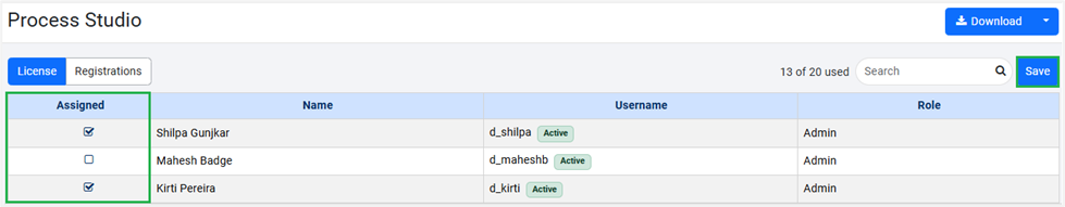

To assign a Process Studio license:
  2. In the License tab, click Update. The checkbox in the Assigned column becomes available for selection.
    Process Studio
  3. Click Save. The license is assigned to the selected users.

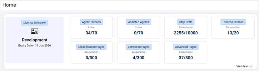

    You can see the number of licenses assigned or consumed on the Home page. Process Studio
    Figure 60: Process Studio licenses consumed view

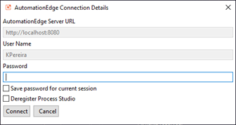

Open the Process Studio instance and provide the AutomationEdge Server URL, Username, and Password. See the following screenshot as an example:
register PS

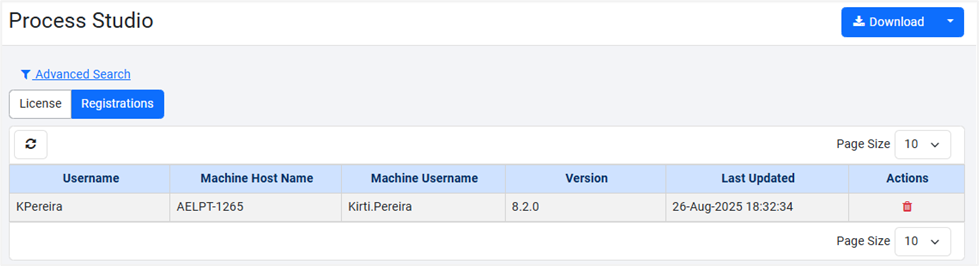

The newly registered Process Studio appears in the AE UI, Process Studio page.
Process Studio

  1. Deregister from Process Studio:
    i. Deregister during login
    Or
    ii. Deregister from Process Studio toolbar To deregister from Process Studio, see AutomationEdge Process Studio user’s guide.

Delete registration from AutomationEdge UI
In the Actions column, click delete to delete a Process Studio registration, and then click Ok in the Confirm delete dialog. The Process Studio registration is deleted and removed from the list.
After deleting a registration from AE UI, the user must log in with the deleted Process Studio to release the license. The deleted license appears disabled on the Process Studio page with Deleted marked next to it.
