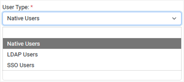

In the User Type* field, select the type of user you want to add.
Figure: Add New User page: User Type listClick the respective tab to learn more about each User Type:

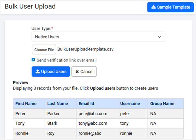

Edit the downloaded template and save the details. Go to the Bulk User Upload page in the application.
i. On the Bulk User Upload page, click Choose File. In the File Explorer dialog, select the template to upload.
Figure : Selected bulk user templateii. Select the Send verification link over email checkbox, if required. The users will receive an email notification after the details are uploaded.
NoteFor users to receive the email notification you must ensure that the email server is configured.
iii. View the preview details of the template you want to upload and then click Upload Users. In the Result section, the upload details appear.

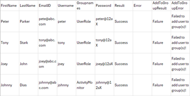

Figure: Bulk User Upload page view after uploading the templateNoteTo see the results of the bulk upload, view the BulkUseUpload-result file that is automatically downloaded to the system.
Figure: Bulk user upload result viewYou can view the details on the Tenant Users page.

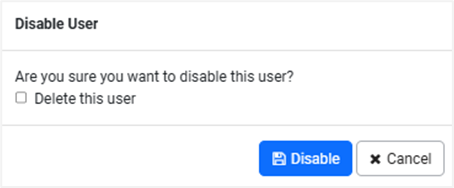

Disabled
A user can be manually disabled from Active, Enabled, or Locked states. If a user is disabled, their schedules get automatically disabled. A display message to show this warning is shown in the confirmation box for disabling users. On login, a disabled user gives a generic error message.

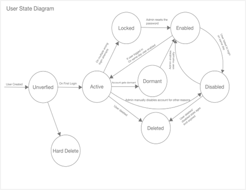

User states inter-relationships
The following screenshot depicts the inter-relationship between the user states:
Figure: User states inter-relationships representation

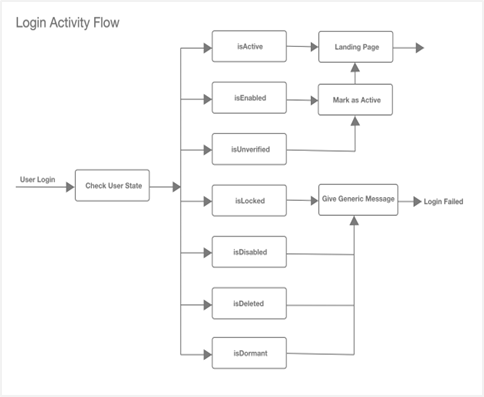

User state and login behavior
Additionally, to complement the previous User State interrelationship diagram, the following diagram illustrates the login behavior of users within various states. The following screenshot depicts the different user states:
Figure: User login activity
If user is in Active state, then after login, user goes to the AutomationEdge UI landing page.
If a user is in an Enabled or Unverified state, then after login, user account is marked as Active, and user goes to the AutomationEdge UI landing page.
If a user is in Locked, Disabled, Dormant, or Deleted state, then after login, a generic failure message appears.

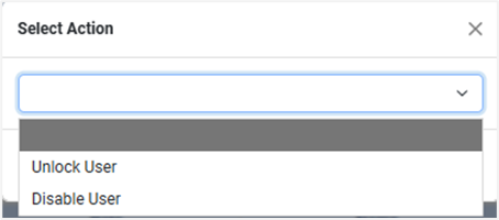

To change the state of any user, click the state link in the Status column complete the steps to change the user state.
Unlock user
You can unlock Admins and other tenant users.
To unlock a tenant user:
In the menu, click Users -> User List. The Tenant Users page appears.

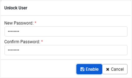

In the Status column, click the LOCKED link corresponding to the tenant user you want to unlock. A Select Action dialog appears.
In the dialog, select Unlock User and then click Next. The Unlock User dialog appears.
Figure: Enable User pop-up -
Enter the new password and confirm password. User unlocked successfully message appears and you are taken back to the login page.

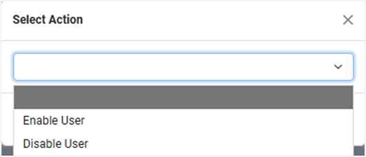

In the Status column, click the DORMANT Or DISABLED link corresponding to the tenant user you want to enable. A Select Action dialog appears.
Figure: Select Action dialog
In the dialog, select Enable User. The Enable User dialog appears.

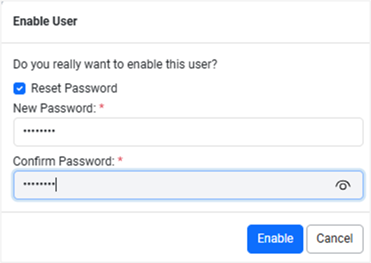

Click Enable. User enabled successfully message appears.
Select the Reset Password checkbox. The new password fields appear.
Figure : Enable User dialogEnter the new password and then click Enable. User enabled successfully message appears.
