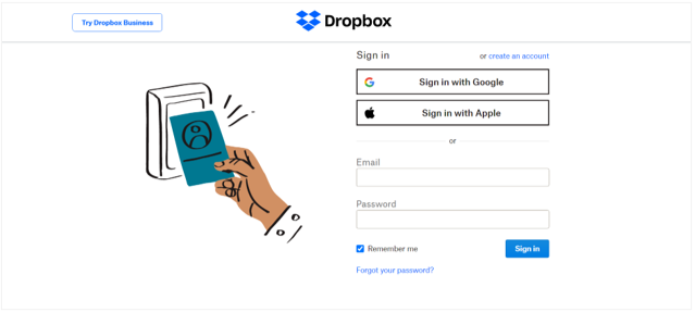

  1. Visit the Dropbox Apps registration portal using Developer's Portal.
  2. Sign in with Dropbox credentials.
    Dropbox1

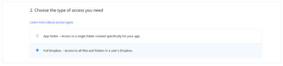

    ii. Select the type of access you need.
    Dropbox4

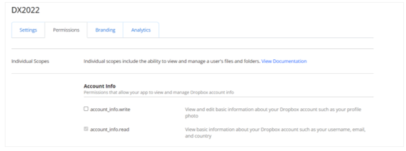

    v. To provide required permissions on App registration portal, click Permissions tab and provide the appropriate permissions defined in step documentation.
    Dropbox7

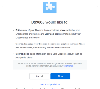

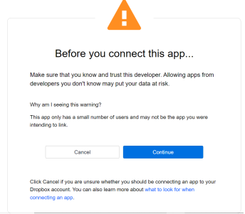

  2. Click Continue, and then click Allow.
    Dropbox9

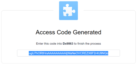

  3. Copy the authorization code from Access Code Generated.
    Dropbox10
    The authorization code is valid for short period of time.
