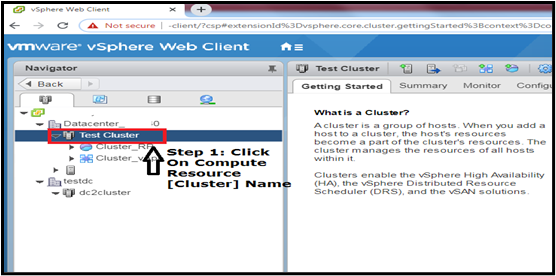

The following screen shots depict how to get the Compute Resource ID of a Cluster Resource Type. i. Select a cluster in the vSphere-vCenter as seen below.
vmWare

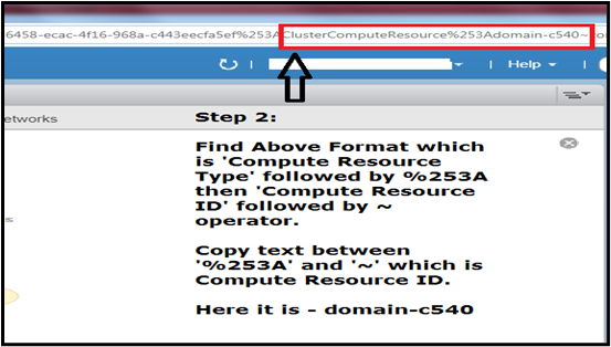

ii.Once the Resource Type i.e. Cluster in this case is selected scroll the URL address bar to locate the Resource Type (ClusterComputeResource in this case). Then pick the Resource ID in between %253A and a ~.
vmWare

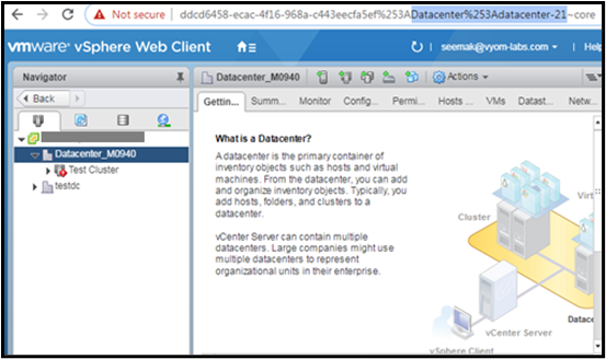

The following screen shots depict how to get the Target ID of a Datacenter Target Location Type. iii. Select a Datacenter in the vSphere-vCenter as seen below. iv. Once the Target Location Type, i.e. Datacenter in this case is selected scroll the URL address bar to locate the Target Location Type (Datacenter in this case). Then pick the Target ID in between %253A and a ~.
vmware

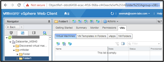

v. Similarly, once the Target Location Type i.e. VM Folder is selected scroll the URL address bar to locate the Target Location Type (Folder in this case). Then pick the Target ID in between %253A and a ~ as seen below.
vmware
