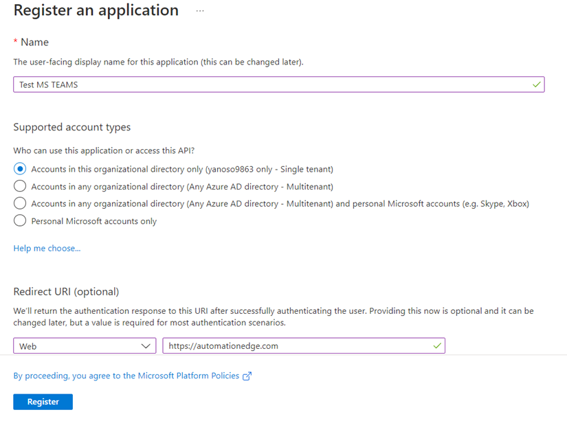

  2. Select the Azure Active Directory.
  3. Select App Registrations.
  4. Select New Registration.
  5. Name the application. Select a supported account type as Accounts in organizational directory only (…… - Single tenant), which determines who can use the application. Under Redirect URI, select Web for the type of application you want to create and provide valid URL.
    For example, https://automationedge.com
  6. Select Register.

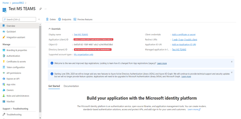

  1. Copy Client ID and Tenant ID.
Cilent ID is mandatory for personal account.

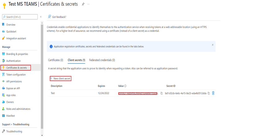

  1. Click Certificates and Secret, and then click New Client Secret and copy value of the secret.
The value is visible only once.

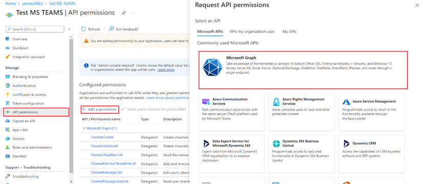

  1. Click API Permission, and then click Add Permission  Microsoft Graph.
  2. Provide all required permissions.

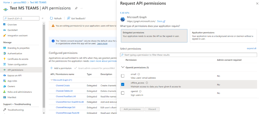

Provide the Grant admin consent for all permission using an admin account.
  1. Delegated offline_access permission is mandatory to generate the refresh token. To find the necessary permissions, see respective step documentation.

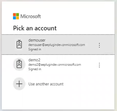

  1. After running the code in the browser the sign-in page appears. Enter the user details of the user who has created the app.

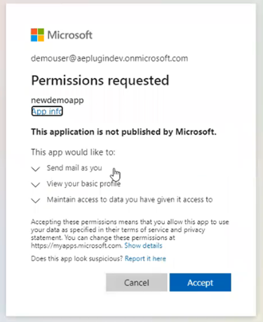

  1. After signing in the Permissions requested page appears. Click Accept.

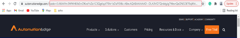

  1. After clicking Accept, user is redirected to the URI provided during app creation. After you are redirected, you get the code in the address bar of the browser.

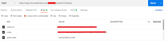

Redeem the code for access tokens and refresh token

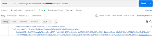

After you receive the code value, you can redeem the code for a set of tokens that allow you to authenticate with the Microsoft Teams API. To redeem the code, make the following request:
POST
https://login.microsoftonline.com/{tenant_id}/oauth2/v2.0/token
Headers:
Body: x-www-form-urlencoded
(key value pair) client_id={client_id} client_secret={client_secret} code={code} grant_type=authorization_code
Example: Postman Request:
Postman Response:
