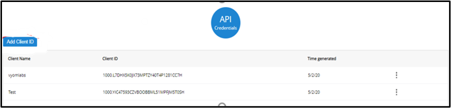

  2. Click Add Client ID.
alt text

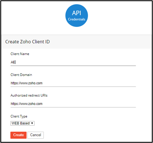

  1. Enter the following details:
• Client Name: The name of your application you want to register with Zoho
• Client Domain: The name of your domain to be used in URLs to identify your web page
• Authorized Redirect URIs: A valid URL of your application to which Zoho Accounts redirects you with a grant token(code) after successful authentication
alt text

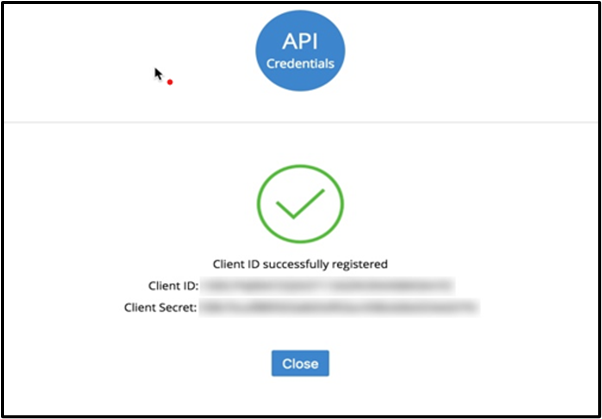

  1. Click Create. You will get Client id and Client Secret.
alt text

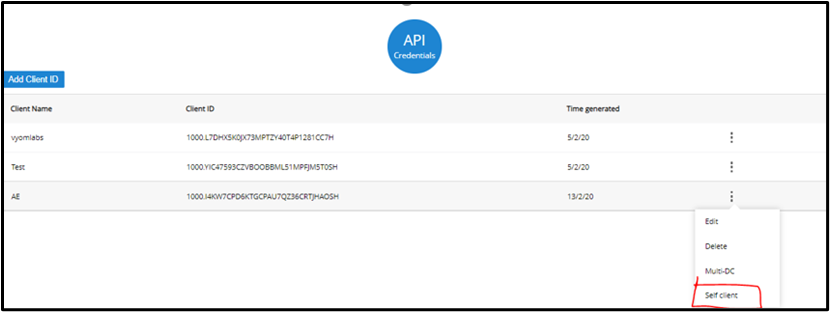

  1. Generating Grant Code: • Click Self Client.
alt text

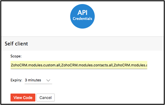

• Enter valid scope for the client. You can enter multiples scope for a client at a time. See the following link for more scope details. https://www.zoho.com/crm/developer/docs/api/oauth-overview.html#scopes
• Choose the expiry time from the drop-down. This indicates the time the grant token(code) is valid for.
• Click View Code to display the code. This is the Grant Token. Save this code and click Close.

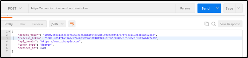

  1. Use this grant token to Generate Access and Refresh Tokens. • Open postman and create new Post request using following details URL : https://accounts.zoho.com/oauth/v2/token
Request Parameters
ParameterDescription
client_idSpecify the client-id obtained from the connected app.
client_secretSpecify the client-secret obtained from the connected app.
redirect_uriSpecify the Callback URL that you registered during the app registration.
codeEnter the grant token generated from the previous step.
grant_typeEnter the value as "authorization_code".
Response
alt text
• Each access token is valid for only an hour and used only for the operations defined in the scope.
• Refresh token does not expire. Use it to refresh access tokens when they expire.
• You can only generate a maximum of five refresh tokens in a minute.
• A "User" in an organization can have a maximum of 20 refresh tokens. And each refresh token can have a maximum of 30 active access tokens (non-expired).
• When a user creates a 31st access token, the system deletes the first created access token. Similarly, when the user creates the 21st refresh token, the system deletes the first created refresh token.
