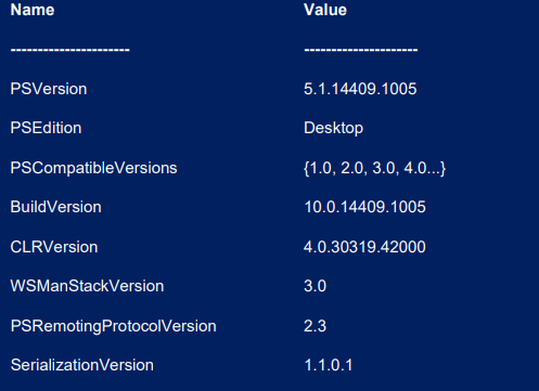

  2. Check if PowerShell version is updated to 5.1 using the following command:
    Command: $PSVersionTable
    Expected output:

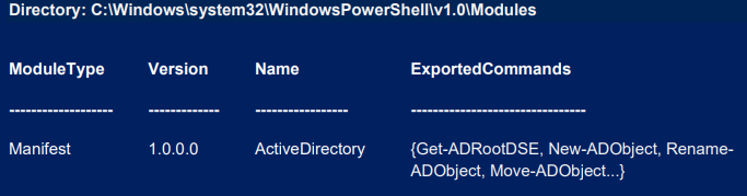

Module name: Active Directory Use the following command to check the available modules via PowerShell. Open PowerShell with Run as Administrator mode:
Command: Get-Module -ListAvailable -Name ActiveDirectory
Expected output:
AD-3

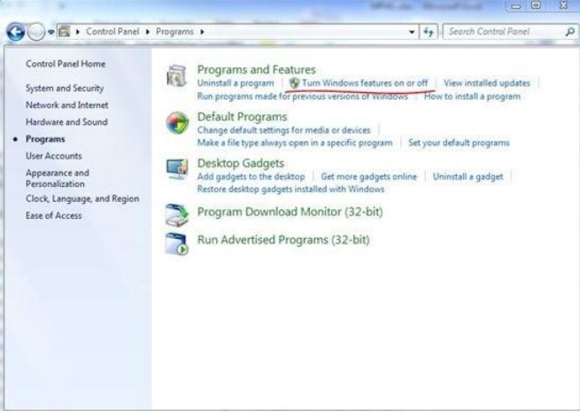

You must enable the tools that you want to use through the Control Panel. To enable the tools that you want to use: Click Start -> Click Control Panel -> Click Programs and Features -> Click Turn Windows features on or off.

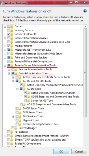

For RSAT on Windows Vista and Windows 7, you must enable the tools for the roles and features that you want to manage after you run the downloaded installation package.
You don't have to enable the tools for RSAT on Windows 8 or later versions.
To install Active Directory on Windows Vista and Windows 7, click Remote Server Administration Tools -> click Role Administration Tools -> check the AD DS and AD LDS Tools option -> click OK.

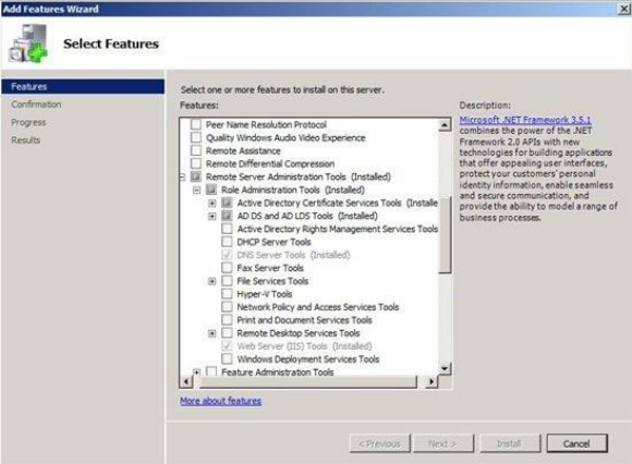

STEP 2: Enable tools
If you have to install management tools on Windows Server 2008, Windows Server 2008 R2, Windows Server 2012, or Windows Server 2012 R2 for specific roles or features that are running on remote servers, you don't have to install additional software. Start the Add Features Wizard in Windows Server 2008 or Windows Server 2008 R2 or the Add Roles and Features Wizard in Windows Server 2012 and later versions. Then, on the Select Features page, expand Remote Server Administration Tools, and then select the tools that you want to install. Complete the wizard to install your management tools.
AD-6
STEP 3: Confirm module availability
Use the following command to check available modules via powershell. Open PowerShell with run as Administrator mode:
Expected output:
AD-3
