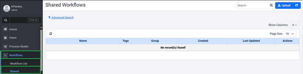

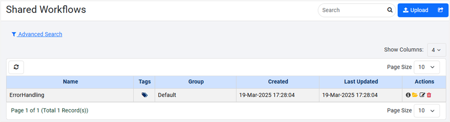

  1. Click Workflows → Shared. The Shared Workflows page appears.
shared
Figure : Shared Workflows page

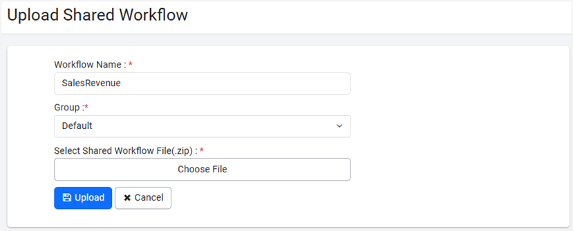

  1. In the Shared Workflows page, click Upload. The Upload Shared Workflow page appears.
    shared
    Figure : Upload Shared Workflow page
Workflow Name*Enter the name of the workflow that you want to share.
Group*Select the group that you want to share the workflow with.
Select Shared Workflow File(.zip)*Select the file from the folder where the downloaded workflow is saved.
* Indicates mandatory field.
  1. Click Upload. The shared workflow file is uploaded to AEUI.
    SHARED

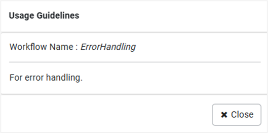

  • Click SHARED to view the usage guidelines.
    SHARED
    Figure : Usage Guidelines dialog

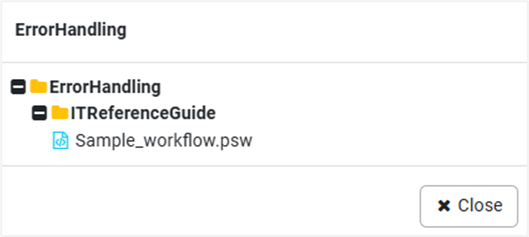

-Click SHARED to view the shared workflow files.
SHARED
Figure: Shared workflow files view

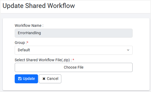

  • Click SHARED to edit the shared workflow details.
    SHARED
    Figure: Update Shared Workflow page

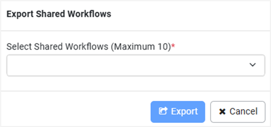

  2. On the page, click SHARED . The Export Shared Workflows dialog appears.
    SHARED

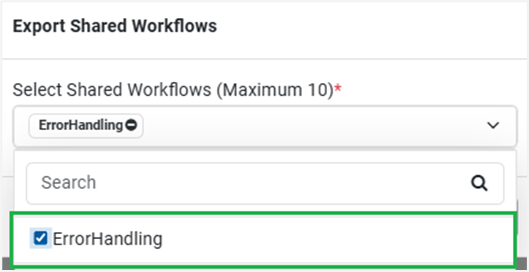

  3. Click in Select Shared Workflow (Maximum 10) *. A list of shared workflows appears.
    SHARED
    Figure : Update Shared Workflow page
  4. Select the checkboxes next to the workflows that you want to export, and then click Export. The workflow is downloaded to your system.

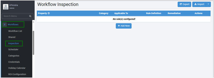

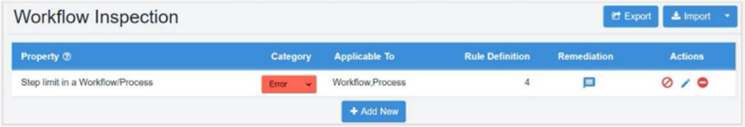

  1. Click Workflows 🡪 Inspection. The Workflow Inspection page appears.
    Inspection

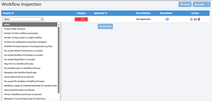

  2. Click Add New. A workflow inspection rule row is added.
    addNew
PropertySelect the rule that you want set for the workflow or process.
Note: Click to view the complete list of rules that you can select.
CategorySelect if you want to configure the rule as an error or warning.
Note: User will be unable to publish the workflows or processes through Process Studio, if the category is set to Error.User will be able to publish the workflows or processes with warnings through Process Studio, if the category is set to Warning.
Applicable ToSelect if the rule will be applicable to project and / or workflow and / or process and / or step and /or entry.
Rule DefinitionEnter the value for defining the rule.

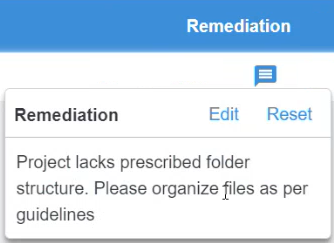

RemediationClick and view the details of the rule. You can modify or reset the rule details, if required.
- To change the remediation details, click Edit. Make the required changes and click Save. The updated details are saved.
- To reset the changes, click Reset. The changes are removed, and the previous remediation appears.
To add more rules, click Add New. A new row appears on the page. You can add multiple rules for a project or workflow or process or step or entry.
  1. In the Actions column, click alt text . The rule details are saved.
In the Actions column:
  • After saving the rule the icon changes to alt text (Edit). Click to modify the rule details.
  • To disable the rule, click alt text to disable the rule. The disabled rule will be unavailable in the Process Studio.
  • To delete a rule, click alt text . The rule is deleted.
If you comment the Alert method (//Alert () ) in the Modified JavaScript step, then the workflow will not validate the alerts even if Alert inspection rule is configured in the AEUI. For details about using the Inspection Rules in Process Studio, see Standard Plugin Guide.

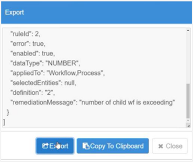

To export an inspection rule:
  1. If you want to use the rules again for other tenants, click Export. The Export dialog appears.
Figure: The Export dialog
  1. In the Export dialog, the details appear:

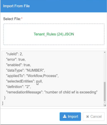

  • Click Export. The rules are saved as JSON. OR
  • Click Copy To Clipboard. Paste the rules in appropriate editor and save it as JSON or in the Import dialog.

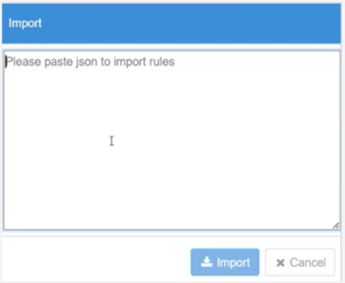

  1. Click Import. The Import dialog appears.
    Figure: The Import dialog
  2. Paste the rules in JSON format in the Import dialog, and then click Import. The rules appear in the Workflow Inspection page. OR Click the dropdown next to Import, and then click Import From File. The Import From File dialog appears.
Figure: The Import From File dialog
  1. In Select File, upload the JSON, which contains the rules, and then click Import. The rules appear in the Workflow Inspection page.

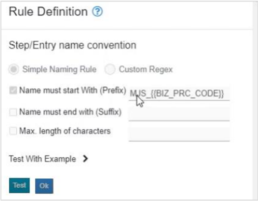

  • Rule Definition: click Edit Rule. In the Rule Definition dialog, enter the following field details:
The fields in the dialog are dependent on the selection in the Applicable To field.
Figure: The Rule Definition dialog
Step/Entry name convention: Select Simple Naming Rule.
If you select Custom Regex, then go to https://www.regexplanent.com/advanced/ java/index.html for guidance on naming convention in regex.
  • Select the checkbox against respective fields: Name must start With (Prefix): Enter the prefix you want. For example, MJS_{{BIZ_PRC_CODE}}. Name must end with (Suffix): Enter the suffix you want. For example, {{BIZ_PRC_CODE}}_END.
  • Max. length of characters: Enter maximum length of the name. For example, 15 characters.
  • Test With Example: Enter sample names to test the rule. Click Test. The sample name will be validated for the rule. OR
  • Click Ok. The rule is saved.
