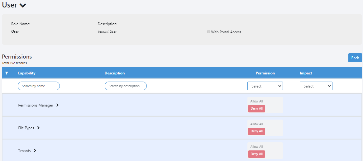

View role permissions
To view role permissions:

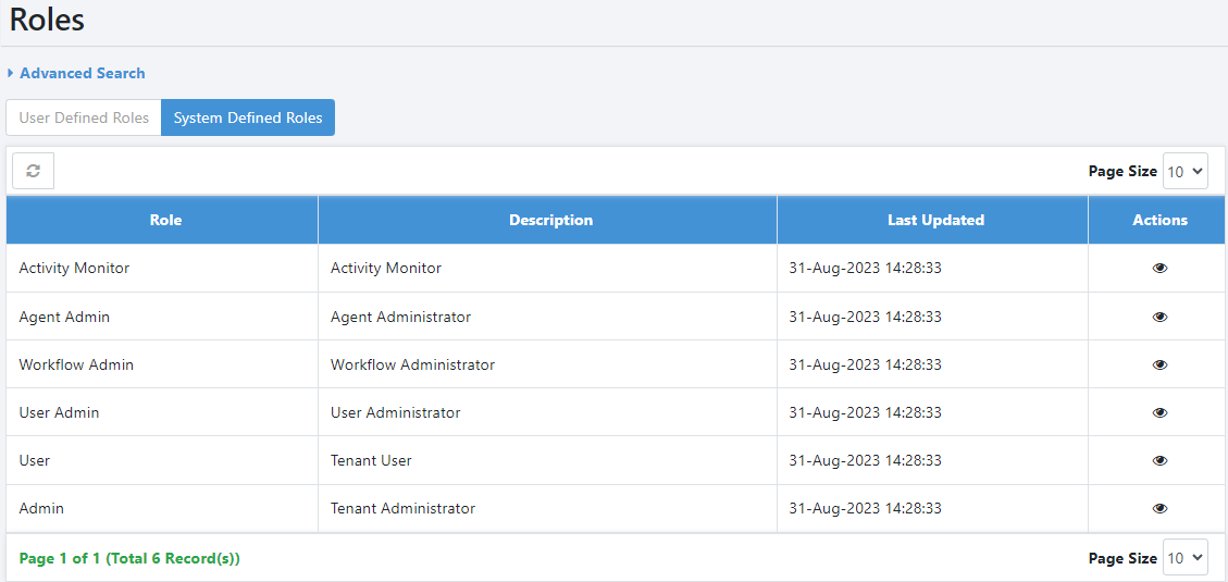

In the menu, navigate to Roles. The Roles page appears.
Click System Defined Roles tab. The list of roles appears.
- Click
. The selected role's permission details page appears. For example, if you select User, the permission page appears as follows:
- The following details are available:
| Field Name | Description |
| Role Name | Displays the name of the role. |
| Description | Displays the description of the role. |
| Web POrtal Access | Displays the selected checkbox. |
| Note: If the checkbox is selected, then users can sign in to AEUI with both, API and UI access. Else, the user will have only API access to allowed modules. | |
| Permissions | |
| Capability | Displays the name of capability that the role is assigned with. |
| Description | Displays the description of the capability. |
| Permission | Displays the permission granted for a capability or sub-capability assigned to the role. |
| Permission values are: Allow or Deny. | |

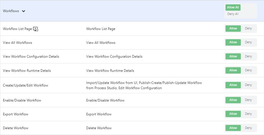

| Note:To view the permission at capability or sub-capability level, click each capability: | |
| - If each sub-capability has either Allow or Deny, then at the Capability level the permission is seen as, Allowed All or Deny All. For example, | |
| - If the permission at sub-capability level is a mix of Allow and Deny, then neither Allow All or Deny All is selected at the Capability level. For example, | |
| Impact | Displays the impact of the assigned capability. Impact values are: High or Medium. |
| High: Permissions impacting the business highly. For example, permission to delete a tenant. | |
| Medium: Permissions impacting the business, but at the user level in a tenant. For example, permission to enable or disable the workflows. |
You can search for a capability by providing the name of the capability or description. You can also filter the view based on permission and / or the impact.

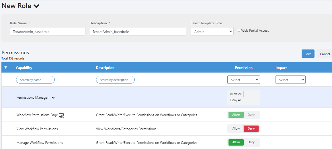

You can create new roles. The roles can be based on the system defined roles, which will have same set of permissions. However, you can modify the permissions. Or, you can create a completely new role to which you can assign the required permissions.
To create new roles

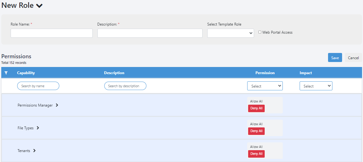

In the User Defined Roles tab, click New Role. The New Role page appears.
- Enter the following field details:
| Role Name | Enter a name for the role you want to create. |
| Description | Enter a description of the role. |
| Select Template Role | Select the role based on which you want to create the new role. Available options are: |
| - Admin | |
| - Activity Monitor | |
| - Agent Admin | |
| - User Admin | |
| - User | |
| - Workflow Admin | |
| Web Portal Access | Select the checkbox to allow users to sign in to AEUI with both, API and UI access. |
Note: If the checkbox is clear, then the user will have only API access to allowed modules and will be unable to access the UI pages. For example, see the followin screenshot: ![]() | |
| You will be unable to modify the permission of the Workflow Permissions Page, which is accessed through the UI However, you can modify permissions of other sub-capabilities that can be accessed through the API | |

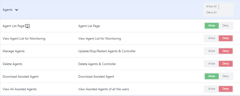

| Permissions | Note: If you select the system defined role for creating the new role, then by default all the system defined role's permissions are assigned to the new role. However, you can modify the permission details. |
| Capability | Displays the name of capability that you can assign to the role |
| Permission | Displays the permission available for each capability. If you want to assign complete permissions to a capability, click Allow All. Else, click on the capability and provide permission at sub-capability level. ![]() |
| Similarly, you can deny permission at the capability or sub-capability level. | |
| Impact | Displays the impact of the assigned capability. |
| Impact values are: High or Medium. | |
- Click Save. The new role details are saved.
