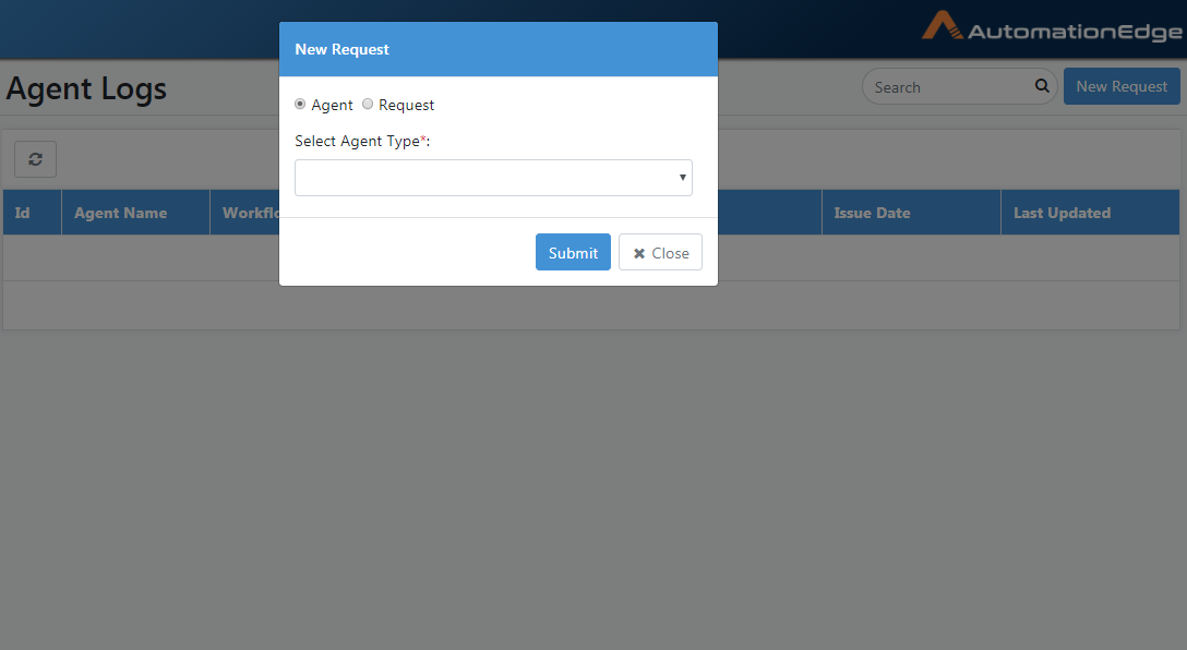

- Click New Request on the top right corner. A pop-up box appears. You may submit a new request for Agent or Workflow Requests.
Figure 13.5: Select Agent Log Entity

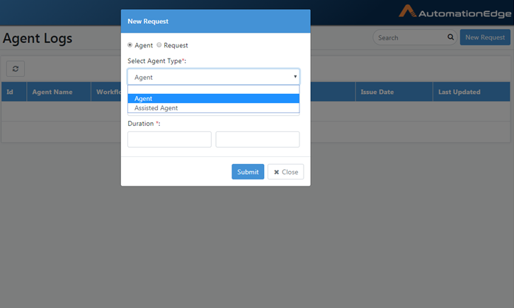

- The Agent radio button is selected; now select Agent Type.
Figure 13.6: Select Agent Type

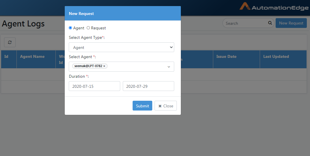

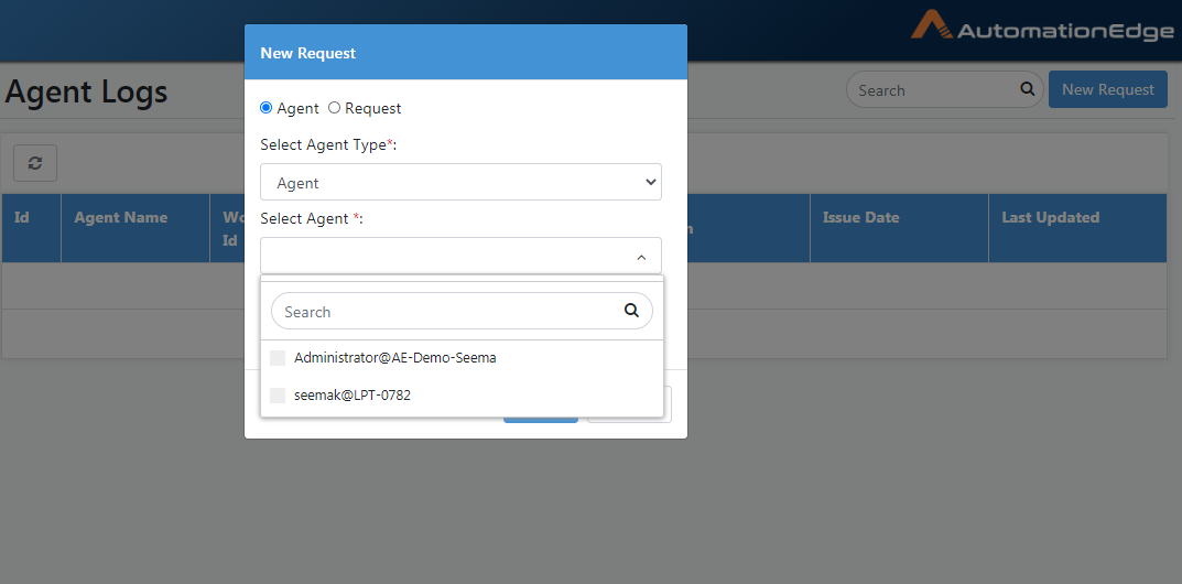

- Depending upon the Agent type, a list of Agents appears. Enable checkbox next to Agent or Agents for which you want to download the Agent logs.
Figure 13.7: Select Agent
- Select the period for which you want the logs.
Figure 13.8: Select From-To Dates
- Click Submit.
Figure 13.9: Select From-To Dates

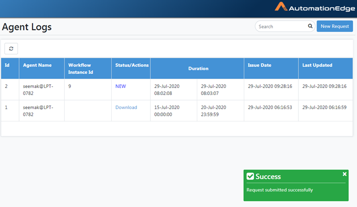

Provide appropriate duration with the difference in duration, not more than five days. Click Submit. A 'Request submitted successfully message' displays
Figure 13.10: Agent Logs request

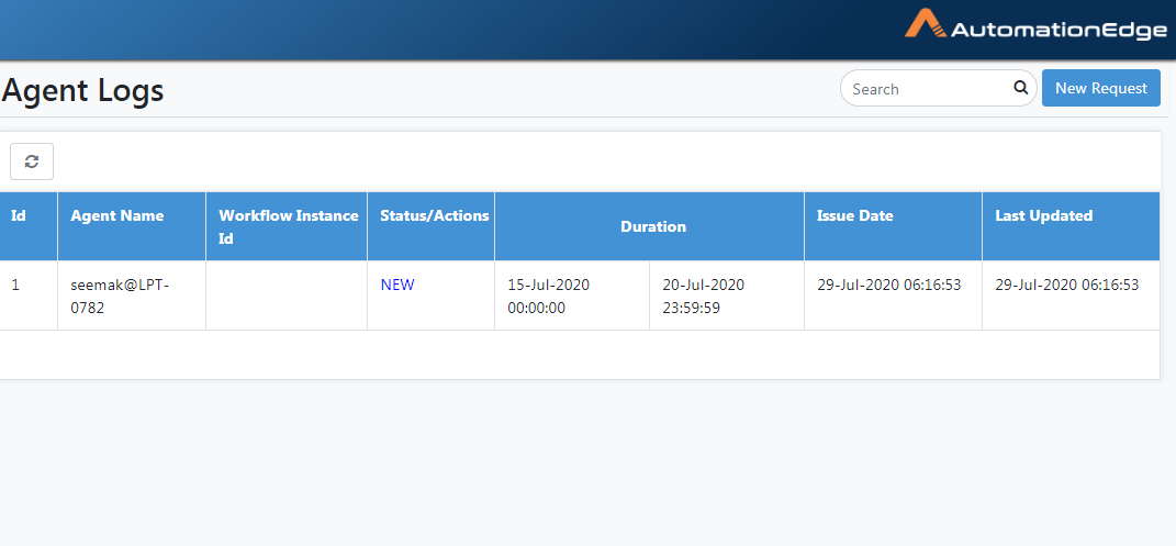

- A new entry in the Agent Logs with Status NEW appears.
Figure 13.11: Agent Log with status NEW

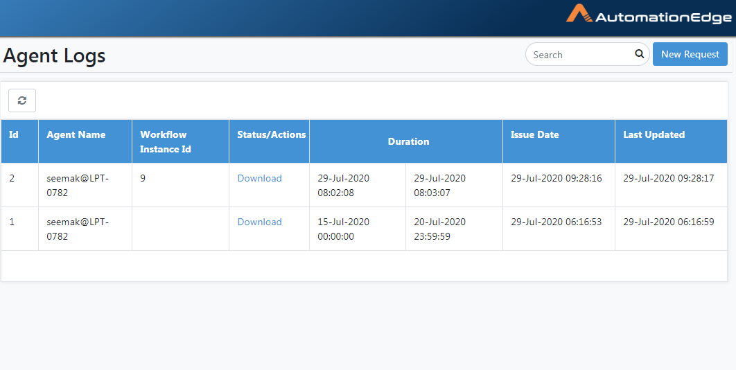

After some time, the status changes to Download.
You may click Download to download a zip of the Agent log files.
Figure 13.12: Agent Logs Download with Download Link

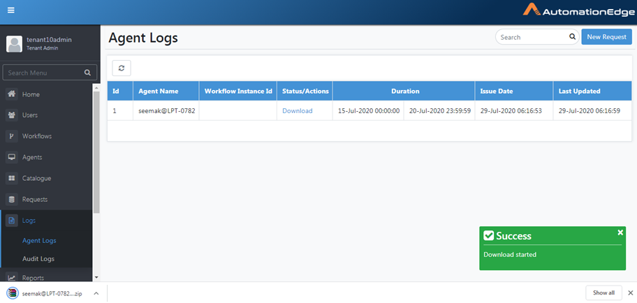

- The following snapshot shows the Agent log downloaded for Id 4.
Figure 13.14: Agent log download started

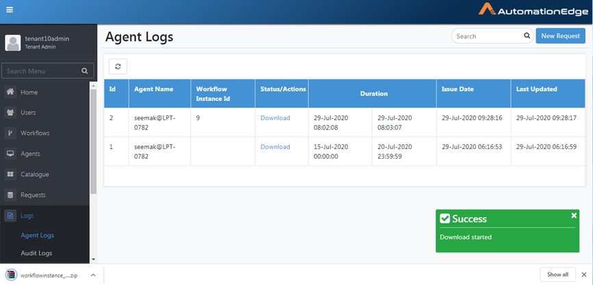

- The status changes to Download. Click the Download link.
Figure 13.20: Agent Log with Download Link
- It downloads a zip file, as seen below.
Figure 13.21: Agent Log Zip by Request Id

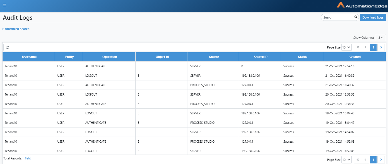

View Audit Logs in the Logs menu.
- Click Logs menu and Audit Logs sub-menu. You can see a listing of Audit logs. The table below describes the columns.
Figure 13.23: Audit Logs

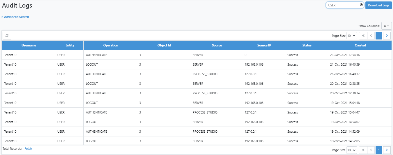

Type a string in the search box on the top right corner to filter records.
Type SYSTEM in the Search Box. Records with operation SYSTEM are filtered, as seen below.
Figure 13.24: Filtered Search Results

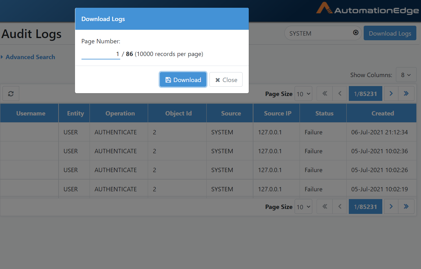

- On the Agent Logs menu, click Download Logs Button at the top right corner.
Figure 13.25: Download Audit logs
- Alternatively, you may put a filter text as shown below. You can now see the filtered records. Click Download logs.
Figure 13.26: Filter and Download Logs Audit
- Specify the Page Number to download.
Figure 13.27: Select Page Number
A Success message appears showing Audit Logs download started and a .csv file opens.
The Audit log file is downloaded into the file system.
