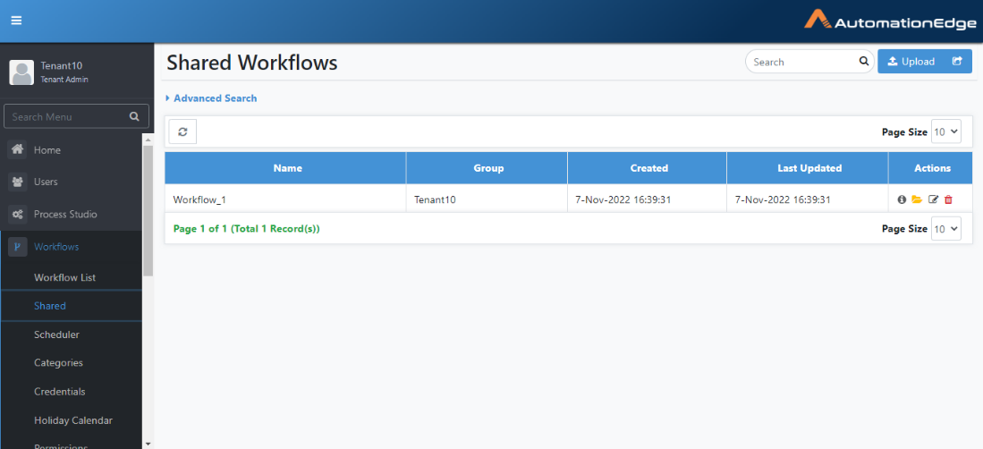

Workflow → Shared is used for sharing workflows with users of a tenant. When users share workflows, which allows other users of the tenant to reuse the workflows in their projects.
Users with role Tenant Admin and Workflow Admin will have option to upload/update such shared workflow zip on AE Server. For more information on Shared Workflows, see the AutomationEdge R7.7.3 Process Studio User Guide. The shared workflows are available to the users in the Shared Workflows tab in the Process Studio. Only a tenant with TRIAL/DEVELOPMENT/UAT/CONSUMPTION license type can upload the Shared Workflow zip.

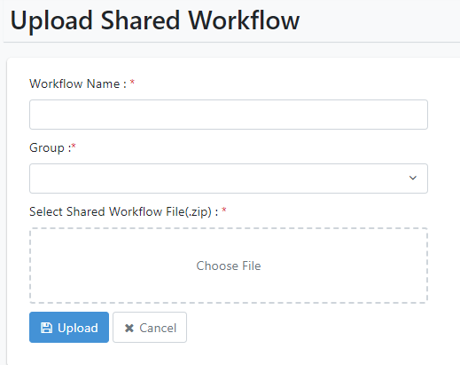

  1. Click the Workflows menu. Click Shared sub-menu.
  1. In the Shared Workflows page, click Upload. The Upload Shared Workflow page appears.
  1. The table below describes the fields.
Field NameDescription
Workflow NameSpecify the name of the workflow that you want to share.
GroupSelect the group that you want to share the workflow with.
Select Shared Workflow File(.zip)Select the file from the folder where the downloaded workflow is saved.
  1. Click Upload. The shared workflow file is uploaded to AEUI.

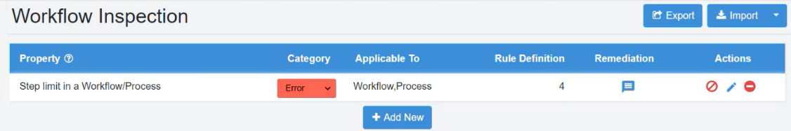

  1. Click Workflows 🡪 Inspection. The Workflow Inspection page appears.
PropertySelect the rule that you want set for the workflow or process. Note: Click to view the complete list of rules that you can select.
CategorySelect if you want to configure the rule as an error or warning. Note: User will be unable to publish the workflows or processes through Process Studio, if the category is set to Error.User will be able to publish the workflows or processes with warnings through Process Studio, if the category is set to Warning.
Applicable ToSelect if the rule will be applicable to project and / or workflow and / or process and / or step and /or entry.
Rule DefinitionProvide the value for defining the rule.

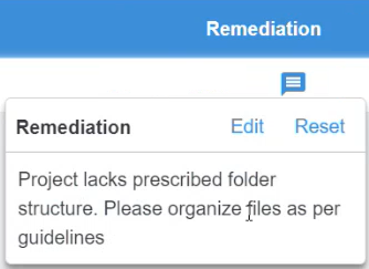

RemediationClick and view the details of the rule. You can modify or reset the rule details, if required.
ActionsClick the following tools:
- : Click to disable the rule. The disabled rule will be unavailable in the Process Studio.
- : Click to save the rule. After saving the rule the icon changes to (Edit). Click to modify the rule details.
- : Click to delete the rule.
  1. To add more rules, click Add New. A new row appears on the page.
You can add multiple rules for a project or workflow or process or step or entry.
  1. Click . The rule details are saved.

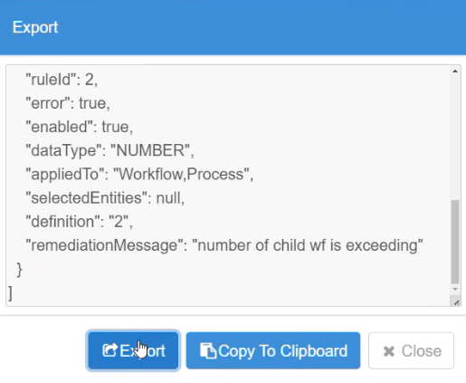

  1. If you want to use the rules again for other tenants, click Export. The Export dialog appears.
  1. In the Export dialog:
  • Click Export. The rules are saved as JSON.
  • Click Copy To Clipboard. Paste the rules in appropriate editor and save it as JSON or in the Import dialog.

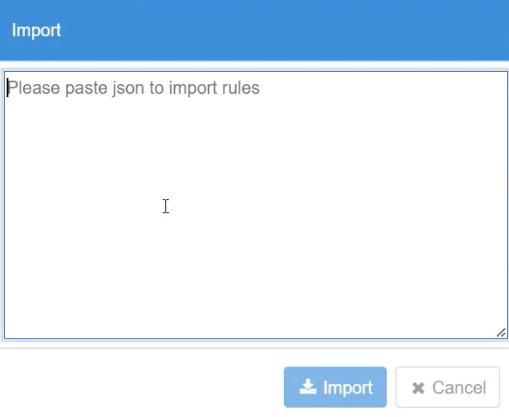

  1. Click Import. The Import dialog appears.
  1. Paste the rules in JSON format in the Import dialog, and then click Import. The rules appear in the Workflow Inspection page.
Click the dropdown next to Import, and click Import From File. The Import From File dialog appears.
  1. In Select File, upload the JSON, which contains the rules, and then click Import. The rules appear in the Workflow Inspection page.
