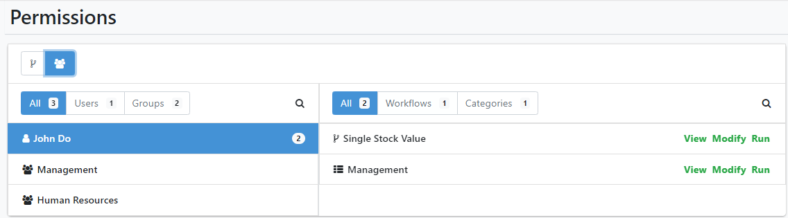

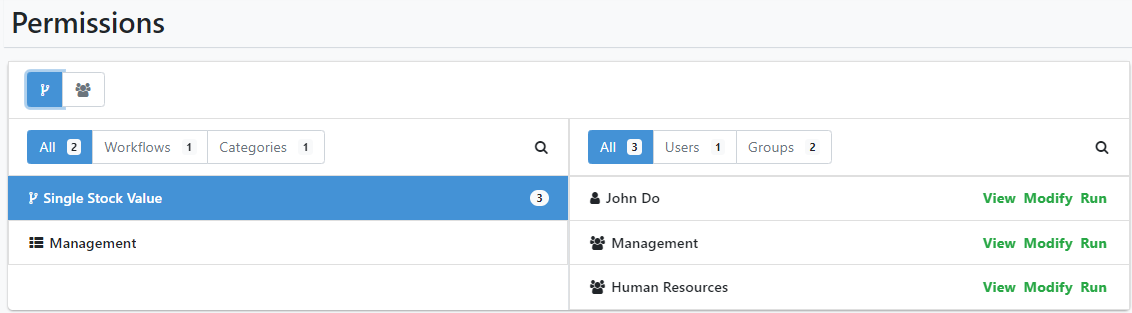

  1. Click Permissions 🡪 Workflow Permissions. The Permissions page appears.
Figure 12.1: Permission page
  1. Click Workflows tab, and in the section, select All or Workflows or Categories sub-tab. Respective tabs lists the following:
    a. All: Lists all workflows and categories.
    b. Workflows: Lists all workflows.
    c. Categories: Lists all categories.
  2. Select the workflow or category for which you want to assign permissions to users or groups.
    NOTE: To view the list of disabled workflows along with active workflows, select the Show Disabled Workflows checkbox.
  3. In the right section, select All or Users or Groups tab. You will see the following under each tab:
    a. All: Lists all users and groups.
    b. Users: Lists all users.
    c. Groups: Lists all groups.
  4. In the Assigned Permission column, select the permission you want to assign to the user and / or user group for the selected workflow or category. Available options are View, Run, and Modify.
In the Computed Permission column, view the maximum permissions assigned to the users or user groups or categories or workflows.
  1. Click Save. The permissions are saved successfully.

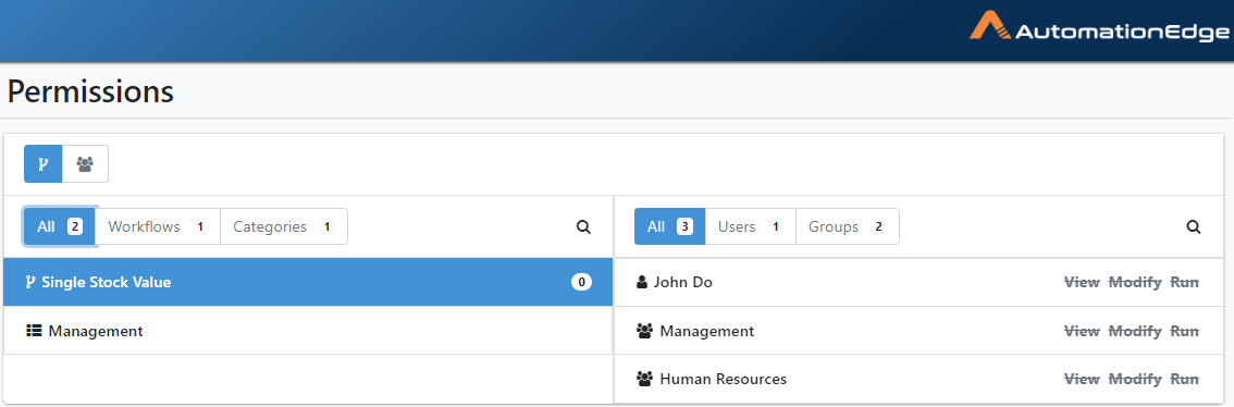

Figure 12.2: Permissions page
Click User View ( ) to similarly assign permissions to the users or groups for workflows and categories. To remove the permissions to a categories and / or workflows, click the respective permission. The permission is struck out and greyed indicating that the permissions are removed. required. Permissions:
  • View: Allows users only to view the workflows.
  • Modify: Allows users to view and edit the workflows.
  • Run: Allows users to view and execute the workflows.

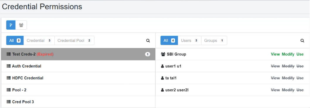

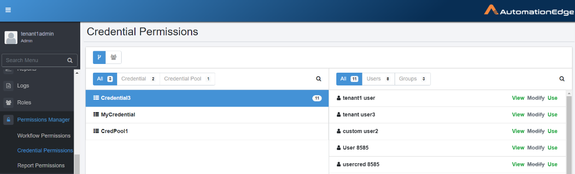

  1. Click Permissions 🡪 Credential Permissions. The Permissions page appears.
  1. Click Credential View ( ), and in the section, select All or Credential or Credential Pool tab. You will see the following under each tab:
    a. All: Lists all credentials and credential pool.
    b. Credential: Lists all credentials.
    c. Credential Pool: Lists all credential and credential pool.
  2. Select the credential or credential pool to which you want to assign permissions to users or groups.
  4. In the Assigned Permission column, select the permission you want to assign to the user and / or user group for the selected credential or credential pool. Available options are View, Use, and Modify.
In the Computed Permission column, view the maximum permissions assigned to the users or user groups or credential or credential pool.
Only those credentials or credential pool to which the user has View and Use permissions will be available in the Workflow and Catalogue menu.

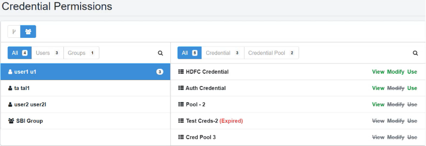

Click User View ( ) to similarly assign permissions to the users or groups for credentials and credential pool. To remove the permissions to a credential and / or credential pool, click the respective permission. The permission is struck out and greyed indicating that the permissions are removed Permissions:

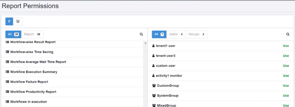

For OOTB reports, you can grant only the Use permission.

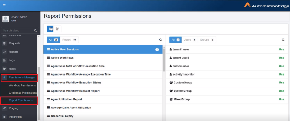

To grant report permissions to users and / or user groups:

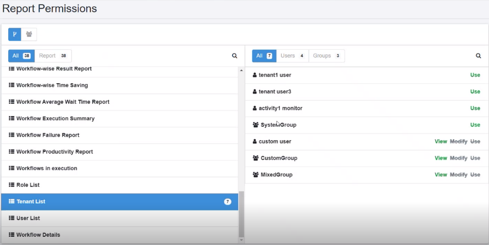

  1. In AE, go to Permissions Manager 🡪 Report Permissions. The Report Permissions page appears.
  1. In the Report Tab all reports, custom and OOTB, appear in the left pane. The users and user groups appear in the left pane.
To change the view, click the User Tab , users and user groups will appear in the left pane, and the reports will appear in the right pane.
  • All: all users and user groups appear in the list.
  • Users: all users under the tenant appear in the list
  • Groups: all user groups under the tenant appear in the list.
  • : indicates that the user is member of a group.
  1. In the reports list, select the report to which you want to grant permission, and in the left pane, select the users and /or user groups.
Permissions:
  • View: Allows users to view template details in a read only mode.
  • Modify: Allows users to view, edit, and delete the template.
  • Use: Allows users to create reports using the template.
  1. In the Assigned Permission column, select the permission you want to assign to the user and / or user group for the selected workflow or category. Available options are View, Run, and Modify.
In the Computed Permission column, view the maximum permissions assigned to the users or user groups or reports.
  1. In the right pane, click the permission you want to grant. The selected permission is assigned.
Custom Report permission view
OOTB Report permission view
To remove the permissions granted to users and / or user group, click the respective permission. The permission is struck out and greyed indicating that the permissions are removed.
