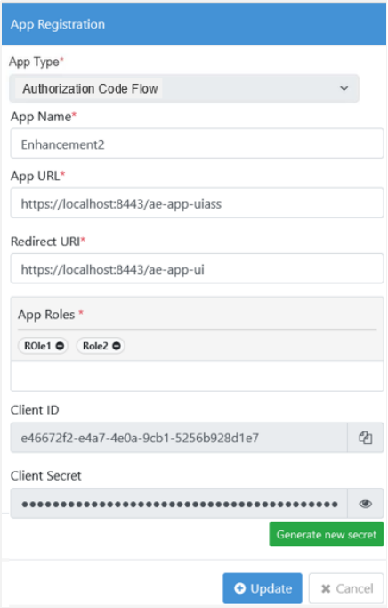

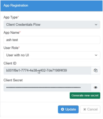

  1. Click Add. The app is registered and the AE server will generate an app ID and password.
App Type is Client Credentials Flow
App Type is Authorization Code Flow
You must save the client ID and client secret, as you will require the details to use the registered AE app.
To view the app secret, click the Eye icon. To copy the app ID and app secret, click the Copy icon. To generate a new password for the AE app, click Generate new secret. The Tenant Admin can register multiple AE apps.

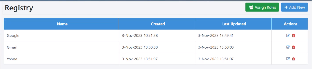

  1. Click Update. The registered AE app, appears on the Registry page.
In the Actions column:
  • To modify the app details, click Edit.
  • To remove the registered app, click Delete.

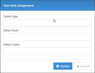

To assign roles to AE users:
  1. On the Registry page, click Assign Roles. The User-Role Assignment dialog appears.
Field NameDescription
Select AppSelect the app to which you want to assign the AE user.
Select Role*Select the role that you want to assign to the AE user.
Select UsersSelect the AE users to which you want to assign the AE app role.
  1. Click Update. The role is assigned to the AE user.
You can assign the app role to multiple AE users.

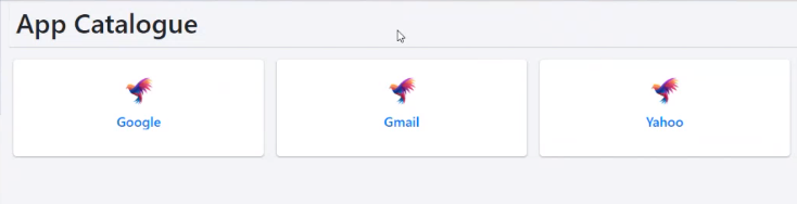

App Catalogue
Use the App Catalogue to view and access the registered AE app.
Only those AE apps whose App Type is Authorization Code Flow, appear in the App Catalogue.
To access the AE app:
You can access the app in any of the following ways:
  • Sign in to AE, and go to AE Apps App Catalogue. You will see the AE apps assigned to the user.
    Click the app tile. You will see the app's sign-in page.
