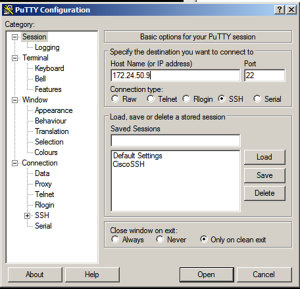

  1. Use Putty to connect to CISCO Switch.
  2. Provide the given IP Address and Port and click on Open.
  3. After clicking on Open, it will prompt for Security Alert, click on "Yes".

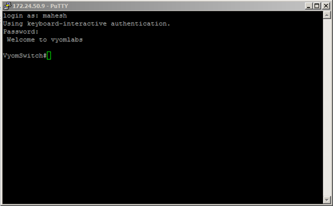

  4. The console will ask you to enter the username and password by which you have to login to the Switch. Enter the provided username and password.
  1. It will prompt for "VyomSwitch#", you can start writing your commands after #.
