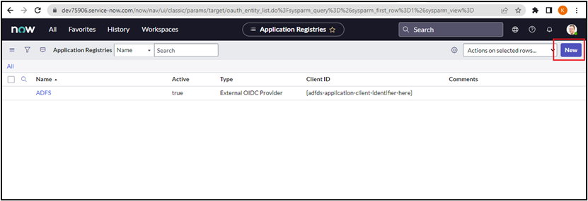

  2. Navigate to System oAuth  Application Registry.
alt text

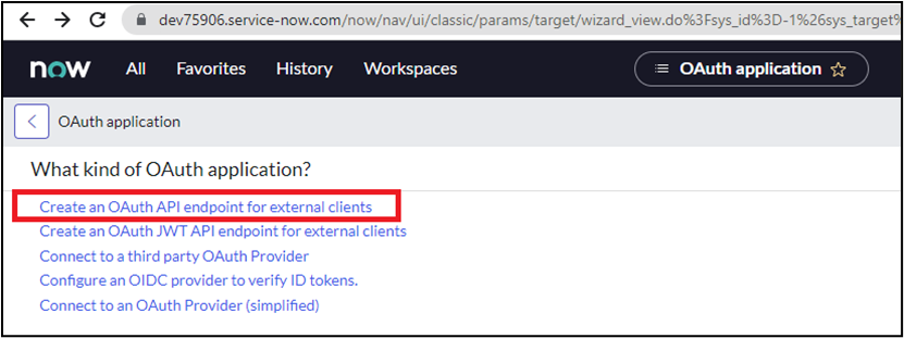

  1. Click New. The OAuth application page appears.
  2. Choose Create an OAuth API endpoint for external clients.

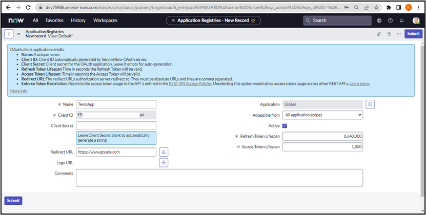

  1. Provide valid values of Name, Redirect URL, etc.
alt text
Client Secret is automatically generated after you click Submit button.
  1. Click Submit.

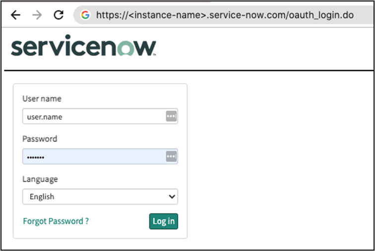

  1. The user is redirected to the oauth login page: /oauth_login.do
  2. Enter valid credentials in Username and Password field.
alt text

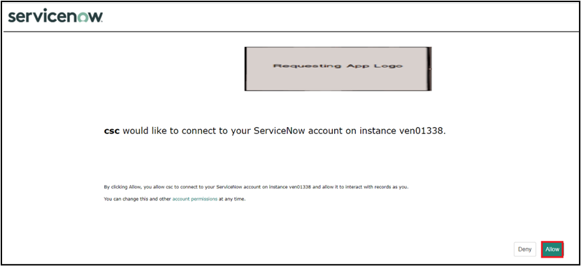

  1. After the login is successful, the user will get the prompt as mentioned in the screenshot below, user needs to allow this by clicking on the Allow.
alt text

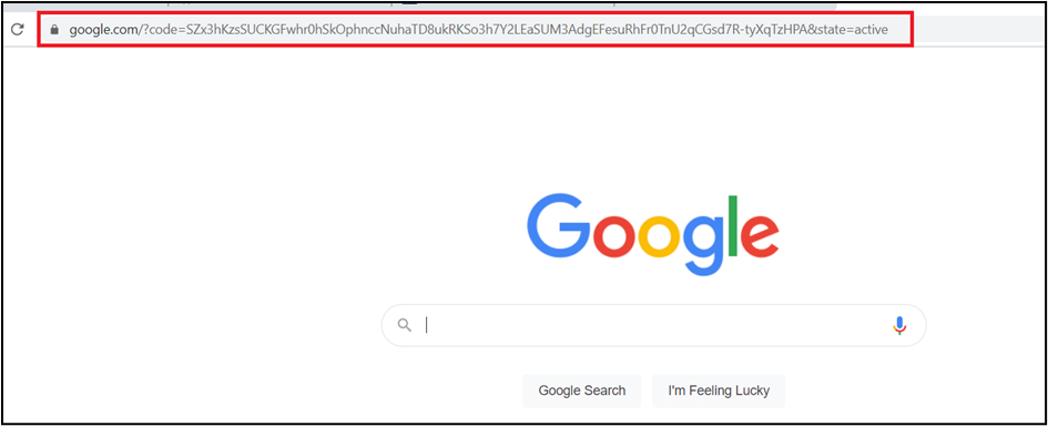

  1. Code will appear in the browser search bar, copy the code.
alt text
alt text

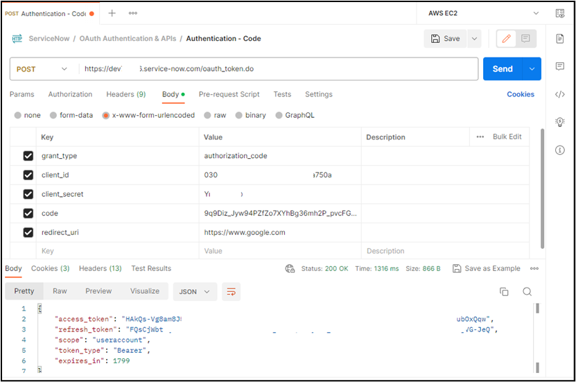

  1. Now, will use the POSTMAN client, to generate the refresh token. As mentioned in the following steps:
POST https://.service-now.com/oauth_token.do
Body: x-www-form-urlencoded
grant_type: authorization_code
code: generated in step 3.e
redirect_uri: uri provided at the time of app creation.
client_id: generated at the time of app creation.
client_secret: generated at the time of app creation.
  1. Postman request will look like:
alt text
  1. Copy the Refresh Token.
