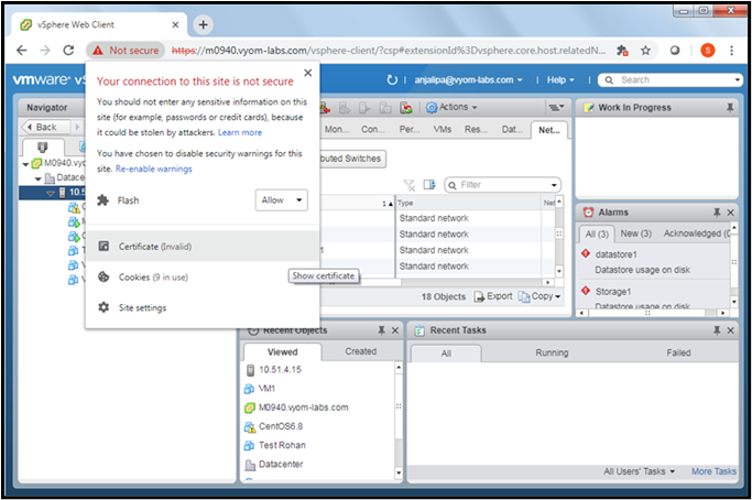

Export Certificate​
  1. Log in to vCenter Server using specified server name (https:\vmware.example.com) and follow the below procedure to install the certificate.
alt text

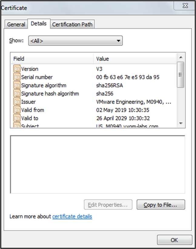

  1. The Certificate Windows opens.
  2. Navigate to the Details tab.
alt text
  1. Click Copy to File button while on Details tab.

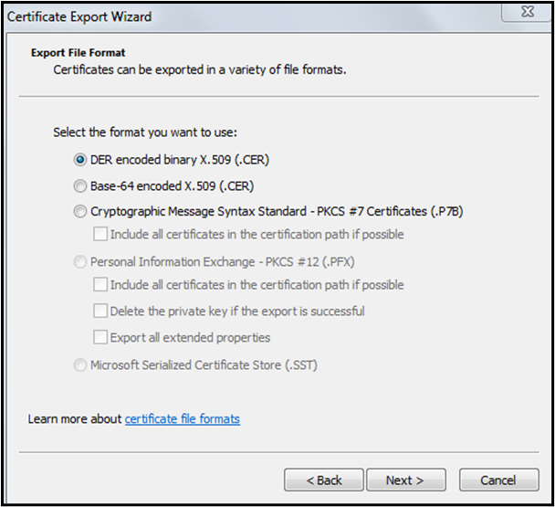

  2. The Certificate Export Wizard appears.
  3. Click Next
  4. Select the format as shown below.
  5. Click Next.
alt text

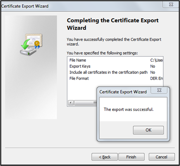

  1. Browse a file path to download the certificate.
  2. Provide a name for the certificate.
  3. Click Save.
  4. You can now see the file path in the Certificate Export Wizard.
  5. Click Next
  6. This is the final step: Completing the Certificate Export.
  7. Click Finish.
alt text
  1. A pop-up window appears showing the export was successful.
  2. Click OK.
alt text
  1. Click OK.
alt text
  1. This completes the process of exporting the Certificate.
