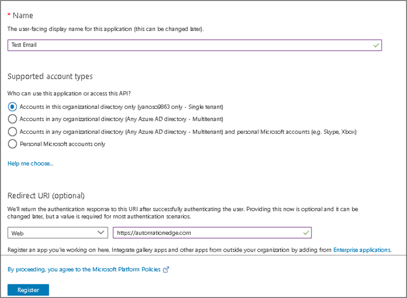

Following are the steps to register App,
  1. Sign in to Azure portal with the email address having permission to perform the action to be automated. The permission details are mentioned under the specific step documentation.
  2. For the automation of email handling actions, Sign in to the Azure portal with the email address that is going to be used in the step.
  3. Select the Azure Active Directory.
  4. Select App registrations.
  5. Select New registration.
  6. Name the application. Select a supported account type, which determines who can use the application.
  7. Under Redirect URI, select Web for the type of application you want to create. For example, https://automationedge.com.
  8. Select Register.

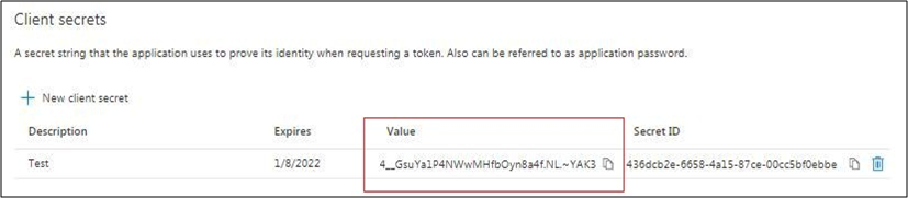

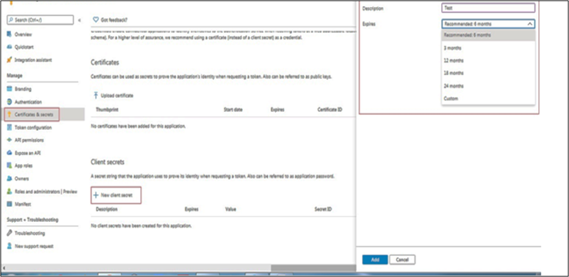

Creating Client Secret​
  1. Click on Certificates and secrets.
  2. Click on New client secret.
  3. Enter Description.
  4. Select the Expires value.
  1. Copy and save the value with you as it visible only for one time.

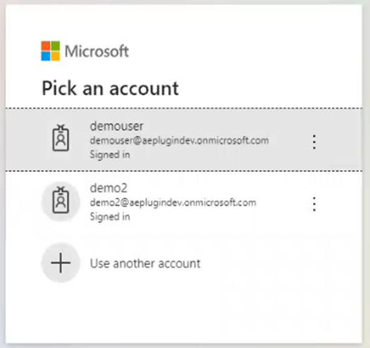

  1. Create Below URL and run in browser. https://login.microsoftonline.com/Tenant_id/oauth2/v2.0/authorize?client_id=value&scope=Permissions &response_type=code. Example: https://login.microsoftonline.com/2f906216-6aaa-4ee5-8c13-5bbb3af06089/oauth2/v2.0/authorize?client_id=e6080cc9-dccc-4e8b-a22e-93174e01459b&scope=Mail.Read Mail.ReadWrite Mail.Send openid User.Read offline_access &response_type=code
  2. After running in the browser the below login screen will appear, log in with the user who has created the app.

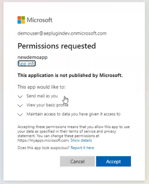

  1. After login below screen will appear, on below screen click on Accept Button.

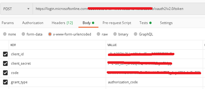

  1. Once you get the code you need to create a POST request in postman to generate the refresh token. Below are the details
POST
URL: https://login.microsoftonline.com/{Tenant id}/oauth2/v2.0/token
Headers:
Content-Type: application/x-www-form-urlencoded Body: x-www-form-urlencoded(key value pair) client_id={client_id} client_secret={ client_secret } code={code} grant_type=authorization_code
Postman Request:
Postman Response:
