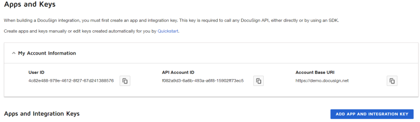

  1. Go to https://admindemo.docusign.com/apps-and-keys, and sign-in to your DocuSign account.
  2. Click ADD APP AND INTEGRATION KEY. The Add Integration Key dialog appears.
    DocuSign-1

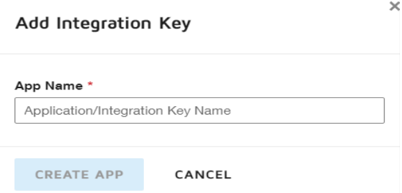

  3. In the Add Integration Key dialog enter the App Name, and click CREATE APP.
    DocuSign-2

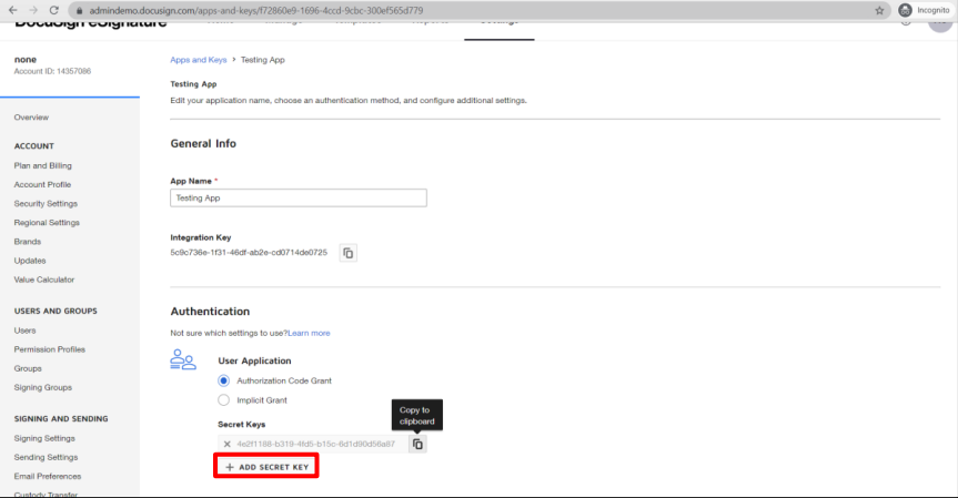

  5. Click ADD SECRET KEY to get secret key.
    DocuSign-3
  6. Copy and save the Secret Key with you.

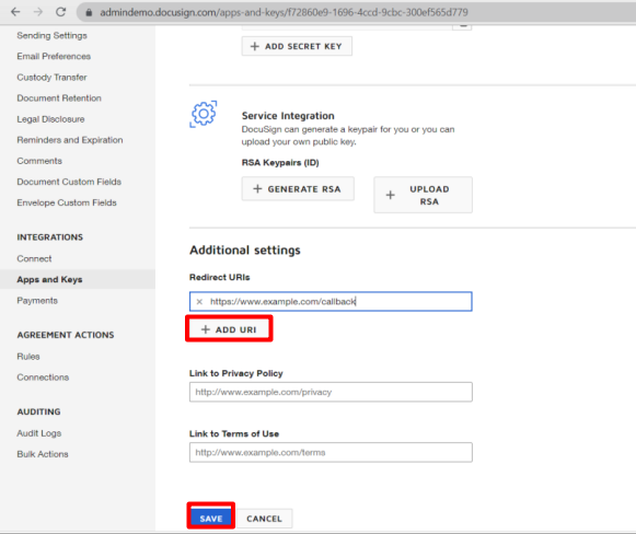

  7. Click ADD URI to add Redirect URI.
    DocuSign-4
  8. Add your URI, for example, https://www.example.com/callback, and click SAVE. All details are saved.

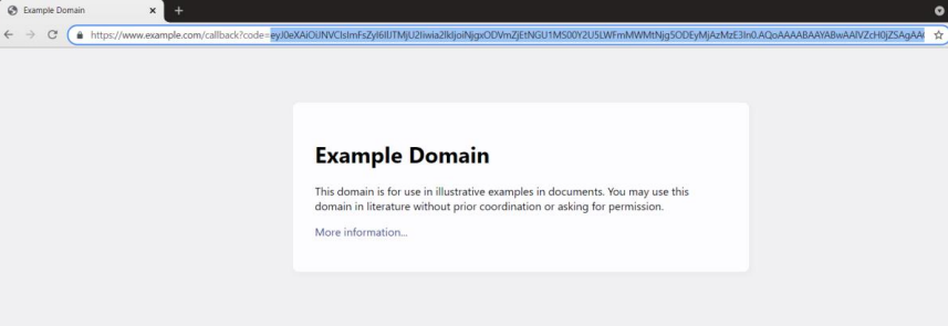

  9. Open browser and search the URL after replacing it with your app’s Integration key and Redirect URI. https://account-d.docusign.com/oauth/auth?response_type=code&scope=signature&client_id=YOUR_APP_INTEGRATION_KEY&redirect_uri=YOUR_APP_REDIRECT_URI
    After entering the URL on the browser you may need to verify yourself by giving your DocuSign Credentials.
  10. After you verify the details, a callback code is generated in the URL itself. Copy the Callback URL Code, and save it with you.
    The Callback URL Code expires in two minutes. You can regenerate it by calling the same URL in the browser.
    DocuSign-5

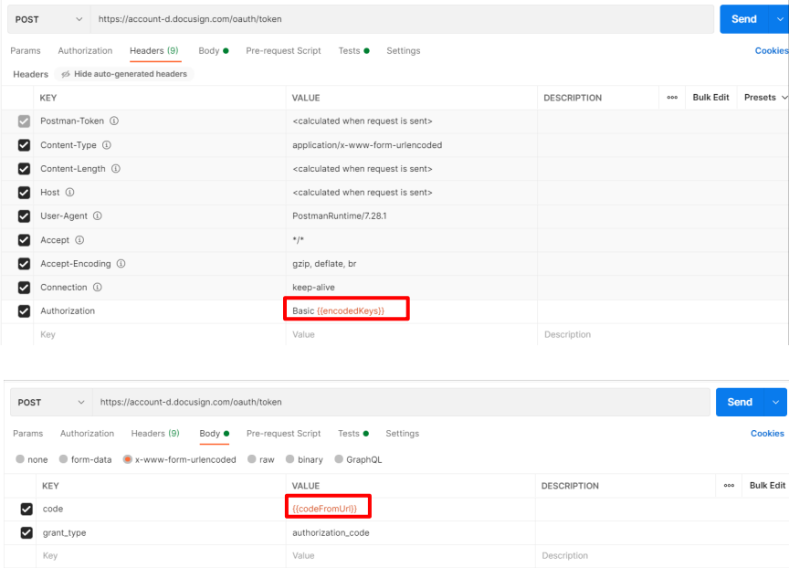

  11. Go to Postman to generate a refresh token.
  12. In the POST page replace the VALUE for the following KEYs:
    {{codeFromUrl}} with Callback URL Code.
    {{encodedKeys}} with integration key and secret key, concatenated by a colon character as (Integartion Key:Secret Key), converted into base64.
    DocuSign-6
    Make the following request to generate the Refresh Token:
    **POST:**
    https://account-d.docusign.com/oauth/token
    **Headers:**
    Authorization: Basic {{encodedKeys}}
    **Body: x-www-form-urlencoded** (key value pair)
    code= {{codeFromUrl}}
    grant_type= authorization_code

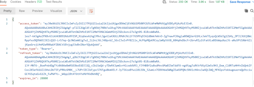

    You will get Refresh Token under tag ‘refresh_token’ in JSON response.
    DocuSign-7
