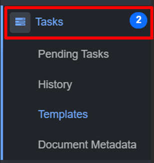

  • The blue circle with the number (for example, 2) in the navigation menu indicates the total count of Approvals and Assigned to Me tasks.

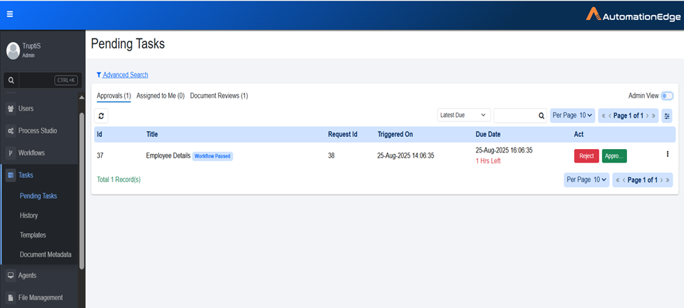

To view pending task details:
  1. In the menu, click Tasks → Pending Tasks. The Pending Tasks page appears.
alt text
  1. View the following column details:
Column nameDescription
IdDisplays unique Id of the task.
TitleDisplays title of the task.
Request IdDisplays the request ID from the Request tab that generated this task.
Template NameDisplays the unique task template name. Note: Template name feature is visible from Release 8.2.4 onwards.
Triggered OnDisplays date and time when the task was generated.
Due DateDisplays the date and time for the task deadline.
Note: You can view the remaining time in the due date for a task.
alt text
ActPerform action on the task. For more details, refer to the Act section.

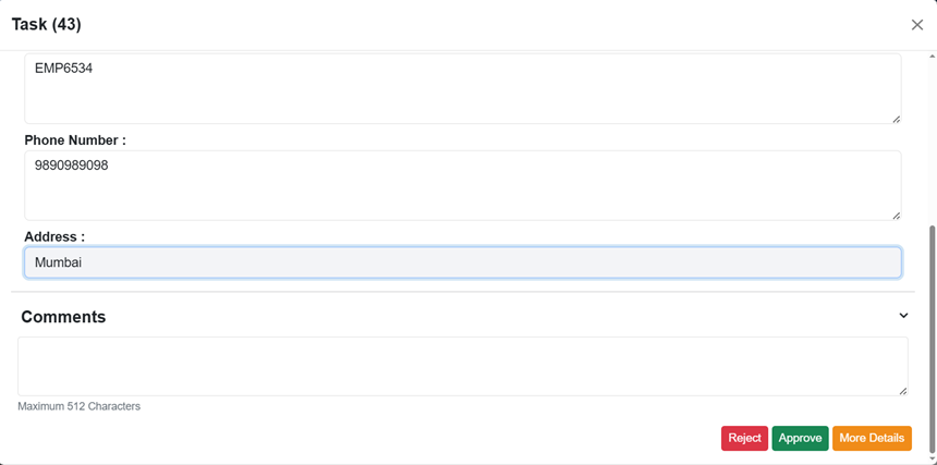

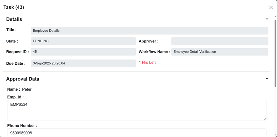

  2. In the Approvals tab → Title column, click the task title. The Task detail page appears.
    alt text
  3. The approver can review and edit the data fields values. After making the necessary changes, the approver can act on the task using customized action buttons.

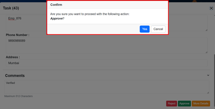

  4. Click Approve and a confirmation dialog appears. Click Yes to approve the task.
    alt text

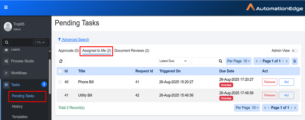

Assigned to Me
You can assign the task to yourself to review a document.
This locks the document task for your review. For more details, refer to the Document Reviews section.
To review the document:

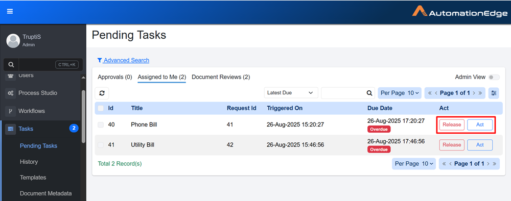

  1. In the menu, click Tasks → Pending Tasks → Assigned to Me. The Assigned to Me page appears.
alt text
  1. In Assigned to Me, you can either act on the document or release it. Releasing the document sends it back to the Document Review queue.
alt text

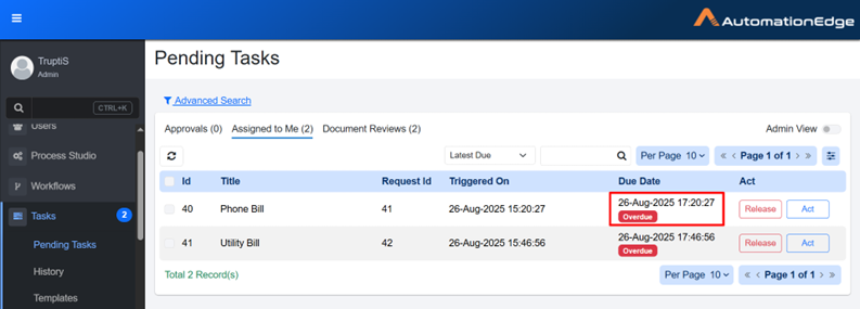

If an action is not taken within the deadline mentioned in the Reject/Repair step, you will see Overdue tag in the Due Date column.

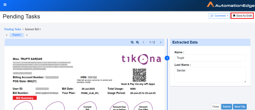

  1. Click on Act or on the Task Title. The document with extracted data appears.
    • The extracted data view is also known as the Reject Repair view.
    • All the values for Human in the Loop fields are saved in the String format.
    • You can view the image or PDF in Reject Repair view. Note: Image in Reject/Repair feature is available from Release 8.2.4 onwards
    • Select a value in a table row to highlight its source in the document. This lets you verify values without scanning the page.
    • A colored confidence indicator on each row also flags entries that may need a closer look.
    alt text
  2. You can make the required changes, if any.
    Notes:
    • If the confidence level is Low, alt text appears next to the extracted data.
    • If the confidence level is Medium,alt text appears next to the extracted data.
    • If the confidence level is High,alt text appears next to the extracted data.
    alt text
  3. You have an option to Save as Draft if you want to come back to review the documents later. If you complete your changes in one session, you don't need to save the draft and can proceed directly to the next step.

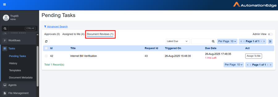

Document Reviews
The Document Reviews tab works as a queue. All tasks that require approval appear here and are visible to all approvers and approver groups. Each nominated approver sees the same list of pending documents. When an approver wants to review a document, they must select Assign to Me. This action locks the document for that approver, and the document is removed from the Document Reviews queue. Other approvers will no longer see the document in their queue. The approver who locked the document can now review and work on it.
To view Document Review Page:
  1. In the menu, click Tasks → Pending Tasks → Document Reviews tab. The Document Reviews page appears.
    alt text
  2. View the column details:
    Request IdDisplays the request ID from the Request tab that generated the task.
    Triggered OnDisplays date and time when the task was started.
    Note: You can view the remaining time until the due date for a task.
    alt text
    ActTo assign the task to yourself, click Assign to Me. To understand how to act on a task, see Assigned to Me section.

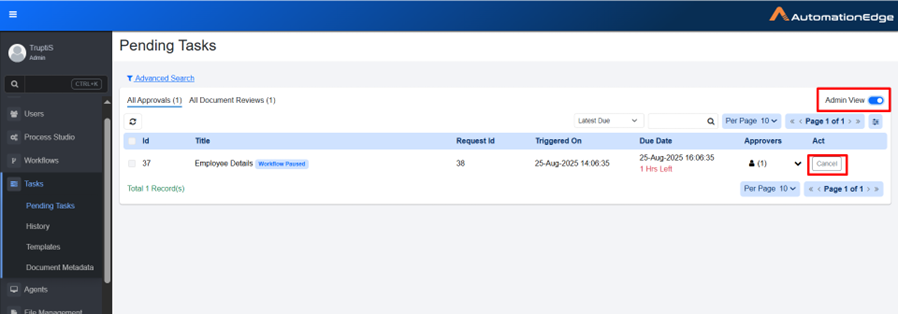

Admin View

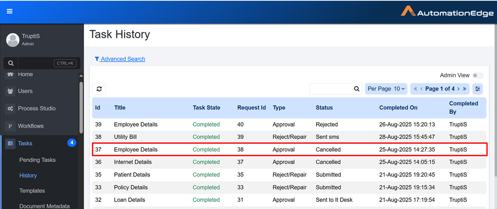

Only Admin user can see this switch. In Admin View, the admin can see task prompts. If a task has been pending for a long time, the admin can cancel it. Only the admin has the authority to cancel approval tasks. The admin cannot assign the task to another user; the task can only be cancelled. The admin can also view the list of approvers for that task.
To cancel the task:
  1. Toggle the Admin View switch. The Admin View appears.
    alt text
  2. Select the checkbox next to the task you want to cancel and click Cancel. The task is cancelled.
  3. Go to the Task History tab to view the task. The task status is updated to Cancelled.
