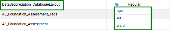

    TagsDisplays the tags added to the workflow.

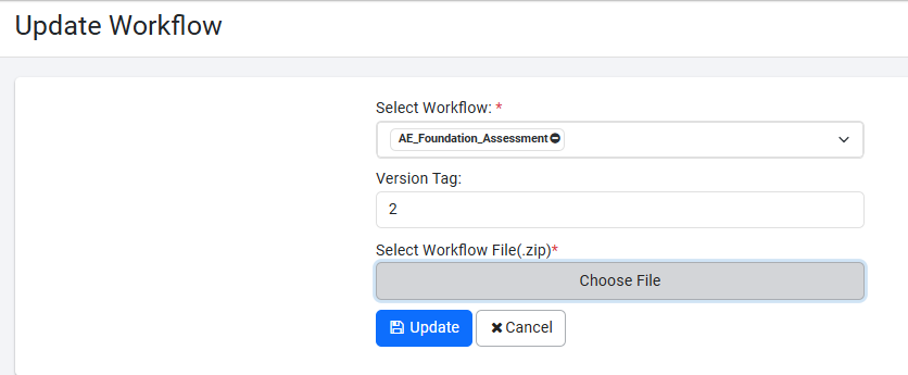

Edit workflow configuration​
You can edit the workflow configuration, if required.
To edit workflow configuration:

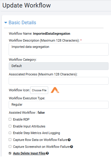

  1. In the Actions column, click edit. The Update Workflow page appears.
    Workflow
  2. Modify the following field details:
    Basic Details
    Workflow Name*Displays the name of the workflow.
    Workflow Description*Modify the workflow description.
    Workflow CategoryDisplays the category to which the workflow belongs.
    Associated Process (Maximum 128 characters)Modify or enter the name of the process you want to associate with the workflow.
    Workflow IconClick Choose File and browse and select the image for the workflow.
    Click remove icon to remove the custom icon added to the workflow. When the custom icon is removed, the system automatically applies the default AutomationEdge icon AE default icon to the workflow.
    Workflow Execution TypeSelect the type of execution you want to assign to the workflow. Available execution types are:

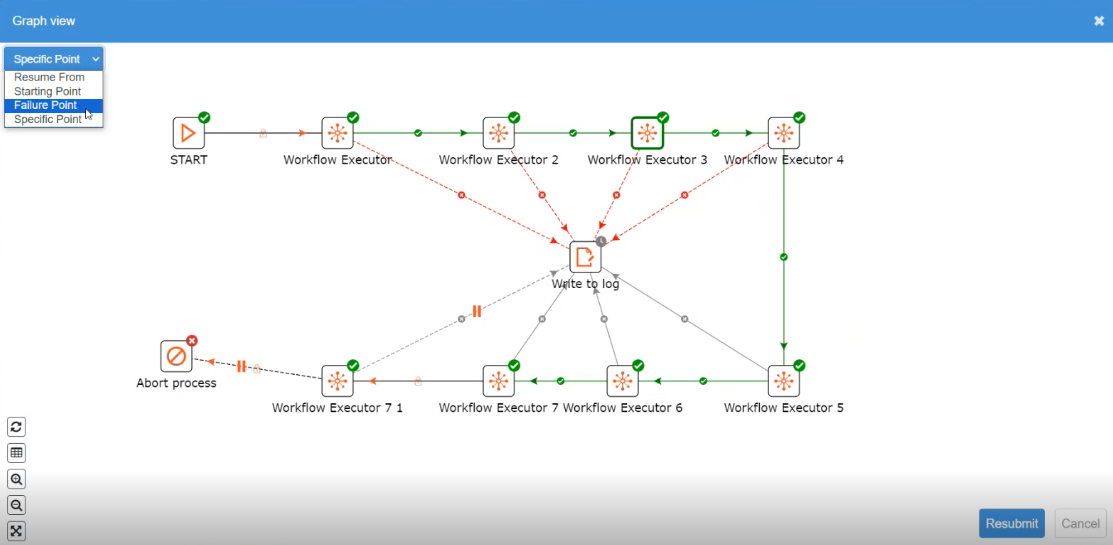

    Enable Workflow CheckpointingSelect the checkbox if you want to activate the workflow checkpointing feature.
    For details, see Workflow Checkpointing

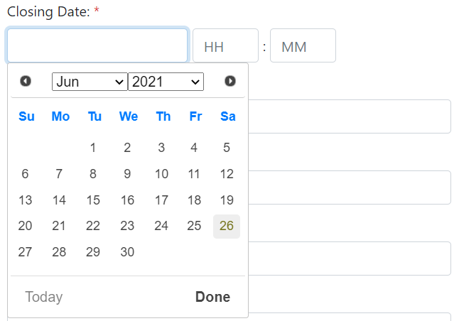

  • Text Box (Date)
    Date value can be selected from the picker for date-time.
    Picker for date and time

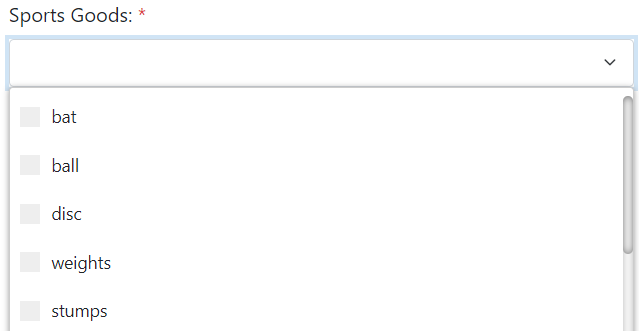

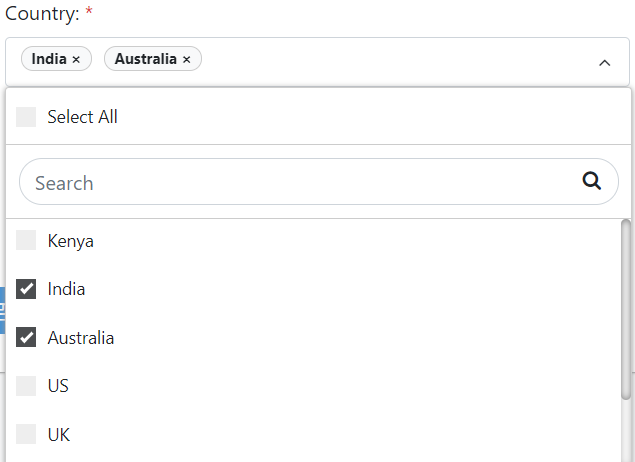

  • Multiple Selection List (List)
    Enable checkboxes to select multiple values.
    Select multiple values

  6. In the Act column, click action and select resume option. The process opens in Graph view.
    Workflow
    Graph view
  7. In the Graph view, click in the resume from list, select the point from which you want to resume the execution. The available options are:
    i. Starting Point: The execution starts from the default starting point.
    If metrics data is unavailable for the workflow, then only this option is available in the list.
    ii. Specific Point: The workflow execution resumes from the point of your choice.
    iii. Failure Point: The workflow execution resumes from the point where the previous execution had failed.
  8. Click Resubmit. A new request is created and is listed in the Requests page.

Update a workflow​
You can update the workflow, if required.
To update the workflow:
  1. In the menu, click Workflows → Workflow List. The Workflows page appears.
  2. On the page, click action menu and then select Update. The Update Workflow page appears.
    Select Workflow *Select the workflow that you want to update.
    Version TagEnter the version tag. For example, 1.0.
    Select Workflow File(.zip) *Click, browse, and select the zipped workflow file that you want to import.
    • Indicates mandatory field.
  4. Click Update. The workflow is updated and appears in the Workflows page.

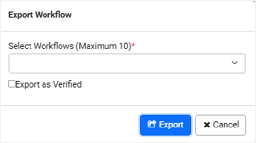

Export a workflow​
You can export the workflow that can be shared with other tenants.
To export a workflow:
  2. On the page, click action menu and then select Export. The Export Workflow dialog appears.
  3. In the dialog:
    • Select Workflows (Maximum 10) *: Select the workflows that you want to export. You can select a maximum of 10 workflows.
