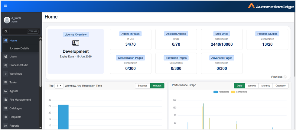

  1. In the menu, click Home. The Home page appears.
    home
    The Home page view
  2. On the page, you can see the following:
    • License Overview: Displays the type of license and expiry date of the license. Click in the License Overview tab and you are taken to the License Details page. For details about updating license, see Upload or update the license section.
    • Agent Threads: Displays the number of agent threads in use.
    • Assisted Agents: Displays the number of assisted agents in use.
    • Step Units: Displays the step units consumed.
    • Process Studio: Displays the number of Process Studio licenses used.
    • Classification Page: Displays the number of pages classified. When a document is classified with DocEdge, the Classification Page Count balance decreases by the number of pages classified.
    • Extraction Page: Displays the number of extracted pages. When data is extracted from a document with DocEdge, the Extraction Page Count balance decreases by the number of pages extracted.
    • Advanced Page: Displays classification and extraction of documents using generative AI.
The Classification Page Count represents the number of pages traversed to classify a document. Traversal for classification is considered page consumption. For example, to classify a document as an Aadhaar card, the system must read or traverse the document. The number of pages traversed during classification is deducted from the Classification Page Count balance. In the AE UI, you can view the balances for all three page counts. The number of pages consumed or deducted from the license balance is determined by the DocEdge plugin step. For more information, see the DocEdge Plugin Guide.

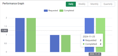

In the following section, you can view various charts and graphs that display the current AE engine status. You can hover over each view to see the details.
home1
The detailed view after hovering the mouse over a chart

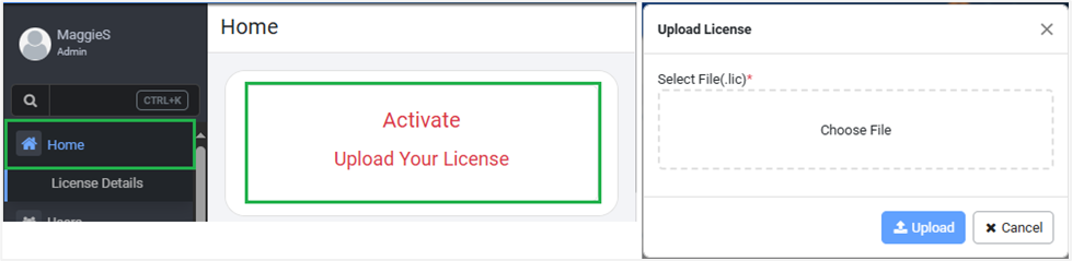

  1. On the Home page, click Activate - Upload Your License tab. The Upload License dialog appears. home
    Upload Your License dialog
  2. In the Select File(.lic)/*, click Choose File. The File Explorer opens.
  3. In the File Explorer, select the license, and then click Open. The file appears in the field.
  4. Click Upload. The license is uploaded and activated.
    upload license
    License uploaded and activated

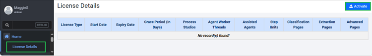

You can also upload the license through Home → License Details page → Activate.
home
License Details page - Activate

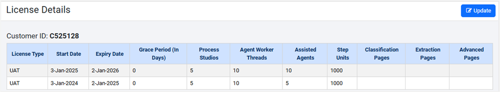

View the license details​
You can view the license details on the License Details page.
To view the license details:
  1. In the menu, click Home → License Details. The License Details page appears.
  2. The following field details appear:
Customer IDDisplays the unique customer ID.
License TypeDisplays the type of license you are using:
- Trial
- Production
- UAT
- Development
Start DateDisplays the license start date.
Expiry DateDisplays the date when the license will expire.
Grace Period (In Days)Displays the grace period of the license over the expiry date.
Process StudiosDisplays the maximum number of Process Studios that can be assigned to users and registered.
Agent Worker ThreadsDisplays the maximum number of agent threads available in the license.
Assisted AgentsDisplays the number of subscribed Assisted Agents.
Assisted Agents are personal Agents or Attended Bots and run on the users’ machine. Assisted Agents can execute one workflow at a time.
For more details, see Assisted Agents.
Step UnitsDisplays the associated step units consumed for each step instance.
Steps in a plugin have associated step units. Each step instance consumes associated step units when these steps are used in an active workflow in AutomationEdge.
The total number of Consumed Step Units of all the active workflows deployed on AutomationEdge at any time should not exceed the number of overall Step Units specified in the license.
Classification PagesDisplays the number of pages classified.
Extraction PagesDisplays the number of pages extracted.
Advanced PagesDisplays the classification and extraction of documents using generative AI.
