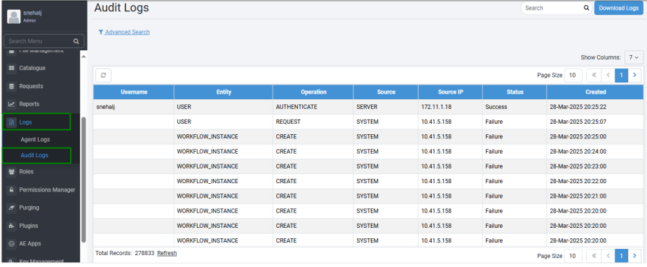

View Audit Logs
View the Audit log details.
To view the Audit Logs details:
  1. In the menu, click Logs → Audit Logs. The Audit Logs page appears.
    UsernameDisplays the login username.
    Note: If the source is SERVER, logged in username is populated.
    EntityDisplays the name of the entity on which operation was performed. Following is the list of entities accessed by users:
    - AGENT
    - AGENT_CONSUMPTION
    - APPLICATION
    - ARTIFACT
    - ASSISTED_AGENT_LICENSE
    - CATEGORY
    - CREDENTIAL
    - CREDENTIAL_POOL
    - DEBUG_LOG_REQUEST
    - FILE
    - LDAP_CONFIGURATION
    - LICENSE - NOTIFICATION_CONFIGURATION
    - PS_PLUGIN
    - PS_PLUGIN_PROPERTY
    - REMEDY_FORCE_CONFIGURATION
    - REPORT_DASHBOARD
    - REPORT_DATASOURCE
    - REPORT_INSTANCE
    - REPORT_TEMPLATE
    - ROLE
    - SCHEDULE
    - SERVER_URL
    - SMTP_CONFIGURATION
    - SYSTEM_SETTING
    - TENANT
    - USER
    - USER_GROUP
    - USER_GROUP_MAPPING
    - WORKFLOW
    - WORKFLOW_CONSUMPTION
    - WORKFLOW_INSTANCE
    - WORKFLOW_PARAMETER
    OperationDisplays the name of the operation performed on the entity.
    - ASSIGN
    - ASSIGN_PERMISSIONS
    - AUTHENTICATE
    - CHANGE_PASSWORD
    - CREATE
    - DELETE
    - DOWNGRADE
    - DOWNLOAD
    - EXECUTE
    - EXPORT
    - IMPORT
    - LOGOUT
    - OWNERSHIP_TRANSFER
    - REGISTER
    - REQUEST
    - RESPONSE
    - RESTART
    - START
    - STOP
    - SYNC
    - UNASSIGN
    - UPDATE
    - UPGRADE
    - UPLOAD
    Object IdDisplays the ID of the entity object on which the operation was performed.
    Object Name (Optional)Displays the name of the entity object on which operation was performed.
    Description (Optional)Displays the description of the Audit log.
    SourceDisplays the source for the Audit logs. The source can be, Server, Agent, Workflow.
    Note: AE also adds Username value for audit logs with source "SERVER" and the agent name value for source "AGENT/WORKFLOW".
    Source IPDisplays the source IP of the Audit Logs.
    Agent NameDisplays the name of the agent. If the source is AGENT/WORKFLOW, the Agent name is populated.
    StatusDisplays the operation status. The status of operation can be: Success or Failure.
    Log LevelDisplays the log level. Log level can be set to INFO or TRACE for source WORKFLOW in the Process Studio - Audit log step. For source, Server and Agent, Audit logs are system generated, and we do not specify log level.
    CreatedDisplays the Audit log creation date, that is, the date of operation.

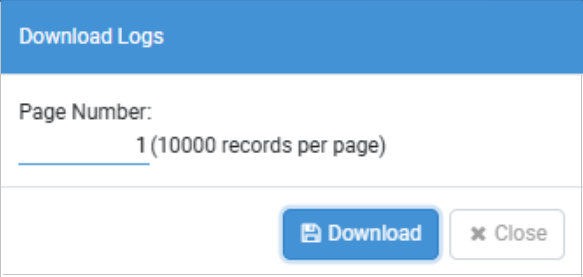

Download Audit Logs
Download the Audit logs, as required.
To download the Audit logs:
  2. On the page, click Download Logs. The Download Logs dialog appears.
  3. In the dialog, enter the page number that you want to download, and then click Download. The log is downloaded as a .csv file.
    • A maximum of 10000 records are downloaded per page.
      For example, click Fetch to get the total records. If the total records are 20000, then to download the Audit logs, first enter 1 in the Download Logs dialog, and then download the log file. The file will contain 10000 records. To download the other 10000 records, specify 2 in the dialog and again download the file.
    • Multiple pages download is not supported.

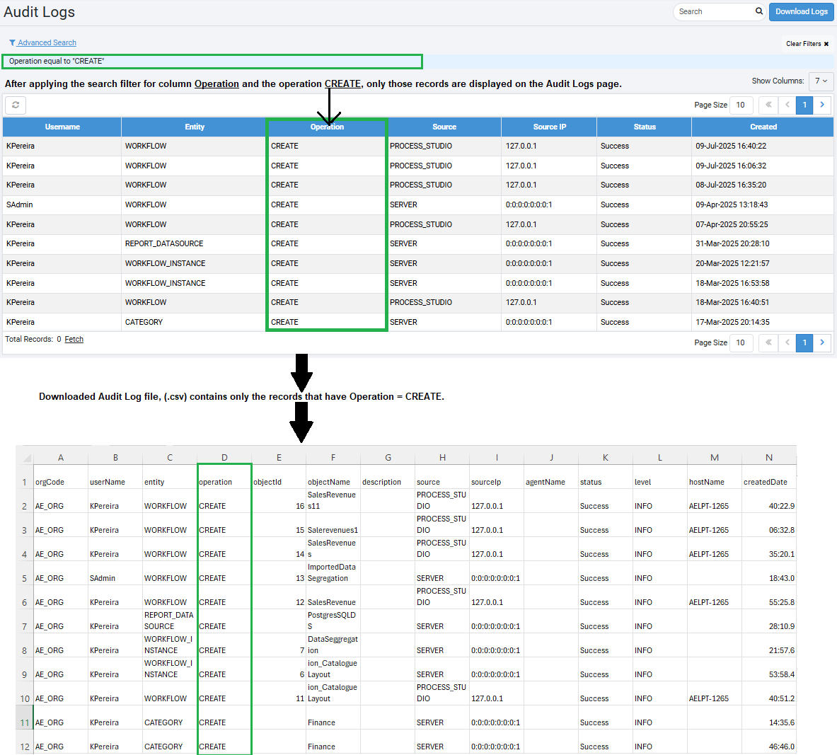

If you apply search filter to the records, then only those records are downloaded in the log.
