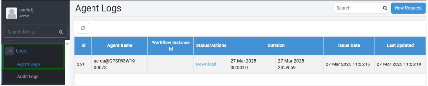

  1. In the menu, click Logs → Agent Logs. The Agent Logs page appears.
    Agent logs
    IdDisplays a unique ID for the logs.
    Agent NameDisplays the name of the agent with which the Agent log file is associated.
    Workflow Instance IdDisplays the ID of the workflow request submitted.
    Status/ActionsDisplays the status of the operation: New,
    In Progress,
    Complete,
    or Failed.
    Note: If the request completes, a link to download the logs is available.
    DurationDuration is the period for the Agent log file retrieval.
    From DateDisplays the start timestamp of the period.
    To DateDisplays the end timestamp of the period.
    Issue DateDisplays the timestamp of the request.
    Last UpdatedDisplays the timestamp when the request was last updated.
To find specific Agent logs, enter the name of the log in the Search box and press Enter. The specified log details appear.

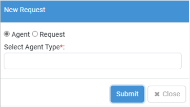

  2. Click New Request. The New Request dialog appears.
    Agent logs

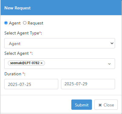

  3. Select Agent or Request and then:
    i. In the Select Agent Type*, choose the type of agent, Agent or Assisted Agent for which you want to download the log.
    ii. Enter the following details:
    • Select Agent*: Select the agent for which you want to download the log.
    • Duration*: Set the start and end date for downloading the log. The maximum duration to download log files is five days, that is, the difference between start and end date must be less than or equal to five.
      In the Enter Request Id*, enter the request Id for which you want to download the log.
      New Request
  4. Click Submit. On the Agent Logs page, a new download request entry appears with status New.
    The status changes to Download after some time. Click the link to download the log as a zip file.
