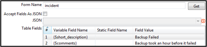

| 5 | Variable Field Name | This is an optional field. Choose a field in input stream from drop down list or provide a user or system defined variable. |

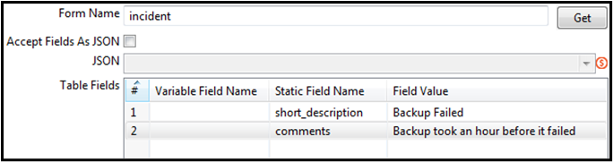

| 6 | Static Field Name | On click of this column field, it opens a dialog with the list of available form fields of the provided Form Name. The name of the fields to be inserted should be selected. Multiple fields can be selected from the list displayed on click. The selected field’s values below will be inserted in the record. Validation: The plugin validates field names from remedy server. If ‘Static Field Name’ and ‘Variable Field Name’, both are provided in the same row in ‘Table Fields’ then ‘Static Field Name’ will be considered to build the JSON to insert a record. |
| 7 | Field Value | Provide field values to be inserted in the corresponding chosen fields. Following, is a sample snapshot of input tab with Table Fields with Static Field Name. ![]() Following, is a sample snapshot of input tab with Table Fields with Variable Field Name. ![]() Note: If the selected Field Name is mapped with any Lookup List on the backend then, in that case, it will accept only valid mapped values in the Field Value and the ticket will be created. But if an invalid value is provided to such Fields then the ticket will take the default value mapped with that Field on the backend. |
