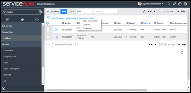

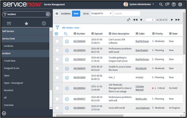

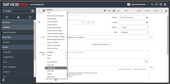

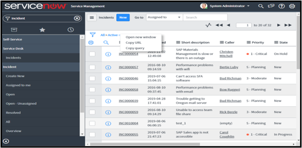

| 3 | Criteria Query | Fetch all ServiceNow Records matching Criteria Query. You can create simple Criteria Query as shown in the following samples, - short_description=RPA Test - number= INC0010097 - sys_id= ef43c6d40a0a0b5700c77f9bf387afe3 The following screenshot shows that sys_id can be copied by right clicking on a particular record. Alternatively create filters in SNOW UI and copy Criteria Query from the UI. This is especially useful for complex query criteria with one or more AND, OR criteria. The following is a screen shot of the Incident Application. You can see the filter sign on top of the column headings. It shows the filter Active=True has been applied on All incidents. You may right click on the filter and click Copy query to copy the Criteria Query. ![]() You may paste this as Criteria Query in the plugin step. - active=true You can now see the filtered list with filter applied: Short_description=RPA or Opened Today. ![]() Right click on the filter and click Copy query. ![]() The Criteria query is as follows: short_description=RPA^ORopened_atONToday@javascript:gs.beginningOfToday()@javascript:gs.endOfToday() You may now use it in the Plugin step. For a detailed description of how to create Criteria query in SNOW UI refer Appendix: Build Criteria Query in SNOW UI Additional information for Criteria Query: To get the display value and/or the actual value of the field in the response, use the following query parameter in the Criteria Query: sysparm_display_value={valid_value}. Valid values: a. true: Returns the display values for all fields. b. false: Returns the actual values from the database of ServiceNow. c. all: Returns both actual and display values. Default value: false Syntax: <Criteria Query>&sysparm_display_value=<valid_value> Example query: number=INC0010001&sysparm_display_value=true There is no preferred method for setting sysparm_display_value. However, specifying the display value may cause performance issues since it is not reading directly from the database of ServiceNow and may include referencing other fields and records. For more information on Service Now: Input step, see https://developer.servicenow.com/dev.do#!/reference/api/rome/rest/c_TableAPI#table-GET. - Sort records in ascending or descending order using the ORDERBY clause. See the following example: state=1^assignment_group=d625dccec0a700a222a0f7900d06^ORDERBYnumber state=1^assignment_group=d625dccec0a700a222a0f7900d06^ORDERBYDESCnumber |
