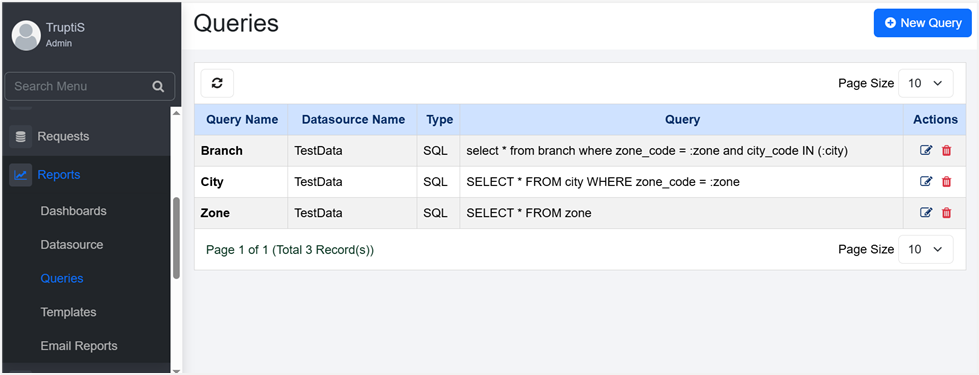

  1. In the menu, click Reports → Queries. The Queries page appear.
Queries page

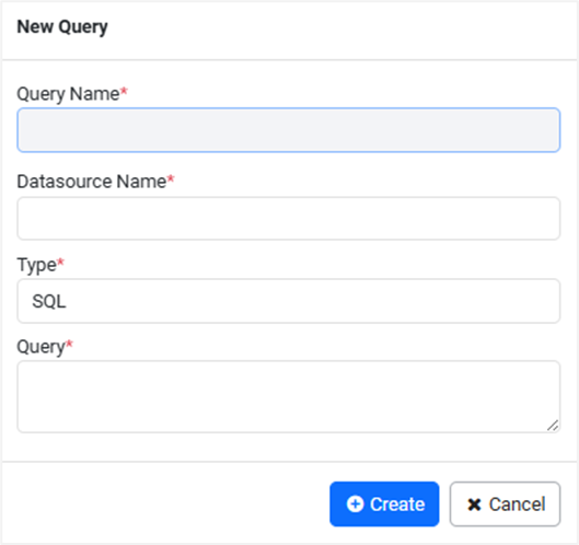

  1. Click New Query. The New Query dialog appears.
New Query dialog
  1. Enter the following details:
Query Name*Enter the name of the query you want to create.
Datasource Name*Select the data source from the list.
Type*Select the type of query from the list. Currently support is available for SQL only.
Query*Enter the SQL query to retrieve values for the input field. The query must follow the JDBC syntax and include named parameters using the :parameterName format.
For example: SELECT * FROM city WHERE zone_code =: zone.
* indicates mandatory field.
  1. Click Create. A Query created successfully message appears.
