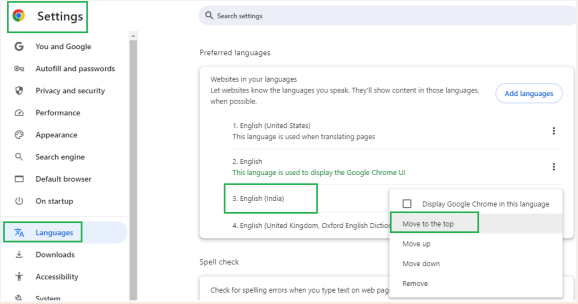

The localization of currency values for reports such as Total Profitability are based on the language selected in AutomationEdge, View Profile → User Profile dialog → Language. If the language is not selected in the AutomationEdge UI, then the browser’s localization settings are applied. See the following screenshot:
reports

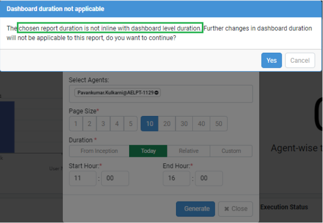

Duration settings You can apply different durations to the Dashboard and the reports on the Dashboard, if required. However, after you set the durations, changes made to the dashboard duration will not be applied to the report. For example, see the following screenshot:
reports
Duration settings example

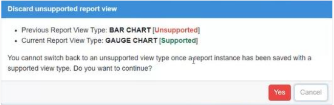

Important
From release version 8.0.0, there are changes in the supported Chart report view type. When you migrate the reports from previous AE version to the current version, then the report will appear as you had generated previously. However, if you update the report view type, then you are asked for confirmation before proceeding with the update. See the following screenshot:
reports

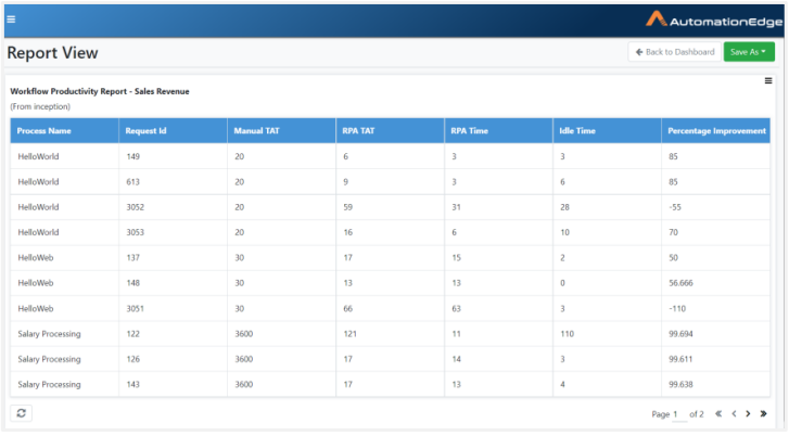

Example: Workflow Productivity Report​
It compares manual turnaround time (TAT) with RPA TAT for the workflows. It readily shows the percentage improvement with RPA. Following is a screenshot of the Workflow Productivity Report.
reports
The following table describes the report columns:
ProcessDisplays the name of the AutomationEdge workflow.
Request IdDisplays the workflow execution Request Id.
Manual TATDisplays manual execution time (in seconds) specified while configuring a workflow.
RPA TATDisplays the total time taken by a workflow to complete execution (RPA Time + Idle Time); is the same time seen on the Requests tab.
RPA TimeDisplays the actual time (in Seconds) taken for the request to complete once the Agent has picked it up.
Idle TimeDisplays the timespan (in Seconds) between submitting a request and the Agent picking it up for execution.
Percentage ImprovementIt is the improvement in terms of TAT as compared to manual execution.
*TAT => Turn Around Time
