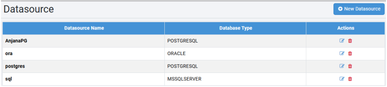

  1. In the menu, click Reports → Datasource. The Datasource page appears.
    reports
    Datasource page

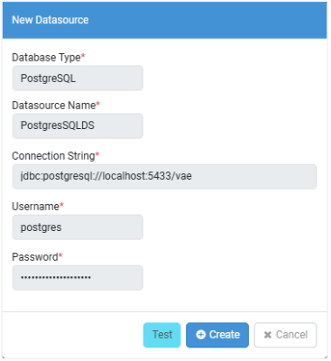

  2. Click New Datasource. The New Datasource dialog appears.
    reports
    Database Type *Select the type of database you want to create. The available options are:
    - PostgreSQL
    - MS-SQL
    - Oracle
    Datasource Name *Enter a name for the datasource.
    Connection String *Enter a JDBC connection string to the database. For example, jdbc:postgresql://localhost:5433/vae, assuming you have the database on the same machine as the AutomationEdge server, else replace with the IP address.
    Username *Enter the name of the user with which you’ll connect with the datasource.
    Password *Enter the password to connect with the datasource.
    *Indicates mandatory field.
  4. Click Test. The database connection is validated and the option to Create database appears.
    reports
    Database connection validated
  5. Click Create. The datasource is created.

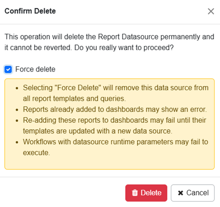

  • To modify the datasource details, click reports and after making the required changes, click Update.
  • To delete the datasource, click reports If you select Force delete it will make following changes:
  • The data source is removed from all report templates and active queries. You must update report templates and queries with a new data source before they can be successfully re-added to any dashboard.
  • Previously configured dashboard reports may encounter execution errors.
  • Workflows with datasource runtime parameters may fail to execute until you update the new datasource.

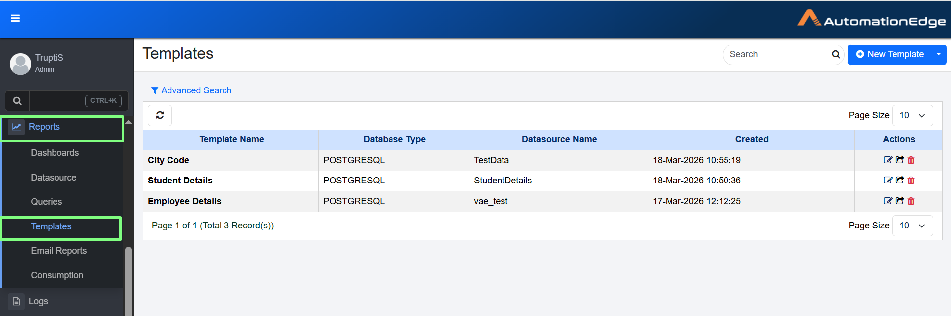

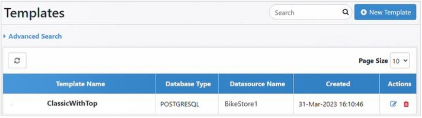

  1. In the menu, click Reports → Template. The Templates page appears.
    reports
    Reports Templates page
  2. View the following fields:
    Template NameDisplays the name of the template you want to create.
    Database TypeDisplays the type of database used for the template.
    Datasource NameDisplays the datasource name used for the template.
    CreatedDisplays date and time when the template was created.
    ActionsClick edit to edit the template.
    Click export to export the report template as a JSON format file. Confirm Password Inclusion dialog appears. Click yes if you want to export report template with Password.
    Click delete to delete the report template. Confirm Delete dialog appears. If you select Force delete it will remove all associated user and group permissions for the selected report template and will remove any reports created from report template that have been added to dashboards while deleting the template.
    Delete report template

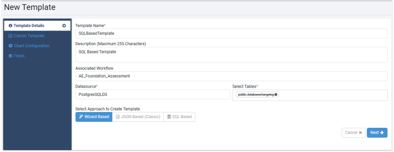

  3. Click New Template. The New Template page appears.
    reports
    New Template page
  4. Enter the following field details:
    Template Name *Enter the name of the template you want to create.
    Description (Maximum 255 Characters)Enter a description of the template.
    Associated workflowSelect an associated workflow. If selected, only users with permission to the workflow will have access to the template, and the report will be specifically for data of that workflow.
    Datasource *Select the datasource from the list.
    Note: To get a list of tables, click Fetch Table Lists, which is available only after you select the data source. However, use the table details only for creating the Structured Query Template.
    *Indicates mandatory fields.
  5. After filling the details, click JSON Based (Classic) under Select Approach to Create Template. In the Classic Template page, the report placeholder template query is generated.

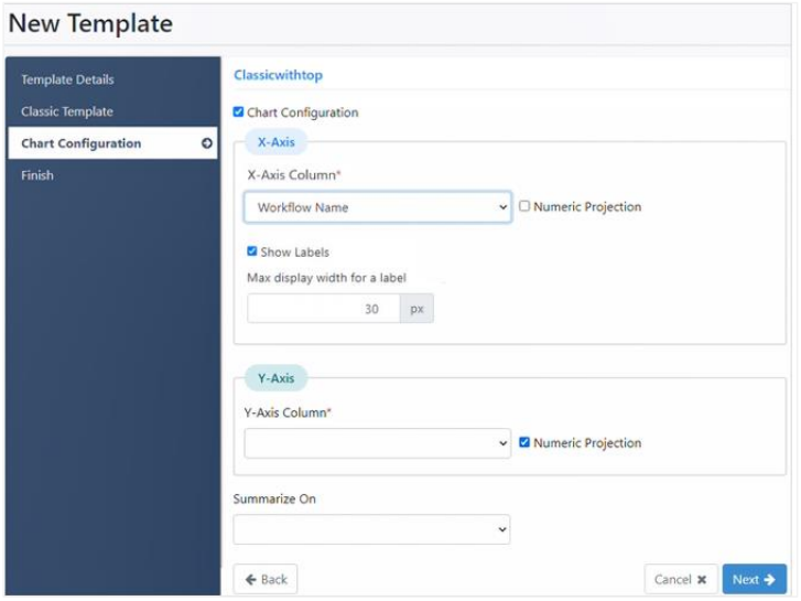

  8. Click Next. The Chart Configuration page appears.
    reports
    i. Enter the following field details:
    Field NameDescription
    Chart ConfigurationSelect the checkbox to select the axis details.
    X-Axis Column*Select the field that will be the X-axis.
    Note: Select the Numeric Projection checkbox, if the column value data type is numeric.
    Show LabelsSelect the checkbox to display the labels as available in the projections.
    Maximum Display width for a labelSet the character display limit for the label in pixels. For example, if the pixel is 30, then characters after 30 pixels will be truncated in the view.
    Y-Axis Column*Select the field that will be the Y-axis.
    Summarize OnSelect the field based on which the chart details will be summarized.

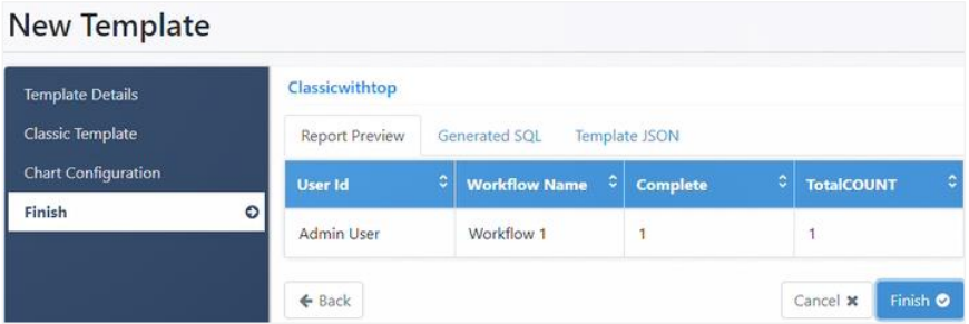

    ii. After selecting the chart configuration details, click Next. The Finish page appears.
    reports
    Finish page
    iii. On the Finish page, click each of the following tabs:
    • Report Preview: Displays the preview of the report based on the columns called in the SQL query.
    • Generate SQL: Displays the generated SQL query for a template.
    • Template JSON: Displays the complete report template JSON preview.
  9. Click Finish. The template appears in the Template page.
    reports
    Template created

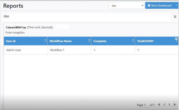

The template appears on the Dashboard, which you can use to generate reports.
reports
Report dashboard

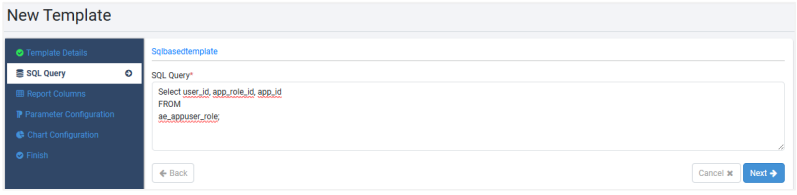

  4. Click SQL Based and then click Next. The SQL Query menu appears in the left pane.
    reports
    New Template - SQL Query

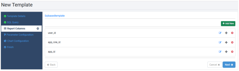

    In SQL Query, enter the query, which is tested, and then click Next. The Report Columns page appears.
  5. In the Report Columns section, the columns selected in SQL Query appear.
    reports
    New Template - Report Columns

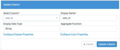

    If the SQL Query’s select statement contains ‘*’, that is, all columns, then you need to add the projection columns manually using Add New in the Report Columns page.

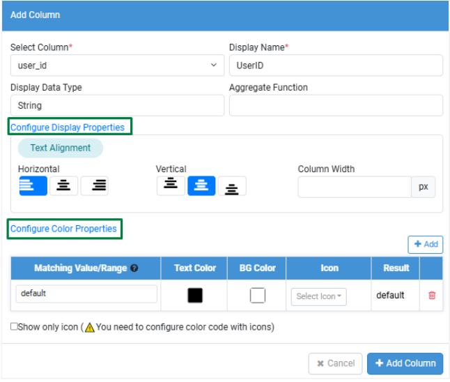

    To add a new column: i. Click Add New. The Add Column dialog appears.
    reports
    Add Column dialog
    ii. Enter the following field details:
    • Select Column: Select the name of the column, as called out in the SQL query.
    • Display Name: Enter the column name, as you want it to appear in the report.
    • Display Data Type: Select the data type of the selected column.
    • Aggregate Function: Select the aggregate function used for the selected column. For example, COUNT, AVERAGE, and so on.
    iii. Click Configure Display Properties, to set the horizontal and vertical text alignment and the width of the columns, as you want to appear in the report.
    reports
    Configurations of Display and Color properties
    iv. Click Configure Color Properties, to set the colors for values of columns, as required.
    Color Coding is available only for following data types:
    String, Number, Currency, Hyperlink and Duration.
    • For String columns, you can set a color for a fixed value. If a cell's value matches this fixed value, the color will be applied.
    • For Number, Currency Duration columns, you can set a color for:
      • A fixed number, or
      • A range of whole numbers, separated with an underscore, for example: 1_200.
      • Decimal values like 10.2 are not supported in ranges.
    • When a cell value does not match any defined color rule, the default color (if set) will be applied.
    The Duration data type is interpreted differently in AEUI:
    • The value for this column is expected in seconds (as number), which is then converted based on the unit selected in the dashboard.
    • If minutes are selected, the value is divided by 60.0.
    • If hours are selected, the value is divided by 3600.0.
    • The result is shown in the report using the chosen unit.
    • This is not the same as the standard HH:MM:SS format. That format is not supported.
    • Click Add. A new row appears.
    • Enter the following details:
      o Matching Value/Range: Enter the name of the value or range that when matched will change the color of the text in the report. Each column with a supported data type can also have a default color (set as "default" under Matching Value/Range).
      o Text Color: Select the text color of your choice.
    • BG Color: Select the background color, if required.
      o Icon: Select the icon that you want to assign with the text.
      o Result: Displays the text and the icon associated with the text.
    v. Click Add Column. The column appears in the Report Columns page.
    vi. In the Reports Column page, in addition to adding new columns, if required, you can perform any of the following tasks:
    • To view the actual JSON details for a projection column, click on the column name and expand the view.
    • To modify the details of the columns, click reports make the required changes and then click Update Column.
      reports
      Edit column details
    • To sort the columns, click Move (reports ), and then drag-and-drop the column to the location of your choice.
    • To delete the column, click Remove.

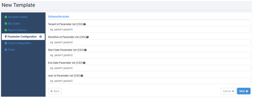

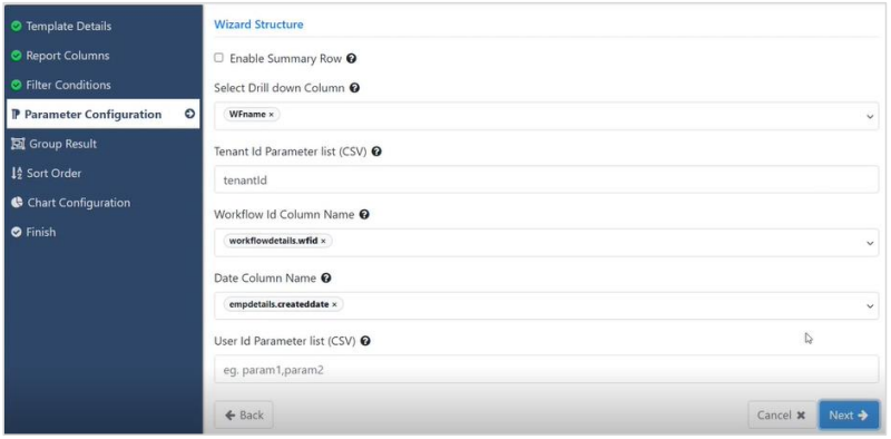

    vii. Click Next. The Parameter Configuration page appears.
    reports
    Tenant Id Parameter list (CSV)Enter the name of the tenant ID parameter list.
    Note: For both SQL Based and Wizard based approach, it specifies a list of parameter names for tenant IDs. For example, ["param1", "param2"].
    AE Engine identifies these parameters in the query. The parameters should be present in the query as :param1 and :param2.
    It substitutes these query parameters by run time values of the tenant id of the user running the report. This parameter value in the query table should be numeric.
    Workflow Id Parameter list (CSV)Enter the name of the workflow ID parameter list.
    Note: Only for the SQL Based approach, it specifies a list of parameter names for workflow IDs. The AE engine identifies these parameters in the query and substitutes them with runtime values. This parameter value in the query table should be numeric.
    Start Date Parameter list (CSV)Enter the name of the start date parameter list.
    Note: Only for the SQL Based approach, it specifies a list of parameter names for the start date. The AE engine identifies these parameters in the query and substitutes them with the start date-time stamp of the report. This parameter value in the query table should be of type date.
    End Date Parameter list (CSV)Enter the name of the end date parameter list.
    Note: Only for the SQL Based approach, it specifies a list of parameter names for the end date. The AE engine identifies these parameters in the query and substitutes them with the end date-time stamp of the report. The parameter value in the query table should be of type date.
    User Id Parameter list (CSV)Enter the name of the user Id parameter list.
    Note: For both, SQL Based and Wizard based approach, it specifies a list of parameter names for user IDs. For example, [“param1”, “param2”].
    AE engine identifies these parameters in the query. These parameters should be present in the query as :param1 and :param2. It substitutes the query parameters by the run time values of the user ID running the report.
    If Tenant users execute a custom report with the userIdParamNames option, the user can see rows that contain the user ID.
    If Tenant users execute a custom report with the userIdParamNames option, they can see rows that contain their user ID.
    However, if Admins execute a custom report with the userIdParamNames option, the user can see all rows for the first, that is, oldest created 1000 users.
    The parameter value in the query table should be numeric.

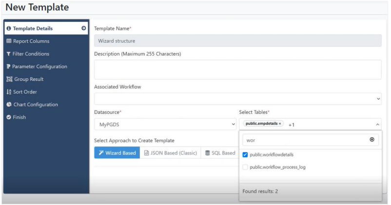

To create wizard based structured query template:

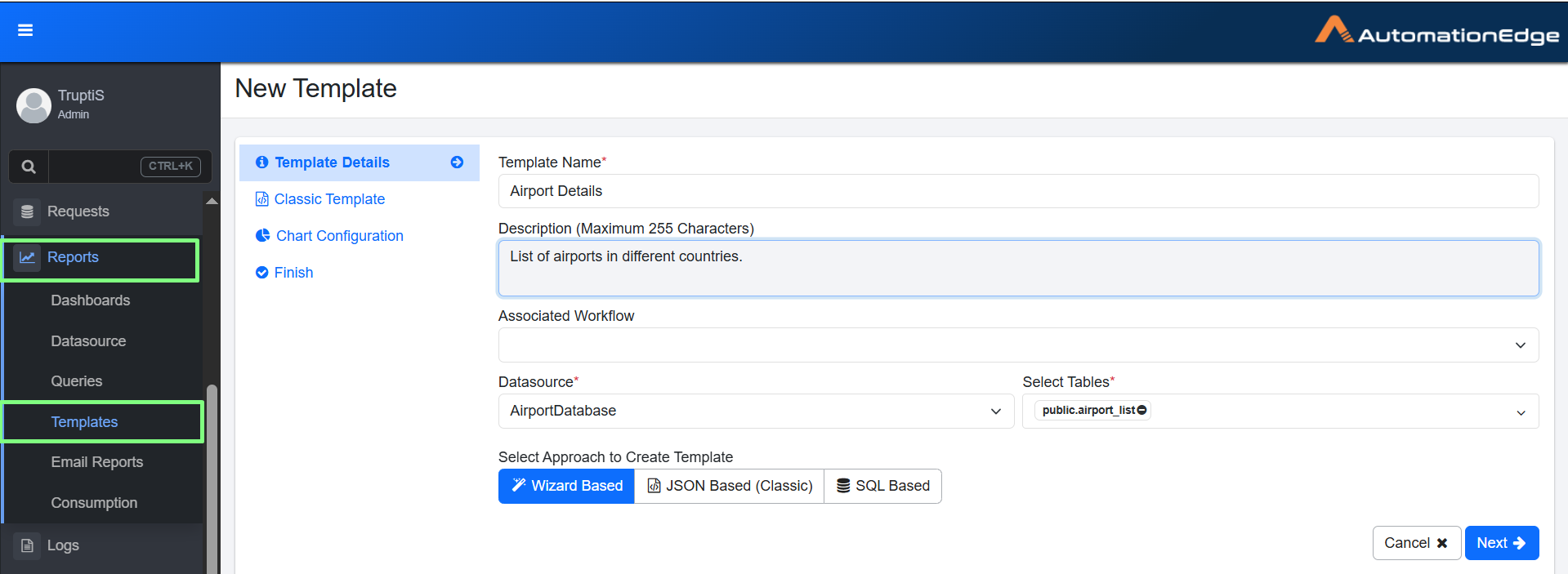

  2. Click New Template. The New Template page appears.
    reports
    New Template page
  3. In the Template Details section, enter the field details. The following options are available under Select Approach to Create Template after you select the tables in the Select Tables list:
    • Wizard Based
    • JSON Based (Classic)
    • SQL Based
  4. Click Wizard Based and then click Next. The Wizard Based menu appears in the left pane.
    reports
    Wizard Based template

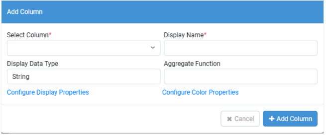

  5. In the Report Columns page, you can perform the following tasks, if required:
    • Click Add New, to add new columns.
    • Click Edit, to modify the column details.
    • Click Move, to sort the columns on the page.
    • Click Remove, to delete the column.
    For details about field details and tasks, see Create Flat Query template using SQL based approach.

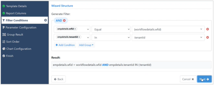

  6. Click Next. The Filter Conditions page appears.
    reports
    ▪ In the Filter Conditions page:
    o Click Add Group. From the list, select the grouping option, AND or OR.
    o Click Add Condition, and select the filter condition, the comparator, and the mapped column. The filter conditions are captured in the Result field.
  7. Click Next. The Parameter Configuration page appears.
    reports
    Enable Summary RowSelect the checkbox if you want the summary row in the report.
    Note: Only for structured query, a boolean value specifying if the summary row should be present for the report or not.
    Select Drill down ColumnSelect the column on which you want to drill down.
    Note: Only for structured query, if the report needs a feature where clicking on a row drills down further, the user must populate this field with the column's name to use for further grouping. This name must be present in projections.
    Note: For both SQL Based and Wizard based approaches, it specifies a list of parameter names for tenant IDs, for example, ["param1", "param2"].
    The AE engine identifies these parameters in the query. These parameters should be present in the query as :param1 and :param2.
    It substitutes these query parameters by run time values of the tenant ID of the user running the report. The parameter value in the query table should be numeric.
    Workflow Id Column NameSelect the workflow ID column name.
    Note: For structured query only, this parameter can be present only if workflowIdParamNames is not present. The parameter has the workflow ID column on which the engine adds a workflow ID filter.
    Date Column NameSelect the date column name.
    Note: Only for structured query, this parameter can be present only if startDateParameterNames and endDateParamNames are not present. The parameter has the name of the column on which the engine adds the date filter. The parameter value in the query table should be of type date.
    The AE engine identifies these parameters in the query. The parameters should be present in the query as :param1 and :param2. It substitutes these query parameters by the run time values of the user id running the report.
    If Tenant users execute a custom report with the userIdParamNames option, the user can see rows that contain his user id.

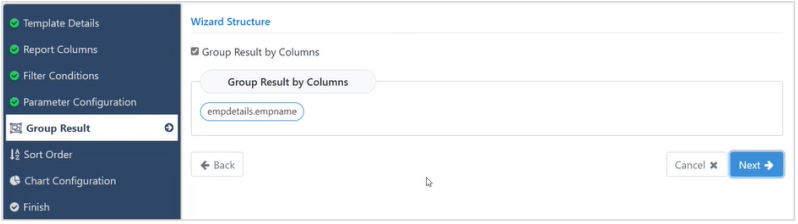

  8. Click Next. The Group Result page appears.
    reports
    Group Result page
  9. Select the Group Result by Columns checkbox. The group by columns appear in Group Result By Columns.
    Group by columns are selected based on report columns (projections) and aggregate functions used on the columns. Number of group by columns also depend on configured parameters. If the inner Query column name is configured, then group must have only one column, therefore, the user needs to remove some of the group by columns.
    To remove some of the group by columns, hover over the column, and then click Remove column that appears.

  13. Click Next. The Chart Configuration page appears.
    For Chart Configuration field details, see Create Classic template using JSON based approach.
  14. Click Next. The Finish page appears.
    For details about the three tabs, see Create Classic template using JSON based approach.
  15. Click Finish. The template appears in the Template page.
    The template appears in the Dashboard, which you can use to generate reports.
