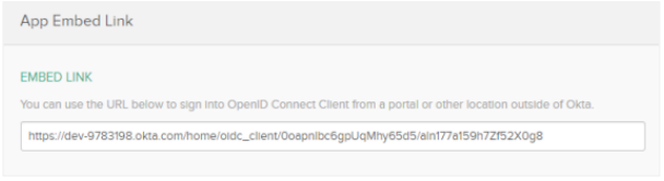

    At the end of the configuration, you will see an App Embed link. If you copy and paste this link in the browser, it will invoke IDP initiated SSO flow.

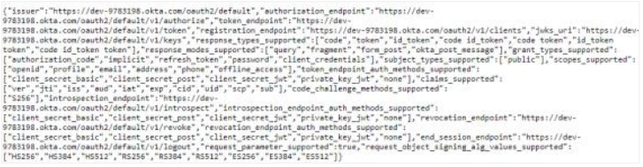

  4. Click the default link and open the Settings page. Click the Metadata URI link. The Metadata opens in XML format.
    Metadata
    Metadata URI in XML format

  1. You may import the contents of Metadata URI to set up Single Sign-On in AutomationEdge.

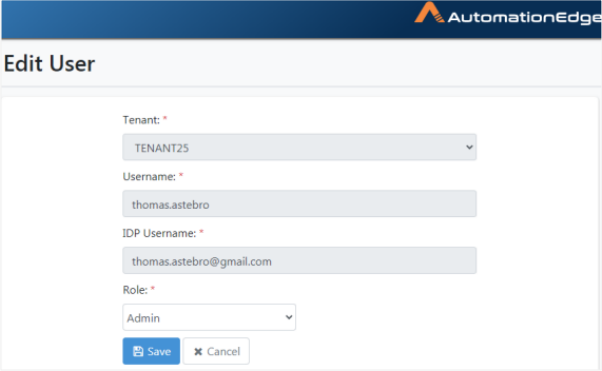

  2. Create an SSO user in AutomationEdge mapping it to an IDP user with permissions on the IDP application.
    Edit user
    SSO user mapped to IDP user
  3. In the Applications General tab, locate App Embed Link URL. Copy the URL.
    App embed link
    App Embed Link URL

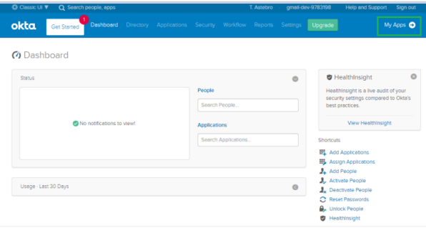

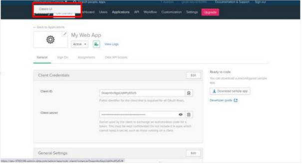

  4. Type the App Embed URL* in the browser. You are redirected to AutomationEdge with IDP initiated SSO. Or Switch to Okta Classic UI view.
    Web app
  5. In the Okta Class UI view, click My Apps. Your app appears on the page.
    Web app dashboard
    My Apps dashboard
  6. Click on your application, for example, My Web App.
    User created app
    User created Web App
  7. Click on the app. You will be taken to the AutomationEdge with IDP initiated SSO.
