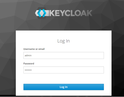

  1. Log on to the Keycloak Identity Provider portal.
    Keycloak logon
    Keycloak logon page

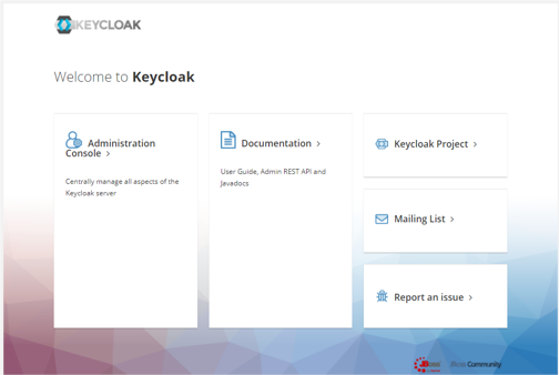

  2. On the Home page, click on Administration Console.
    Keycloak home page
    Keycloak home page

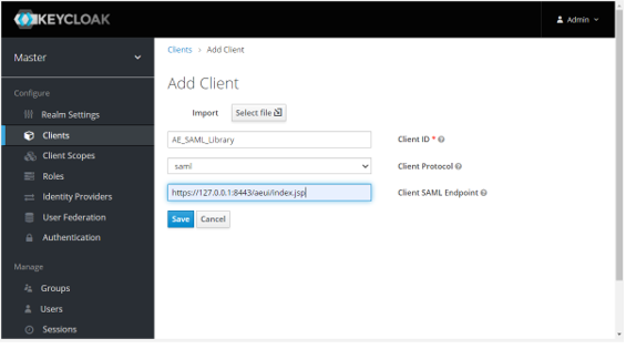

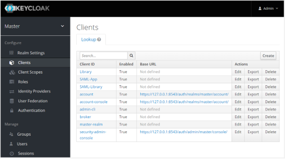

  4. Go to the Clients section and click Create.
    Keycloak clients
    Keycloak Clients page
  5. Enter the following details:
    1. Give a name to the Client - “AE_SAML_Library”.
    2. Select appropriate Client Protocol in this case SAML.
    3. Set Client SAML Endpoint (valid redirect URIs).

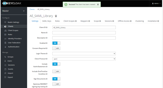

      Keycloak add clients
      Add Client with SAML protocol
    4. Click Save. Success! The Client has been created. message appears.
      Keycloak success message
      Client created successfully

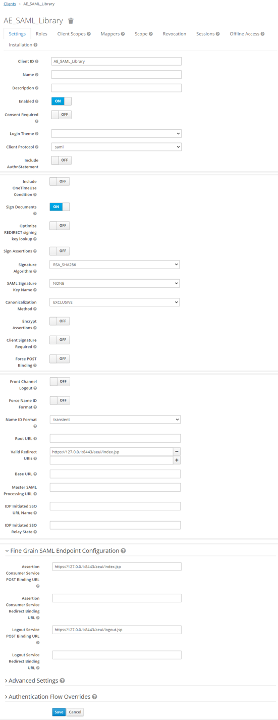

  6. On the page with more Settings, you may change the configurations, as required. Click Save.
    Keycloak SAML
    Keycloak SAML Settings
    Field NameValue
    EnabledOn
    Consent Requiredoff
    Login Theme
    Client ProtocolSaml
    Include AuthnStatementoff
    Include OneTimeUse Conditionoff
    Sign DocumentsOn
    Optimize REDIRECT signing key lookupoff
    Sign Assertionsoff
    Signature AlgorithmRSA-SHA256
    Saml Signature Key NameNone
    Canonicalization MethodEXCLUSIVE
    Encrypt Assertionsoff
    Client Signature Requiredoff
    Force POST Bindingoff
    Front Channel Logoutoff
    Force Name ID Formatoff
    Name Id Formattransient
    Root URL
    Valid Redirect URIshttp://(aeui-server)/aeui/index.jsp
    Base URL
    Master SAML Processing URL
    IDP Initiated SSO URL Name
    IDP Initiated SSO Relay State
    Assertion Consumer Servicehttps://Automationedge:port/aeui/index.jsp
    Logout Service Post Binding URLhttps://Automationedge:port/aeui/logout.jsp
    • Use the Valid Redirect URL after successful login to the IDP.
    • We are using post binding in our application. So the ‘Assertion Consumer Service’ and the ‘Logout service Post Binding URL’ should have valid URLs. Redirect URL and Assertion Consumer Service root URL should be the same.

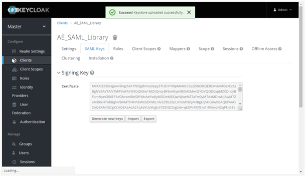

  7. Now go to the SAML Keys tab, and then click Import. The import SAML details page appears.
  8. Select Archive format at Certificate PEM from the list.
    To generate Self Signed or CA Certificate, see Keystore and Certificate Generation.
  9. Click Select file to browse your certificate file and then click Import. On import, the ‘Keystore uploaded successfully’ message appears, as follows:
    Certificate

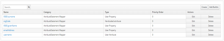

  10. Next, we will enable some built-in Protocol Mappers and create a new Protocol Mapper.
    In the Client menu, click the Mappers tab.

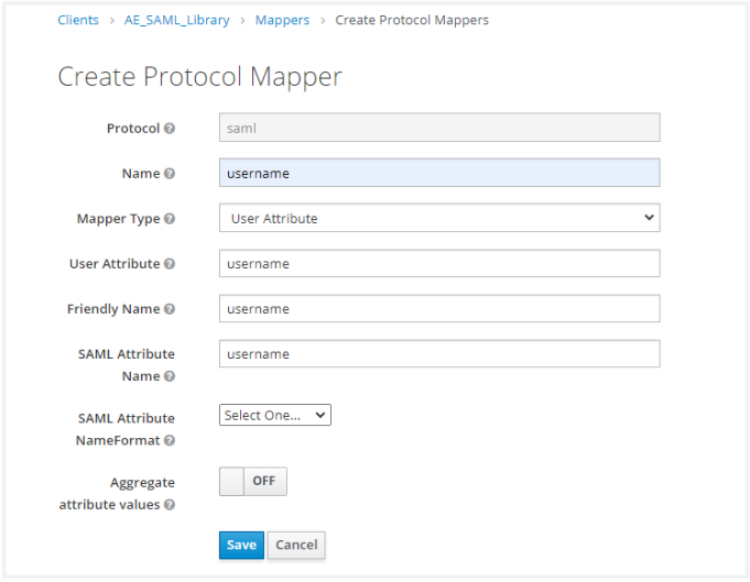

    In the same client setting section, move on to Mapper click on Add Builtin. Include the built-in email, givenName and surname by enabling the checkbox next to them. The selected built in protocol Mapper attributes are now available under the Mappers tab. We got the three attributes only left with the username attribute.
    Click Create to open the Create Protocol Mapper for creating the username claim. Set the Name, User Attribute, Friendly Name, SAML Attribute Name as username and Mapper Type to User Attribute. Next, click Save.
    Create Protocol Mapper for username
    SAML Attribute name for all mappings must match username, firstName, lastName, emailAddress.

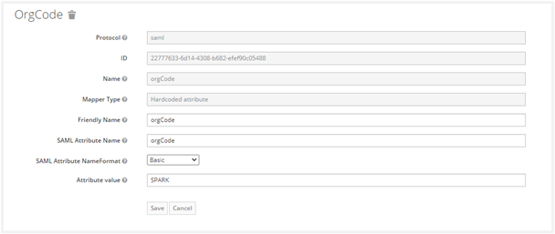

  11. Create a new hardcoded attribute mapping for orgCode as shown in the following screenshot:
    SAML
    Hardcoded attribute mapping for orgCode
    The Attribute value must be organization code of AE tenant. It creates the Client Protocol Mapper for username claim successfully.
    The Protocol Mappers (claims) for the Client is now as follows:
    Protocol
    Protocol Mappers for the Client

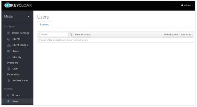

If the user is not in the realm, complete the following steps to view and add new users:
  1. Navigate to the Users menu in the left navigation pane.
  2. Click on View all users.
    Lookup
    Keycloak Users Lookup tab

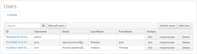

  3. Following is the current list of users:
    Add user
    Current list of users

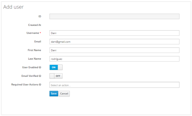

  4. Click Add User to create a new user and specify the First Name, Last Name and Email. Configure User details. Click Save.
    Add user
    Add user details
    Upon saving, it creates a user and generates an ID with a success message. To set user credentials, go to the Credentials tab and choose a password. Turn off the Reset Password- “Temporary” flag unless you want the user to change the password on the first login.

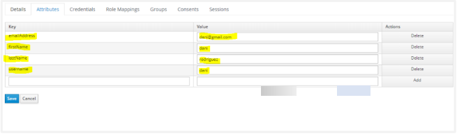

    Now we will set the Protocol Mapper user attributes provided in the table below for this user.
    KeyValue
    username{{username}}
    firstName{{firstname}}
    lastName{{lastname}}
    emailAddress{{email}}
    Click Attributes tab to add the following four attributes for the user. Provide the actual values in the Value field.
    Keycloak Param
    User Attributes configuration
    It is mandatory to specify actual values for the first three attributes: uniqueId, firstName, and lastName.

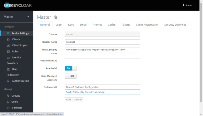

    In Keycloak, you can check for descriptor.xml in the realm setting as shown in the following screenshot:
    Keycloak

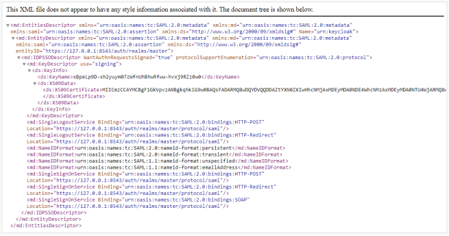

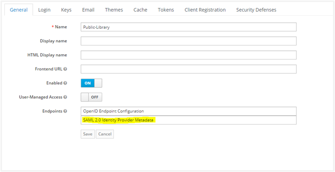

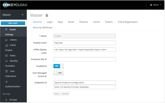

  5. Fetch parameters for AutomationEdge SSO Settings: Next, we wish to fetch the Client ID, Redirect URLs. Click on the Clients link in the left Navigation menu. Click on the Client link in the list (in this case, AE_SAML_Library). Get the Client ID.
    Get the Valid Redirect URLs by scrolling further down. Navigate to the Realm Settings. Click on SAML 2.0 Identity Provider Metadata.
    Keycloak Master
    SAML 2.0 Identity Provider Metadata in Realm Settings
    An XML file opens. Save the information in a descriptor.xml file.
    Keycloak XML
    Keycloak descriptor XML file

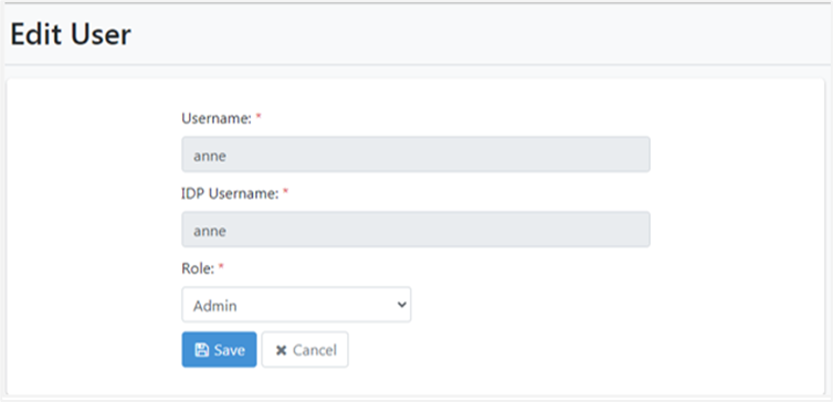

    Create an SSO user in AutomationEdge UI. Map the username to a unique IDP user.
    AESSO1
    SSO user mapped to IDP user

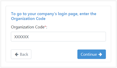

Now Sign in with the SSO link on AutomationEdge UI. Provide the Organization Code.
Org Code
Organization Code entry for SSO

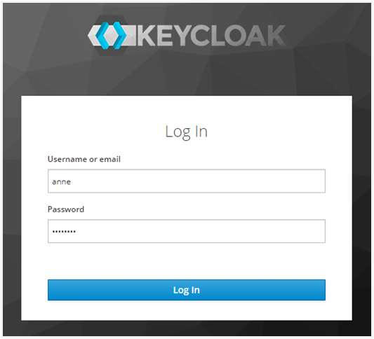

The first time you log in with SSO, it redirects you to the Keycloak login page (Make sure you log in with the correct user).
If you are already logged in with another user, you need to log out and log in with this user.
Keycloak 2
Keycloak login page for SSO
You logged in to AutomationEdge. Note that the user logged in is the same as the uniqueId of the IDP (Keycloak) user ‘tom’.
