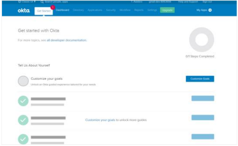

  1. Sign-in to Okta. The Getting Started page appears.
    Change the UI from Developer Console to Classic UI.

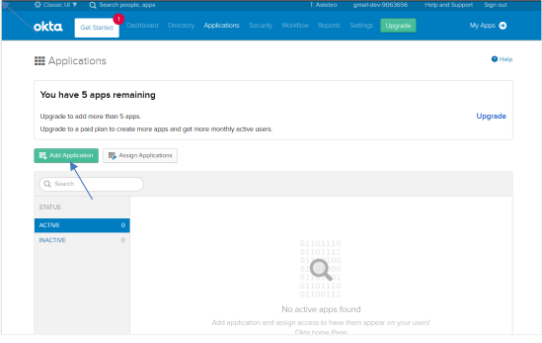

  2. Click the Applications tab, and then Applications. The Applications page appears.
    Applications dialog
    Okta Applications page
    Important
    For SAML, you must register an additional ACS URL for PS login: http://localhost:2611/callback.

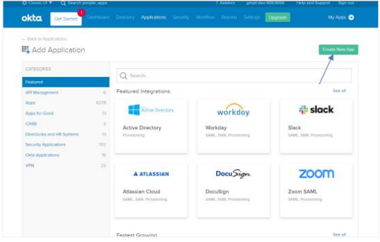

  3. On the page, click Add Application. The Add Application page appears.
    Create app
  4. Click Create New App. In the Create a New Application Integration dialog, select Web Platform and SAML 2.0.

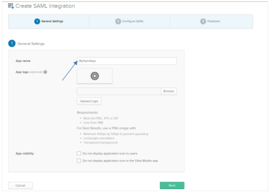

  5. Click Create. In the Create SAML Integration page, enter a name for the application you want to create, for example, MySamlApp.

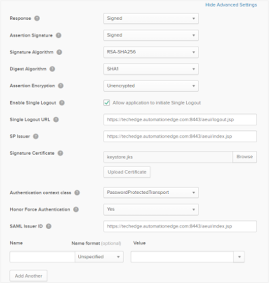

    3. Click Show Advanced Settings and enter the following details:
      Advanced details
      Advanced Settings
      • Response: Select Signed as it will sign the response after successful login.
      • Assertion Signature: Select as Signed. The signature algorithm is RSA-SHA256; we use the algorithm to sign the login request in the backend.
      • Digest Algorithm: Select as SHA1.
      • Assertion Encryption: Select as Unencrypted.
      • Enable Single Logout: Select the checkbox to allow the application to initiate single logout as well.
      • Single Logout URL: Enter the logout URL.
      • SP Issuer: Enter the same URL as the Single sign on URL.
      • Signature Certificate: As we are signing the Request Descriptor xml file we need a certificate for it. Browse and upload the certificate. To generate the certificate, see Keystore and Certificate Generation.
        Even the SAML Issuer ID provides the same value as the Single sign on URL.
      The following fields have the same values: • Single Sign on URL • Audience URL • SP issuer • SAML issuer ID

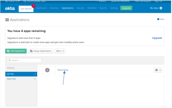

  1. On the Applications page, click MySamlApp. The configurations appear.
    Active application
    Active application on Applications page

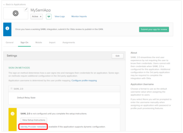

  2. On the application page, click Sign On tab. The Settings section appears.
    SAML app sign on
    SAML app Sign On settings

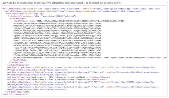

  3. Click Identity Provider metadata. The Metadata.xml file opens in a new tab.
    SAML metadata
    SAML metadata XML
    Right-click anywhere in the file and click Save As. Save the file as metadata.xml.
    Use the file as the Descriptor file when setting up AE SSO.

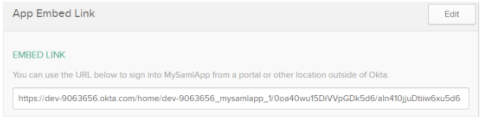

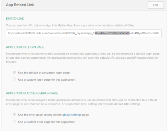

  1. Click the General tab. Scroll down to the App Embed Link section and get the Client ID.
    App embed link
    The Client ID is part of the Embed Link and is highlighted.
    SAML app
    Client ID highlighted in Embed Link
    Copy the Embed Link URL and paste in the browser. The IDP initiated SSO flow is invoked after completion of all the configurations.

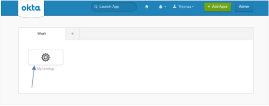

  2. On Okta Classic UI, click MyApps tab. MySamlApp appears on the page.
    As discussed in the next sections, you may click on the App for Single sign on to AE (redirects to the AEUI Home page) once all the settings are complete.

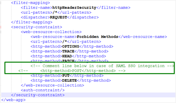

  1. Stop Tomcat server and then go to: /webapps\aeui\WEB-INF folder. For example, D:\AutomationEdge\tools\apache-tomcat-9.0.36\webapps\aeui\WEB-INF. The Web.xml file is available.
  2. Edit the xml file. Comment <http-method>POST</http-method>, which comes after
    Code
    Web.xml configuration for SAML SSO
  3. Restart the Tomcat server. The setups on the AE Tomcat server for SAML apps is complete.

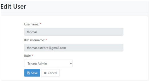

  2. Create an SSO user in AutomationEdge, mapping it to an IDP user with permissions on the IDP application.
    Edit user
    SSO user mapped to IDP user

  1. In the Applications General tab and then go to App Embed Link URL.
    App embed link
    App Embed Link URL
  2. Copy-paste or enter the URL from the Embed Link field in the browser. You are redirected to AutomationEdge with IDP initiated SSO.

    In Okta Classic UI, click My Apps. You can see your app in the list.
    Get started with Okta
    Okta Classic UI My Apps
    Click the application. You are redirected to AutomationEdge with IDP initiated SSO.
