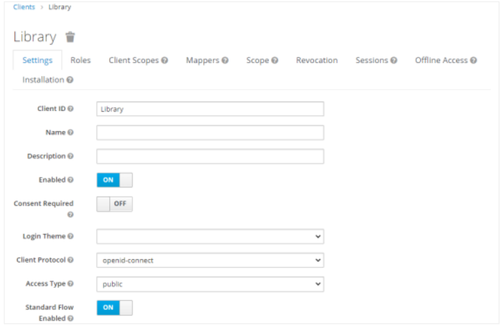

    1. Click Clients -> Clients page -> click Create. The Add Client page appears.
      Keycloak Add Client page
      Client ID*Enter a unique client ID. For example, Library.
      Client ProtocolSelect appropriate protocol and access type as public.
      Root URLSpecify a valid redirect URL. For example, https://Automationedge:{Port}/aeui.
      * indicates mandatory field.
    3. Click Save. The details are saved.
      In the Settings tab, you may keep the default values or change, as required.

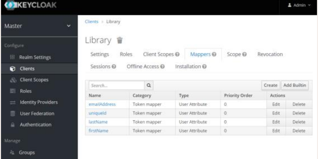

    4. Click the Mappers tab. The details page appears.
      Keycloak Client Library
      Keycloak Client Mappers tab
    5. Click Create. The Create Protocol Mapper page appears.
    6. Enter the following details to create claims:
      ProtocolDisplays the protocol you are using. For example, openid-connect.
      NameEnter a name of the claim. For example, uniqueId.
      Mapper TypeSelect the type of mapper from the list. For example, User Attribute.
      User AttributeEnter a name for the user attribute. For example, uniqueId.
      Token Claim NameEnter a token claim name. For example, uniqueId.
    7. Click Save. The mapper details are saved.
    8. Complete creating the following Mappers (Claims) for JWT (Access) token; to be used by Service Provider (in this case AutomationEdge).
      NameUser AttributeToken Claim Name
      uniqueIduniqueIduniqueId
      firstNamefirstNamefirstName
      lastNamelastNamelastName
      emailAddressemailAddressemailAddress
      UsernameUsernameUsername
      orgCodeorgCodeorgCode
    Create four mappers in the Client.

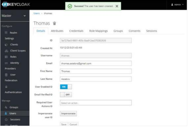

    1. Click Users -> Users page -> Lookup tab. The details page appears.
    2. Click Add user and enter the following details:
      • First Name
      • Last Name
      • Email
      To set user credentials, go to the Credentials tab and choose a password; we have used password for the rest of the article. Turn off the Temporary flag unless you want the user to change the password on the first login.
    3. Click Save. The user is created successfully.

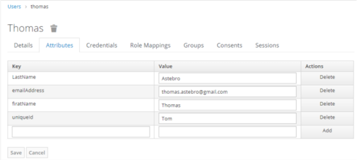

    4. Click the Attributes tab. The details page appears.
      Attributes
      User Attributes tab
    5. Enter the following details:
      KeyValue
      uniqueId{username}
      firstName{first-name}
      lastName{last name}
      emailAddress{email}
      username{username}
      orgCode{AE tenant org code}
      It is mandatory to specify actual values for the first three attributes: uniqueId, firstName, and lastName.

    i. Click Clients, and then click on the Library link. The Clients page appears.
    Client view
    Client view page

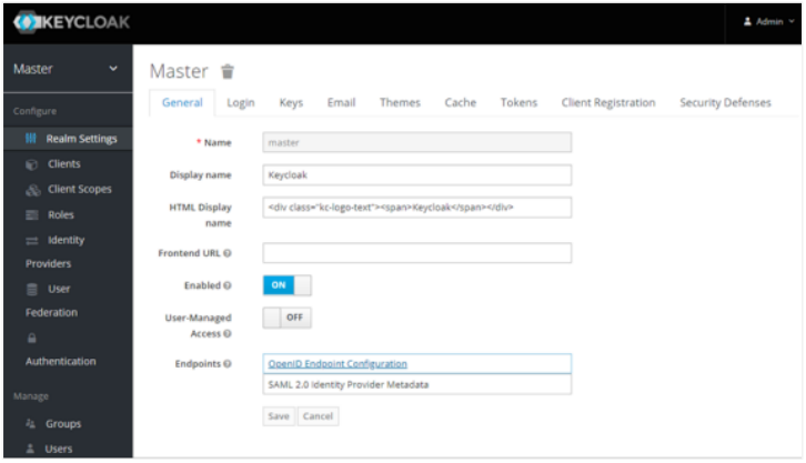

    ii. Fetch the Client ID and Valid Redirect URI and then go back to the Realm Settings menu.
    Keycloak General tab
    Keycloak General tab with Realm Settings

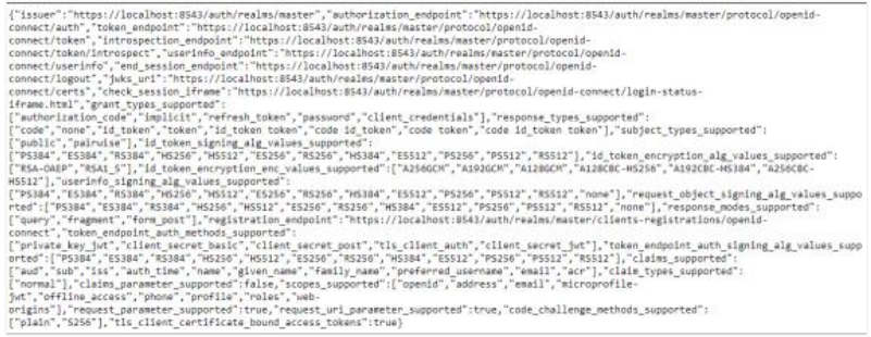

    iii. Fetch the Client ID and Valid Redirect URI and then go back to the Realm Settings menu. In the Endpoints field, click OpenID Connect Endpoint Configuration. You can fetch the authorization_endpoint key value and other Endpoints from the Endpoints JSON.
    JSON
    OpenID Connect Endpoints JSON
On AutomationEdge UI, you can now complete configurations under Settings → Single Sign-On; by entering the values or importing the endpoints authorization file.
