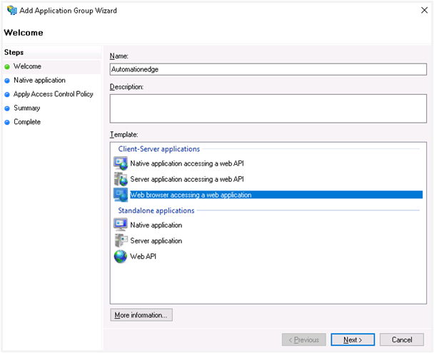

  2. Type a Name for a new Application Group. For example, Automationedge.
  3. Select Web browser accessing a web application as the Client-Server application template.
    Welcome tab
    Welcome tab

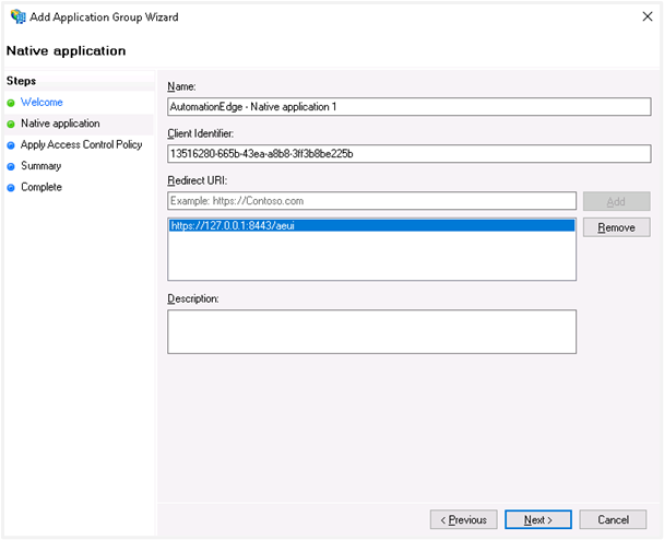

  4. The Add Application Group Wizard appears. The Welcome step automatically generates a new Client Identifier, which is used for Client ID in AutomationEdge SSO configuration.
    You may change the Client ID, if required.
    Copy the Client Identifier.
  5. In the Redirect URI section, add all the URLs for AutomationEdge as the client application. Click Next.
    Redirect URI
    Redirect URI configuration

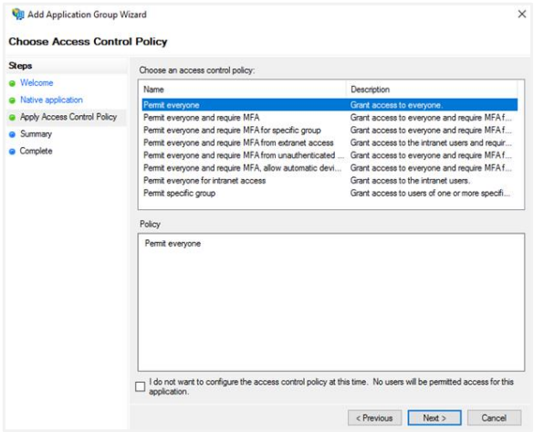

  6. Permit everyone is selected in the Apply Access Control policy step, but you may choose as needed. Click Next.
    Access Control Policy

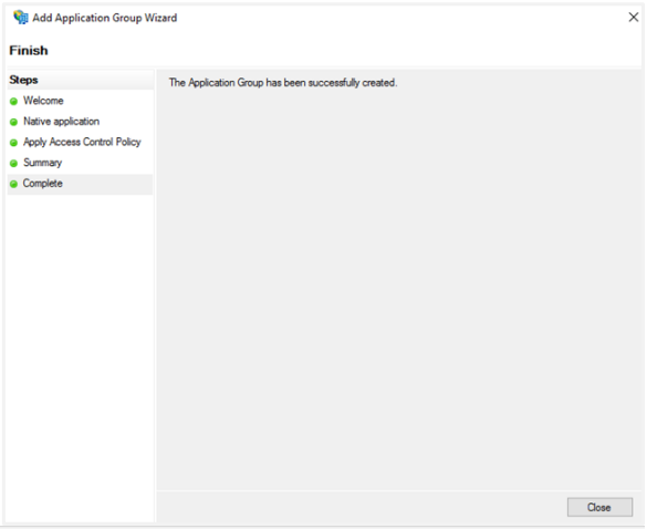

  7. Review settings in the Summary step and click Next. The Application Group has been successfully created message appears in the Complete step, and then click Close.
    Summary
    Summary step

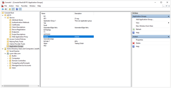

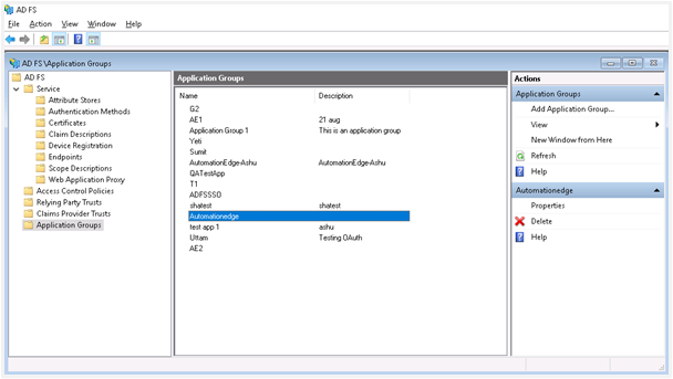

  8. You can now see the ADFS console. The new Application Group lists in the Application Groups interface.

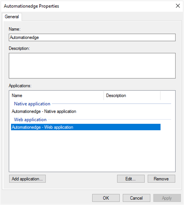

  9. Select the Application Group you want to configure and click on Properties.
    Open ID 4
    Application Group Properties
  10. The newly created Application Group’s Properties window opens. The Application Group wizard has created the two Applications for Client Application and Server.
  11. Now select the ‘Automationedge’ Web Application as follows for additional configurations. Click Edit.

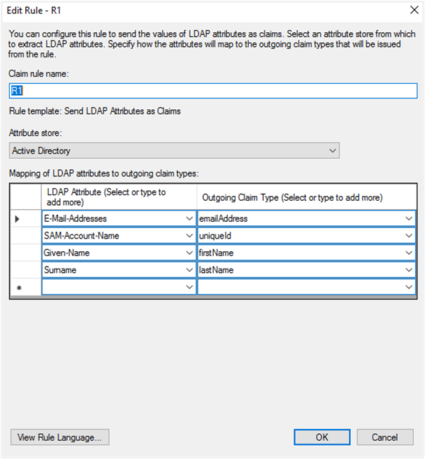

  13. Go to the Issuance Transform Rules tab, which is empty! Once you see the windows like in the snapshot below, click the Add Rule button. Select the ‘Send LDAP Attributes as Claims’ and add the LDAP Attributes as follows:
    LDAP AttributeOutgoing Claims
    E-Mail-AddressesemailAddress
    SAM-Account-NameuniqueId
    Given-NamefirstName
    SurnamelastName
    It is mandatory to map LDAP attributes to the three outgoing claim types: uniqueId, firstName, and lastName.
  14. Click Next.
    Open ID 6
    Issuance Transform Rules with LDAP Attributes

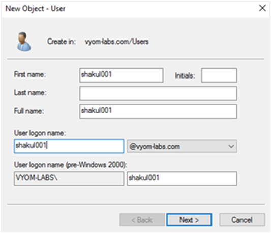

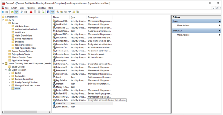

  17. Next, add a user to the ADFS server Active Directory. Following are the steps for Adding a new user to the ADFS server Active Directory.
    In the ADFS console click on Active Directory Users and Computer and navigate to Organization -> User -> New -> User.
    Open ID 7_1
    Active Directory Users and Computers navigation
    Provide details of the user to be created.
    Open ID 7
    New user details

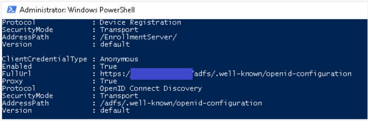

  18. After user creation, to fetch the Identity Provider Endpoints (Authorization, Token and End Session Endpoints) in ADFS, complete the following steps:
  1. Open Windows Power Shell and type the command: Get-AdfsEndpoint
  2. Search for OpenID Connect Discovery.
    Open ID 8
    OpenID Connect Discovery endpoint in PowerShell

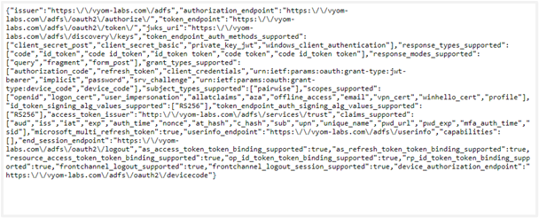

  3. Copy the Full URL (e.g. https://xxxxx.com/adfs/.well-known/OpenID Connect-configuration)
  4. Open the URL to get the Endpoints text in JSON format, as seen in the following image:
    Open ID 8
    Endpoints JSON format
