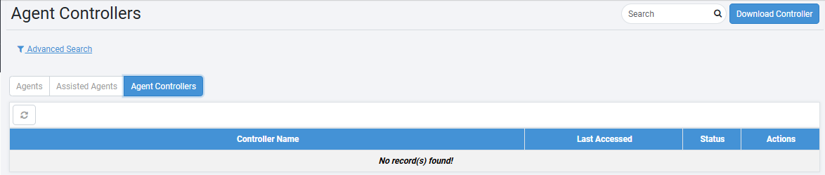

  2. On the page, click Agent Controllers tab. The Agent Controllers page appears.
    Dialog

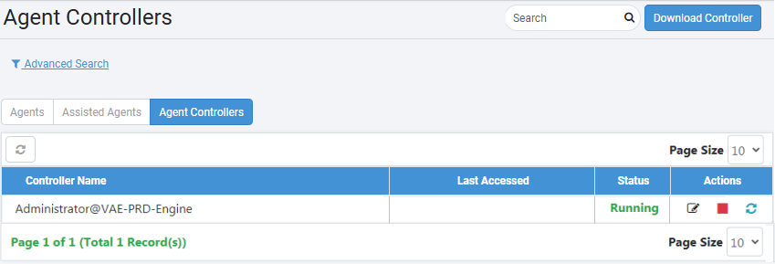

To start the Agent Controller:
Run startup.bat from ae_agent/bin directory. The Agent Controller starts.
Dialog
Agent Controller started

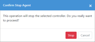

  1. In the Actions column, click Dialog. The Controller Stop Agent dialog appears.
    Dialog

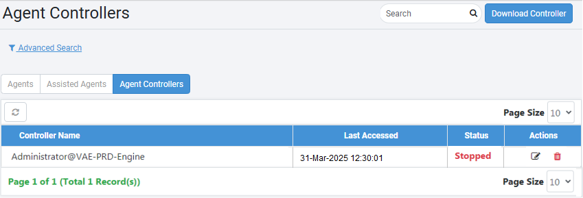

  2. Click Stop. The Controller stops and the status changes to Stopped.
    Dialog
    Controller stopped view
To delete the Controller, click Dialog, and then click Delete in the Confirm delete dialog. The Controller is deleted.

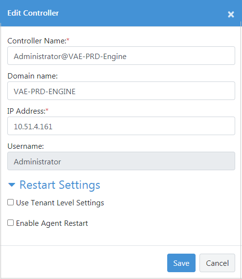

To edit the Agent Controller details:
  1. In the Actions column, click Dialog next to the Controller whose details you want to modify. The Edit Controller dialog appears.
    Dialog
  2. In the dialog, edit the Agent Controller Agent Name, Domain name, or IP Address, as required, and then click Save. The modified details are saved.

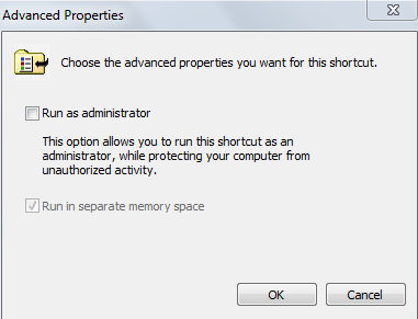

Assign Administrator privileges for running workflows​
If a workflow running on an Agent machine needs administrator access, run the Agent as administrator.
To run agent as Administrator:

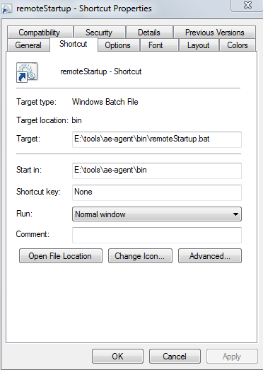

  1. Right click on the remoteStartup.bat shortcut, and then click Properties. The remoteStartup - Shortcut Properties window appears.
    Dialog Dialog
    Shortcut Properties and Advanced Properties
  2. In the Shortcut tab, click Advanced. Advanced Properties details appear.
  3. Select the Run as administrator checkbox. The shortcut can be run as an administrator.
    Dialog

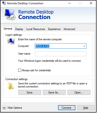

On Controller Machine​
On the Remote Desktop Connection window, clear the Always ask for credentials checkbox.
Dialog
Remote Desktop Connection settings

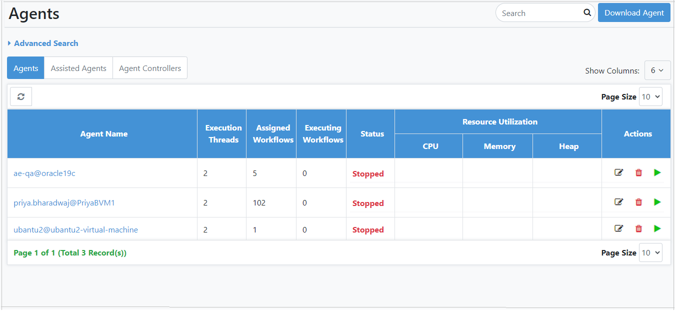

  2. On the page, click Download Agent to download the agent. For details on how to download agents, see Download and start an agent.
  3. Start the agent on your machine or Virtual Machine. The agent appears with the status Running in the agent list on the Agents page.

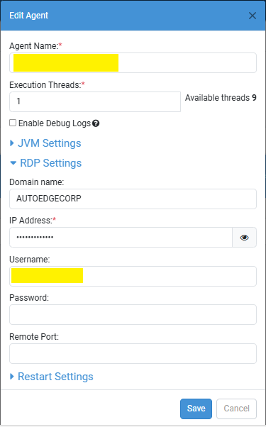

    For taking RDP and starting the Agent on the Controller machine, you need to edit the Agent and provide Agent machine credentials.
  4. In the Actions column, click Dialog. The Edit Agent dialog appears.
  5. In the RDP Settings section, enter the remote machine password for the user, and then click Save. The details are saved.
    Dialog
    Edit Agent - RDP Settings
